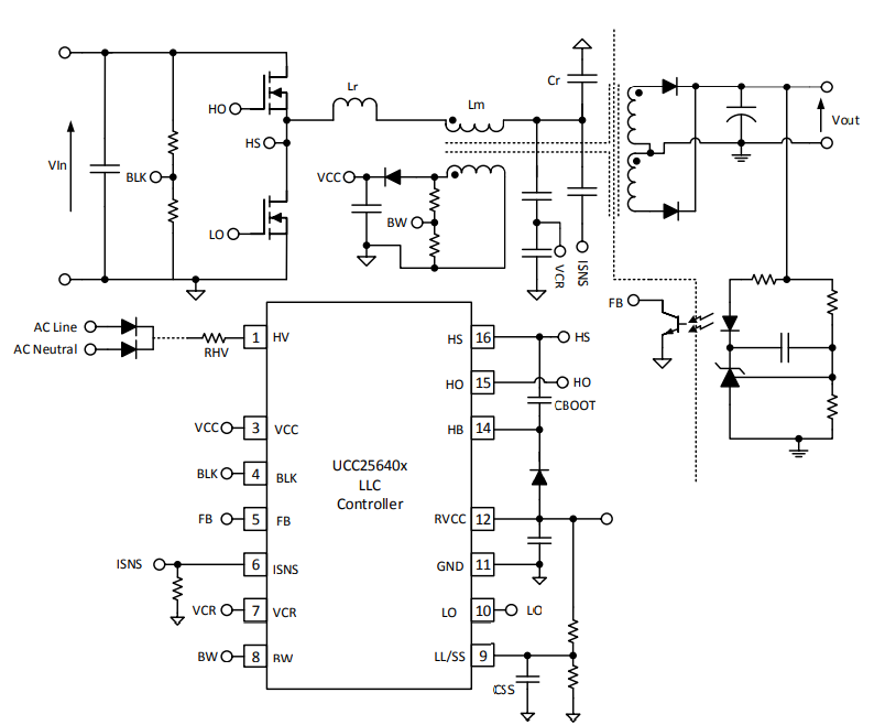

How about using a chip designed for that?, the TL494 is a 1980's switch-mode PSU chip.
Can you please give me a example? I searched alot but i not found anything. Also i make a thread about it. No one reccomended me something. Thanks
What kind of a power supply are you building? input voltage, output voltage, power, isolated?

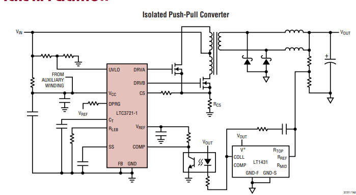

The LTC3721 is also old but at least it is designed to drive power MOSFETs not transistors.
The recommended output transistor current of the TL494 is only 200mA. That may not be enough to drive sufficient gate current for rapid switching of big IGBTs to avoid significant heating.

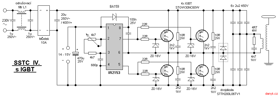

Thanks anyone for help. NCP1396A is in our country quite costly, about 10$. Tl494 i bought cost me about 0.5$ but additional driver chip another 2.5$.
But i realized that danyk solution ( diodegonewild etc. He has a lot channels on YT) could work with adjusted capacitence. One pair of Caps ( 2x 1u) limits power to 317W (230V AC / 3khz).
*UPDATE
Actually when one transistor is open second capacitor is charging through load / second cap. Power should be higher than.
I needed variable duty cycle and frequency.
I think the IR2153 is not good for duty cycle and frequency. It does not have a error amp.
It is a NE555 and a half bridge gate driver.
It should work well for a unregulated high voltage power supply.
