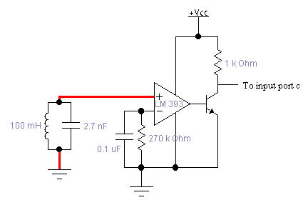

the other question (look my attachment if u've forgotten the circuit):
I'm doing a robot mower, i've tested the navigation system, it works well. When it goes to the multiple loops of wire (cat5), from the output of the 555, it will detect the electromagnetic field and turns to other direction.
Without running the blades (powered by 2 DC motors), it works well. I didn't connect them to the supply because i thought that it is just blades, nothing more, and it is quite noisy when running, so i test the operation without turn it on.
But when the time i try to turn on them, maybe because of the electromagnetic field produced by the DC motor, the LM393 circuit keeps response to it. Maybe is interference. The wires placed quite near.
Can i use the alluminium foil to cover the wires from the tank circuit to avoid the interference (red color from the diagram)? Then one end of the foil connected to GND. Is that called shielding interference?

You need to keep the motors away from the detector coil.
If the motors are permanent magnet ones with brushes, then the brushes make sparks which transmits interference. A 0.1uF ceramic disc capacitor with very short wires across the motor will help reduce the interference.
The supply also needs a 0.1uF ceramic disc capacitor across it.
But their place are fixed..
the capacitor with short wire connect with the motor in parallel? What about the supply?

Since the detector coil picks up the magnetic field from the motors then your project doesn't work. Can you mount the detector coil out on a stick in front of the robot?
Yes.
Connect a 0.1uF ceramic disc capacitor at the supply pins of the LM393.
Can you mount the detector coil out on a stick in front of the robot.
The tank circuit is already sticked in front of it, but still affected, i'm worried that, the wire connected from the tank to the input of the 393 will pick up the field.
one end to the +ve and the other end to the -ve? means that in parallel?
*Can i shield the wires or shield the motors with the alluminium foil to avoid the interference as i mentioned before?
Connect the metal covers on the motors to 0V with a wire.
Use shielded cable like is used to connect stereo components together (cut off the RCA connectors) to connect to the tank.
Yes.. Thanks.. The metal body of the motor won't cause any short circuit if connected to GND, will it?
Then do i still need to include the bypass capacitor?
What is shielded cable? How to get it? Can i make it myself? What is the RCA connector?

I've shielded the wires and the motor. I've tested using batteries which are fully charge and not fully charged (not full). When i use the lower power, my robot mower operates well, no interference. When i use the fully charged batteries, of course, the motor run faster and interference occurs.
The motor should run as fast as possible for good mowing system, but the electromagnetic field produced by the motor is bigger.
Can i shield the wires and the motor thicker (turn more round) to solve this? I use alluminium foil (for cooking) to shield them.
Shielded cable or aluminum foil will stop the sparking of the motors from radiating electrical interference. But will do nothing for the magnetic interference.
What should i do besides moving them far away to each other?
Is there anything to remove or direct the unwanted electromagnetic field to somewhere else?

I guess using a coil for a sensor is not the correct thing to do in a machine that is powered by electric motors.
Hee, hee. Diesel engines? Hee, hee.
Oh no... you're kidding right? I mean the diesel engines.. haha.. i use only AA's.. I'll try to solve it..
Anyway, you've helped me a lot, thank you very much.
