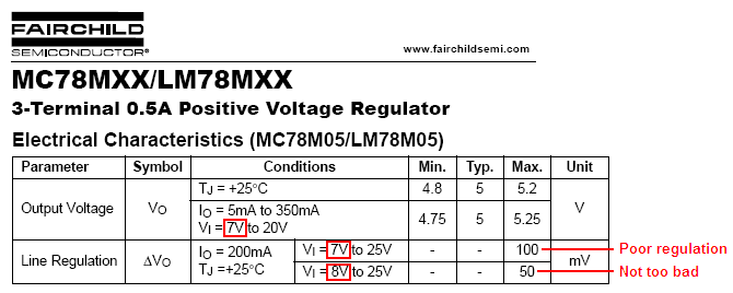

Then we don't know if it still regulates the voltage when the battery voltage runs down. You could measure its output voltage when it is powered by a used battery.
bananasiong said:
I think it is a 78M05CT
Look at its datasheet!
It is the same as a 7805 except its max current is only 500mA.
It is guaranteed to regulate very well when its input voltage is 8V or more.
It is shown to regulate poorly when its input voltage is 7V or less.
Your 9V disposable battery voltage will quickly drop to about 7.2V then slowly continue dropping more as it runs down. A 9v rechargable battery voltage is only 7.2V.

The 78M05 regulator won't be regulating with 4.8V to 6.0V as its input.

Where do u find from the datasheet that "the regulator won't be regulating with 4.8V to 6.0V as its input"? I found 4.8 and 5.2? It stops regulating 7.2v and lower.

When you operate ICs at their limit, different manufacturers have different specs.
Fairchild shows that with an input of 7V or less, their 78M05 regulates poorly. With an input of 8V or more the regulation is much better.
These are minimum spec's. Each IC is different and maybe your IC is better than the minimum.

Wow.. so many brand.. i know the 7V to 20V, if input supply is between these range, the output will be fine, right?
What about the Line Regulation? 7V to 25V---100mV---poor, 8V to 25V---50mV---not bad, what are they??
*And.. if i use 5v supply, then the LM393 circuit doesn't need to be connected to the output of the regulator, just simply parallel it with the microcontroller, right? Thanks :)
Line regulation is how much the output voltage changes when the input voltage is changed. It is a regulator and its output shouldn't change much. When the input changes from 7V to 25V then the output changes 100mV max which is poor. When the input changes from 8V to 25V then the output voltage changes only 50mV max which is better.
