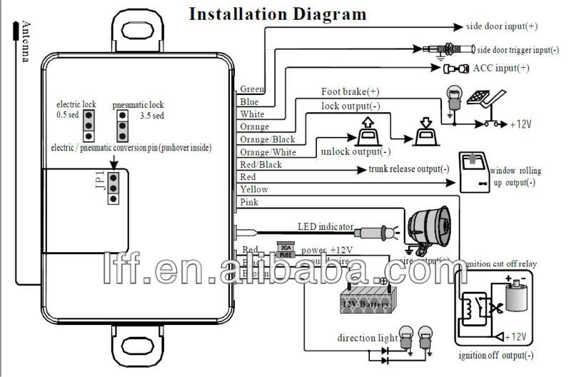

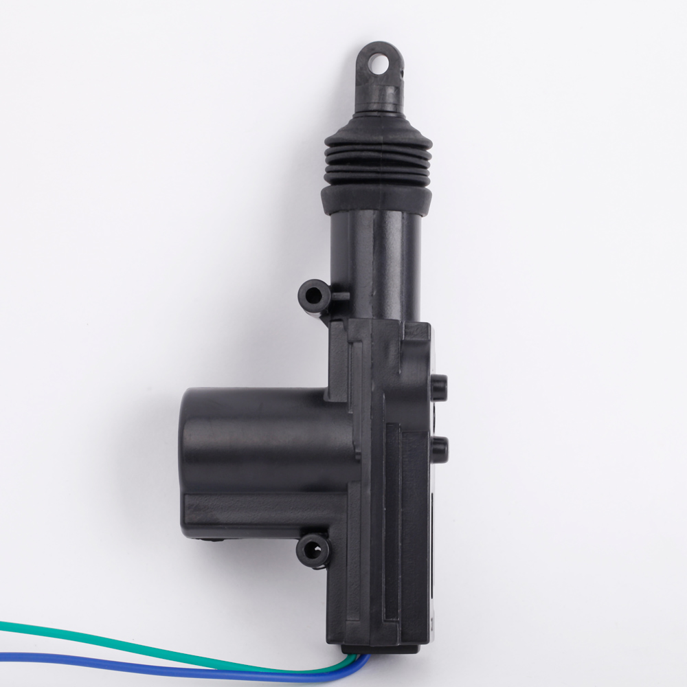

Hi, I have purchase a alarm system for my Nissan b14, all is working properly except the central locking, I have install a new actuator 2 wire( green and blue, I have wired orange/ black from the alarm to the actuator green wire and connect orange/white to blue wire from the actuator, but it is not working. How can I get the actuator work and I have attach the wiring diagram of the module
Please help me,

Looking at the installation diagram for the alarm, I don't see any suggestion that it reverses polarity to the actuator. Both outputs for the actuator(s) are marked "Output(-)". My guess (I could be wrong) is that each output is an open-collector or open-drain type which pulls the output to ground when active. Are you sure the alarm and actuator are compatible?
I think that the alarm module is designed to work with an existing central locking module that the vehicle already has. The negative going output simply emulate the central locking buttons already mounted in the vehicle.

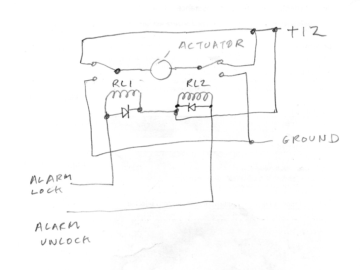

I think you will probably need to use two relays (Or an H bridge circuit.) to interface the alarm with the actuator you have. I am thinking like the diagram below.
You will need to check that the lock outputs switch to ground and that the current rating is enough to drive the relays that you use. You will also need to check if the signals stays active or go inactive after a short time. If they stay active you will need to add a delay circut between the lock output and the relays so the relays are only activated for a few seconds. If you do not do that the relay current will discahrge the battery over time. It should not cause a problem with the actuator as this will probably have limit switches. It will also be a good idea to put a snubber circuit across the actuator connections. I would suggest about a 470 nF capacitor in series with a 10 ohm resistor.

Les is one the right track. The lock and unlock outputs look like there negative going or a contact to ground. Just how much current that supports would be defined in the module.
If the car already has power locks, then you might wire things differently, There is a way to typically "wire or" using diodes to make both the existing and the alarm lock work. Wire or-ing may not be necessary.

That relay is fine, but the connector makes life easier. You will need a minimum of two relays.

Can you confirm that the lock actuators you have have built in limit switches ?

To confirm that the actuator has limit switches built in connect it to a 12 volt DC supply (EG a car battery.) via an ammeter. If the actuator moves there will be a reading on the ammeter while it is moving. When it stops the current will either drop to zero or increase. If it increases disconnect it straight away. Reverse the polarity of the actuator wires and repeat the test. The actuator should move this time. Again note if the current drops to zero or increases when it reaches the end of it's travel.

99% sure those actuators have no limit switch. It's just a motor running a rack. A Stall for a short time is generally OK. It also means that the usual mechanical way of locking the car works too. It should not be an issue.

The diagram seems to suggests you have a choice of 0.5 s or 3.5 depending on the position of the internal JP1 jumper.

Les showed a diode across the coil of each of the relays. This should be a 200 V PRV diode or greater. A 1n4003 or bigger would work. https://www.onsemi.com/pub_link/Collateral/1N4001-D.PDF The diodes are designed not to conduct in normal operation and to absorb the spike when the motor is turned off.
As you can see, the lock/unlock system is initially is totally independent of the alarm system. It just has to operate with a contact closure to ground for lock and unlock.
