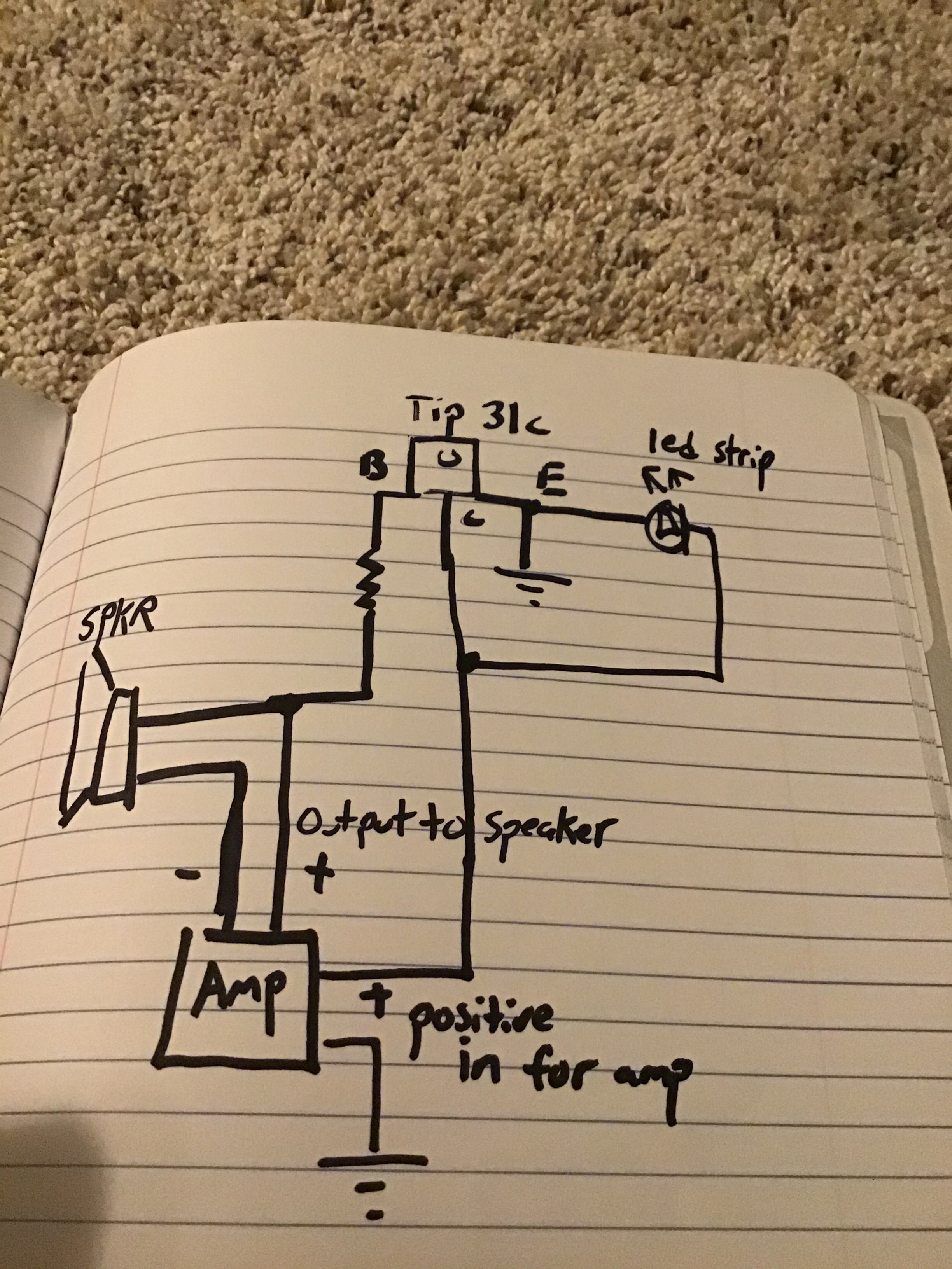

Here's a two foot speaker box I made Its got midrange on the sides Sub on the front and the two tweeters on top. Im using A boat stereo amp to power it Later I would like to make It battery powered with a recharge port, but It takes up a lot of Amps right now. It also has Led strips next to the sub to be in sync with the music, but I haven't figured out a way of using a transistor switch to work them yet without shorting the amp.

A transistor switch does not short anything. It is simply located in series between the battery and the LEDs and connects the battery to the LEDs when sounds turn it on.
I know it’s not the best design, I was just going for fast and somewhat efficient. I’ll send you the diagram of what I did for the led light thing and maybe you can see what went wrong.
448FD764-D147-40B7-9894-A42CEFC01A10.jpeg Here is what I did and it shorted. I was thinking of doing a mic design, but it wouldn’t be very effective when the volume was down
Yes, you have the collector of the transistor at the + of the battery and its emitter connected to the ground side of the battery. Then when the transistor turns on it shorts the battery.
The transistor will provide about 11V to the LED strips when the amplifier output is maximum then when the volume is turned down only a little less than maximum, the LEDs will be VERY dim or not produce any light.
You have the transistor as a linear emitter-follower instead of as an on-off switch that can be very sensitive.
Since you want the LED strips to light in sync with the music then you should use a low frequencies-only filter so that the LEDs only light for bass beats and drum beats.
thank you! I thought for sure I had it right. can you describe how the circuit should look? I‘m still trying to learn how to use npn and pnp transistors as switches. From what I gathered I thought (for an npn transistor the base has the positive input voltage that triggers the Emiter negative to flow to the positive collector. Please correct me if I’m wrong.
If I place the Led between the Collector and The positive 12 from the amp, and the emitter connected to grd would that work?
Yes, then the transistor will be a switch and will turn on fully and light the Leds whenever current flows in the series base resistor. But as I said earlier, the transistor will turn on only when the music level is exactly at the correct voltage (the loudest peaks), or the LEDs will be on all the time or off most of the time.
