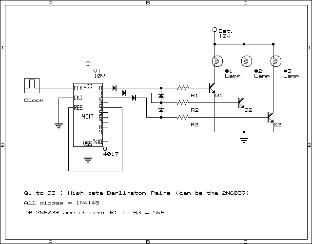

I'm trying to build a circuit that will sequence the three 12v turn signal tail light bulbs (just like the old Cougars) for my 2000 Mustang. Any and all ideas are welcome and appreciated. Thanks, Mike

I think the cougar had three vertical lights on left and right, that lit inside first, 300msec (some delay) then lit the next one (middle), leaving the inside one on, then 300msec later lit the last one (so all are on).. Then all off, delay and repeat. Sort of like shampoo.. And they might have had more than 3 lights.

You could also use a binary count of 0, 1, 3, 7 then repeat. this gives:
000
001
011
111
restart
Use the outputs of the counter to drive FET's and you are all set. Get the clock frequency right and the sequence will happen at the right speed. Gate the outputs so they blank after reaching 7, but keep counting to 15 then reset. Since the clock rate is fixed, getting to 15 will take twice the time as 7, so half the time the outputs will be off, giving the full off time between cycles.
You could do this with a 4029 counter, a 555 for clock ( or an inverter 40106 ) and maybe a 4070 xor to gate the outputs when counting from 8-15.
Hey guys, I really am a novice. Best I can do is build the thing from a diagram. Mramos1 is correct on how the circuit functions. Will the circuit zevon8 describes accomplish it and any chance someone might draw it for me? Mike

Like this?
You just need to modificate the circuit #2 I've drew that post.
I'll assume you know how to make a 555 work in astable mode:
Thanks Hayato, I didn't have time to draw it earlier, and yes a Johnson counter would be better.
