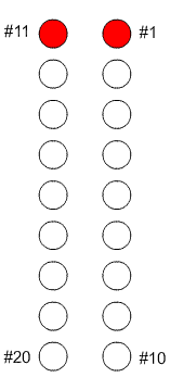

What I would like to do is have my garden path lights coming on only at night, which is not a problem. the bit i need help with is as follows.
There are 20 lights (12v 4W) which I would like to latch on two at a time, 1 and 11 then 2 and 12........ up to 10 and 20. Stay on for 5 minutes then reset waiting to be activated again.

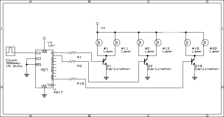

No problem on that. Just hook the lamps in parallel, 2 by 2.
Take a look at the attached image.

You're right, the centerline lights emulate a ball of light, traveling at high speed. If this is the case, a couple of 555s and a CD4017 seems to me like the simplest solution.

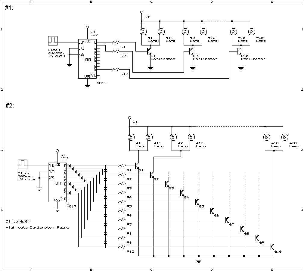

Henners, which one is the most similar to your idea? #1 or #2?
#1:
#2:
Great visual! The #2 was what I thought we were talking about. But to get it with a 4017, you would need flip-flops or something for latching on. My preference is to keep part counts low, IC mainly. Etching and drilling a PCB is so much easier that way. One of these days I'll get around to building a jig for the drill press for doing ICs easier.

Well,
I think these crazy circuits are going to work.
The #1 circuit is gonna work like the last post #1 gif;
The #2 circuit is special, it can work 2 ways:
1 - It's gonna work like the last post #2 gif
2 - Depending on 4017's VDD, it will simulate a ball of light travelling, like Ron said. Thank to the diodes voltage loss.
According to the datasheet, the IC's Voh (Voltage at high output) is Vdd - 0.5, so each darlington pair needs about 1.2V (or higher) to saturate, each diode the voltage decay about 0.7V, if you are able to manipulate the the IC's Vdd or the Voh's, you are able to accomplish.

My (revised) idea is to have 1+20 come on, about 0.5 Secs later 2+19 also come on then 3+ 18 and so on until they are all lit. Stay on for 5 mins then all turn off.
The idea is for the path to light up at your feet then carry on lighting into the distance. If i had gone with my first idea (1+11, 2+12 etc) you would have had to be at the right end or the lights would come on from the distance running up to your feet, or design it to run in reverse order when initialised from each end
As the path meanders through native bush no one will see it running from each end to the middle
