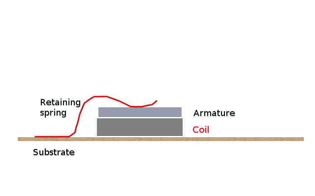

Just a thought here, instead of using a solenoid, why not build little linear induction motors? You can use approximately the same parts as a solenoid except the coil is driven by AC, so if you have a sufficiently high frequency the impedance comes into play so less current is needed. The moving part is made of a non-ferrous metal like aluminium so it's lighter, and de-gaussing is no longer an issue because there's nothing to retain the magnetism. You'd probably still need a ferrous core for the coil though - maybe a little ferrite bead of the sort you thread onto wires?
You just have to be prepared to drive your coils with AC instead of DC. At a wild guess I'd try driving it in the low audio range.
See illustration.
@throbscottle: that is a good idea, however would you have to have the retaining spring? could you let gravity drop it back down?

The spring is just on the drawing as a means of holding the parts together, just do whatever you think - the return mechanism of the valve could do the same job. Without something to stop it though the disc could fly right off the coil.
You would need some kind of driver since you would not be able to get AC out of any kind of normal logic chip,
As to relative power, I have no idea, but I do know that induction motors are more efficient and powerful than the sort that has a commutator, but that doesn't mean the same rule will apply for such a simple arrangement as this, since I believe the efficiency gain in motors is due to the lack of switching.
