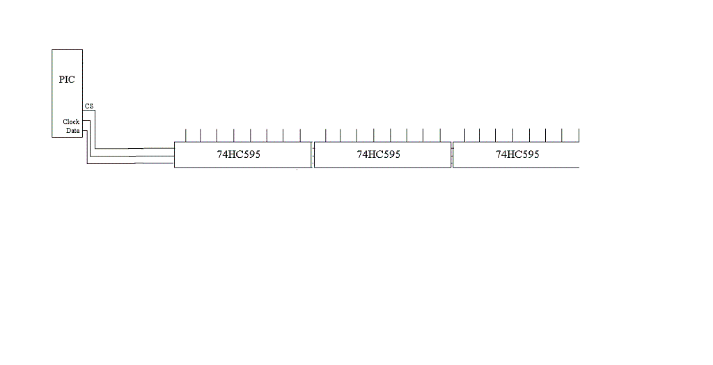

Hello this is my first post on this forum, I have a question and I have a diagram which I will let explain my problem (assuming you know somewhat about multiplexing)
Is there any way around not having to have 9 Control Signals?
I'm using a parallel port, so as few pins as possible is better.
Also I should note that this is a very tiny version of what I am trying to do, my actual full idea is the same but with a grid of 128x128 or bigger.
Also each little dot in the grid is a motor.
thanks :)
You can have any number of outputs using a serial approach.
Shown in the image below.
By the way, 128 by 128 is a lot of motors.
yes :) that is allot of motors, i'm actually thinking now to use solenoids
but for each of the 74HC595 wouldn't you need 3 control signals?
The data out(pin 9) from the first 74HCT595 would go to the data in(pin 14) of the next 74HCT595.
The Clock would go to pin 11 of every 74HCT595.
The CS/Load would go to pin 12 of every 74HCT595.
With the 3 control wires mentioned above you can output as many lines as you want.

And so on until all positions have been filled.
Then a pulse is sent to the Load(pin 12). This latches the information to the output lines, which will stay on the output lines until the next Load pulse.

The computer will need to determine which lines to activate in the matrix.
Example
A 128 line matrix(64 x 64). The first 64 lines will be colums and the next 64 lines are rows.
Solenoid 14 bottom row needs activation.
The computer(uC) puts a high on the data pin, the computer(uC) pulses the clock line 13 times.
The uC puts a low on the data pins and sends 1 clock pulse.
The uC puts a high on the data and sends out 50 more clock pulses.
This completes the column information.
The uC puts a high on data and sends 1 clock pulse for the bottom row.
The uC puts a low on data and sends 63 clock pulses.
This completes the row information.
The uC sends a load pulse which latches the information to the matrix lines.

2^6=64, so you only need 6 wires plus ground (parallel).
If you do serial, then 2 wires plus ground.

@beerbelly: first off thanks for your patience and helping me with this :) So basically you can load up 1's and 0's in the first 74HTC595 and when you latch it, the 1's and 0's go to the next 74HTC595, and the CS is basically a gate, restraining the data from being latched. Correct?
The 1s and 0s go into the data input of the first 74HCT595, out the serial output of the first 74HCT595 and into the data input of the second 74HCT595 and so on. It will take 256 clock pulses to fill all 32 74HCT595's. When all all the 74HCT595's are filled a single Load pulse is sent,this puts the 1s and 0s which are now stored in the 74HCT595s onto the matrix lines all at once. The matrix lines will continue showing these 1s and 0s until 256 more data are clocked in and another single load pulse puts something different onto the matrix lines.

Another thing you need to look at, is how much current your solenoids will take. The CD74HC595 outputs are rated to source/sink 35mA. As long as the solenoids need less than that, you should be able to drive them directly. If they need more current, you will need some buffer transistors. Make sure though, that you put protection diodes across each coil.
Did you notice that Tayda Electronics is located in Bangkok, Thailand. You list USA as home in your profile. Tailand seems a far away place for you to order parts from. I would suggest trying DigiKey, Mouser, or Jameco. There are also other suppliers listed in the . thread.
You could do what you want with fewer 16 output demultiplexers. You could use 8 74154 for the row driver, and 8 more for the columns. But you will also need some decode logic to select which of the 8 74154s is active. The 74HC138 would do that. This scheme would need 7 bits for the row address, and 7 more bits for the column. Also, you won't be able to drive both the row and columns directly. One edge of the matrix will need an inversion on each of the 128 lines. This is because all the outputs of the 74154 are high except the selected line.
As I see it, using demultiplexers would actually be a more complex approach than using the 74HC595 shift registers.
