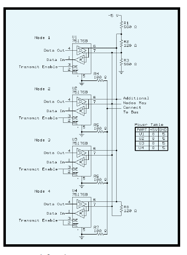

I am trying to make my own controller area network using RS-485.
I am able to send data to the controller i want to communicate with, however am having trouble receiving data back from it.
that means communication from Master to Slave is perfect now. The only problem is getting data back from Slave towards master in which case i have to revert the Slave to Master and Master to Slave. While swapping these nodes, i get data logic error in simulation which means at some point when i swap the nodes, there comes a time when either both are in reception or transmission mode. This is reponsible for the corruption of data :(

To check i tied one transceiver's enable pin with another transceiver's enable pin via a NOT gate. This works fine but i do not want to put a NOT gate in between as it will not work when more than two transceivers are connected.
This is from dim memory so anyone should feel free to correct me if I get anything wrong.
The RW control pin on the driver chip is connected to each pic along with the RX and TX lines. RW should be set to write prior to sending a packet and to read after the packet is sent. That is the often the only synchronization you need. Lets keep it simple for now.
You may be getting glitches because you have wired the R/W lines from two driver chips together. They should be under the control of the PIC associated with the driver chip.
Circuit cellar has a nice article on basic RS485 communication. I may have shown you this earlier but take another look.
https://www.electro-tech-online.com/custompdfs/2009/12/microsys_art_RS485.pdf
Most importantly this.

Also another problem that i found out is more of hardware. On the data BUS, if any of the controller is powered off and the RS-485 transceiver is still On, the complete BUS gets corrupted (data of other nodes stop working). Is there something i can do so that when a node is not active, it doesn't affect the overall data BUS. I have tried putting a pull down resistor with the EN pin of RS-485 transceiver but that doesn't help either. However it corrupts the signal if the controller of that node is switched on. Have also tried adding termination resistors (220 ohm) between A and B on transceiver of node which i switch off, still nothing.
You are now outside of what I have done. Adding or removing a node from a working network is called Hot-Plugging. Not all transeceivers are able to do this cleanly. Check the datasheets.
The only connections between the transeceiver and the buss are the A and B pins and Gnd. It would be great if A and B go cleanly to high impedance when the transeceiver is powered on or off. I do not think this is the general case as TI talks about this as a feature of one of its RS485 transceivers.
It could be that you need to power up a node then connect the GND-A-B in that order. To disconnect unhook B-A-GND then power down. But the transceivers must be designed to do this.
