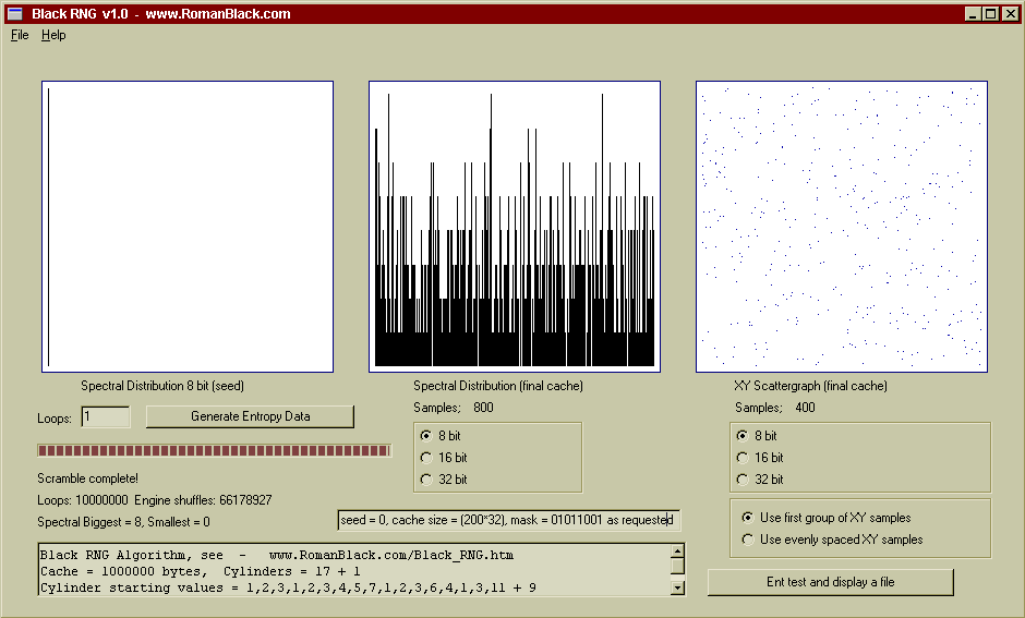

No luck on the testing I'm sorry. I tried your test;
seed = 0
cache = (200*32)
mask = 01011001
Then run 5 million loops to generate 100000 32bit samples, and the engine held. I tried some other cache size variations, also with no failure found. These tests take 5 minutes for 5 million loops so I only tested 3 or 4 variations.

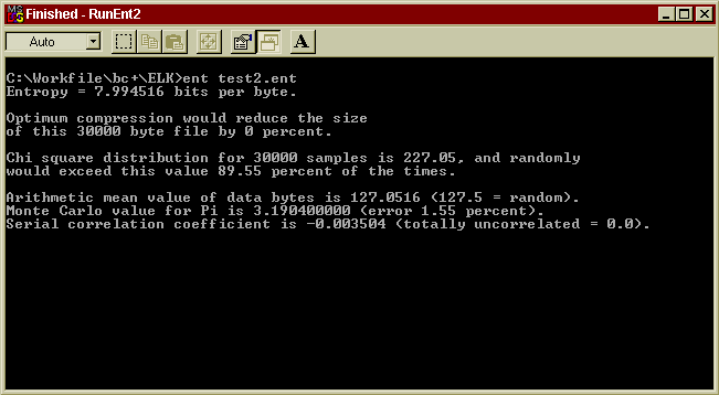

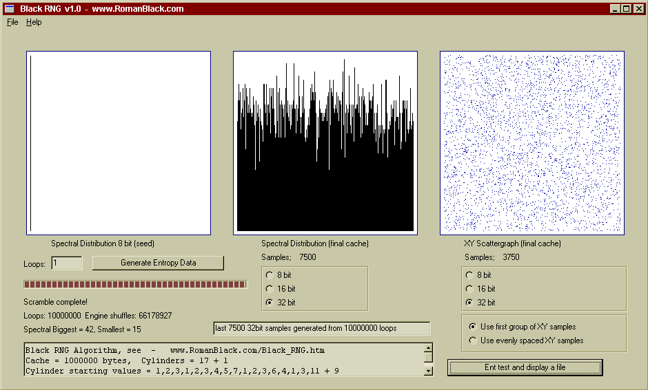

I increased to 10 million loops, (200000 samples and 10 minutes to test!) with your values above and it still held. I have posted screenshots below, the first shows the 800 byte cache looks perfect with histogram and scattergraph as good as 800 bytes gets.
The last 7500 32bit samples were saved as a file, and run past ENT.exe for a second opinion (see second screenshot). Data still looks very good, Chi square a little low but still well in the bounds of natural random for a small sample size of 30000 bytes.
Third screenshot is those 7500 32bit samples as histogram and scatter, again all looks perfect.
I think this is a credit to the RNG that given a seed of ZERO and a very poor 6.6 engine shuffles per loop(!) that it still is outputting entropy close to, possibly as good as organic quality even after 10 million loops and approx 17180000000 total bits generated.
The engine in the above tests is severely compromised, especially by the small value of 6.6 engine shuffles per loop. Ideally with any small cache I would like to see a number of shuffles per loop far greater than cylinders squared, or >324.

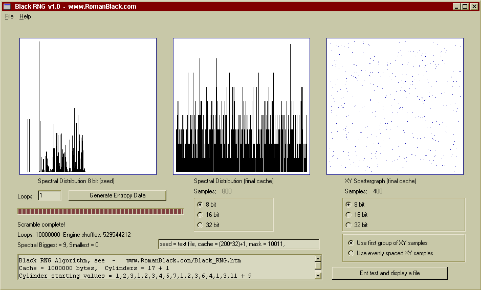

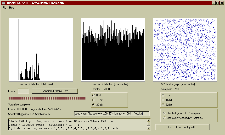

As I was horrified with that figure of only 6.6 engine shuffles per loop seen inthe last engine, I tested an example closer to how I would prefer the engine to be used if a cache size of (200*32) or 6400 bits was around the largest size allowed.
seed = text file
cache = (200*32)+1 or 6401 bits
mask 10011 (5 bit mask produces more frequent engine shuffles)
Again I ran 10 million loops and extracted 200000 samples of the first 32bits of the cache. This time I saved the last 10% of the generated samples to provide 80000 bytes of data for more accurate entropy testing.
The number of engine shuffles per loop has improved from 6.6 to 52.9, better, but still much lower than I would like.
Data is shown in the screenshots below, and like a properly setup Black RNG the data sample is well within the same entropy specs as natural RNG data like radioactive decay etc.
But if I really needed to implement an RNG with a small cache like this (due to ram limitations?), I would use more cylinders and aim for much higher number of engine shuffles per loop, possibly through the use of multiple 5bit masks.
I have a PIC C version with 256 bit cache that I played with some months ago, but has only had limited refinement and I'm still not totally happy with it even though it is fast and compact. When I get some time I'm going to explore multiple masks and even nested loops of engine cylinders (instead of just one loop of engine cylinders).
