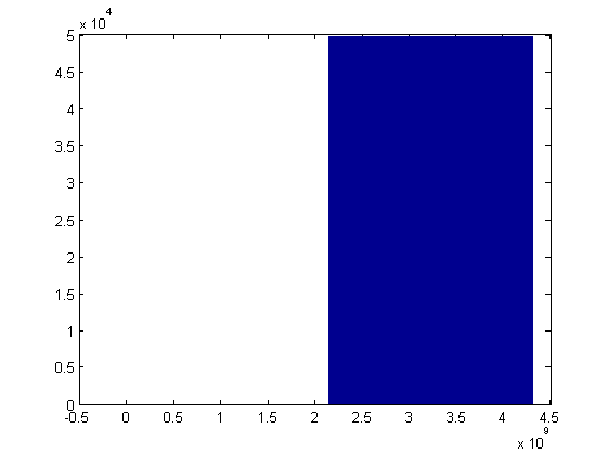

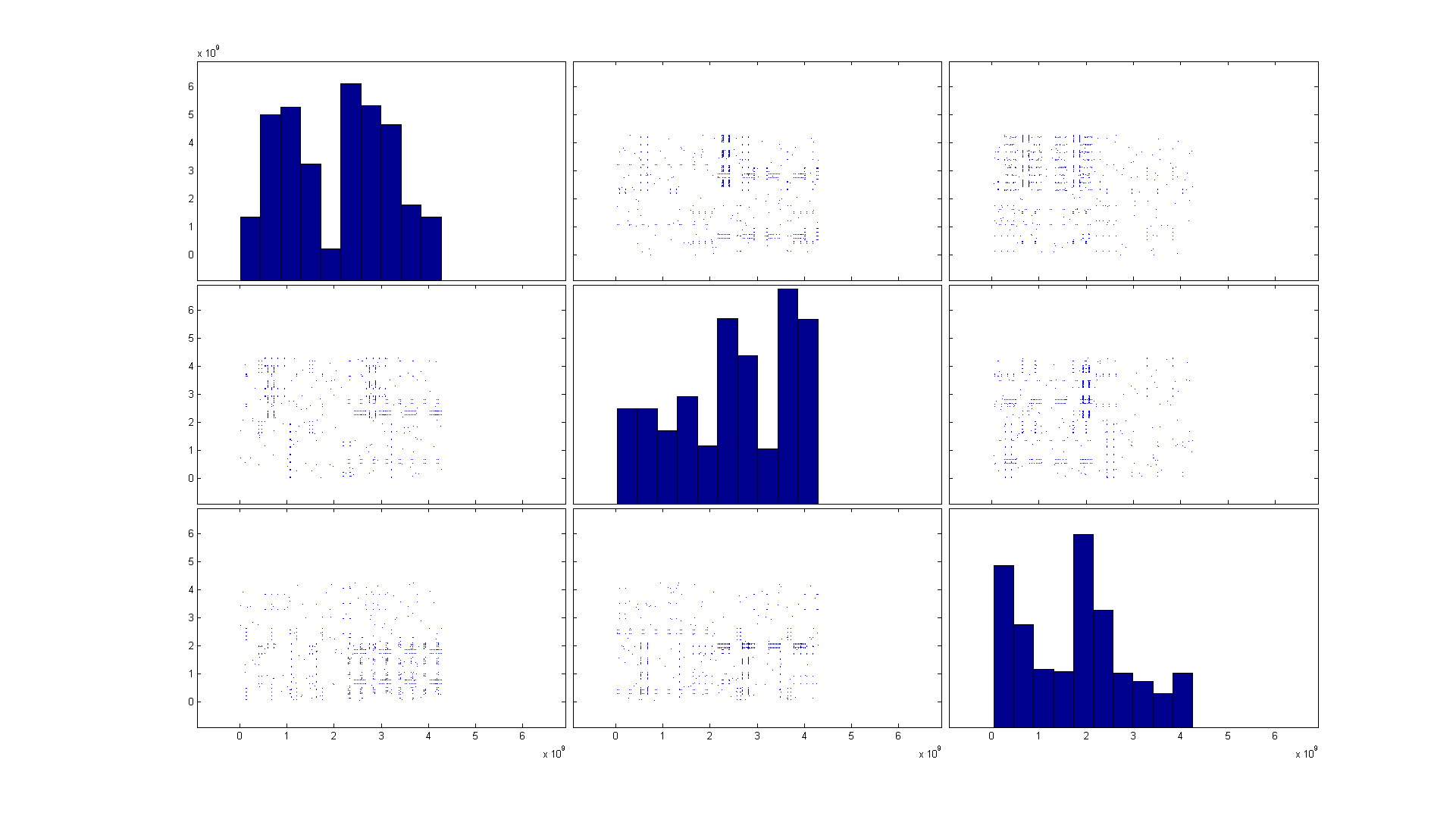

I just finished implementing the Black RNG. I used a cache of 3.2 million bits and iterated the cache 100 times with an engine recommended by Mr Black (10 cylinders + 1 hold).
Attached is a histogram of the 100 000 x 32bit unsigned integers that was generated. Does not look too good for me. The smallest number generated was 11936.. above that the distribution looks quite even. But, I think I'll have to double check my code after Mr RBs results.
Edit: added the test result from Diehard Battery (blackout.txt) (80 million bits generated and tested).. and with a quick look I think the Black RNG passed all 15 test. I don't know what happened with the histogram I plotted. Have to check that later.
EDIT: I believe the histogram is correct. When I generate 16bit numbers, the histogram is quite uniform from 0 to 65535. But, when I generate 32bit integers the histogram is uniform only from 10000 to 2^32. Everything below 10000 is zero (the best case I was able to generate so far). So, there are some major issues with the Black RNG.

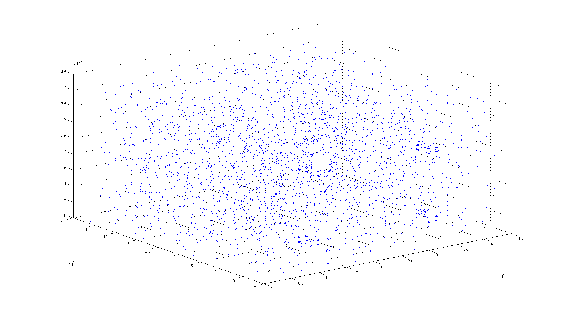

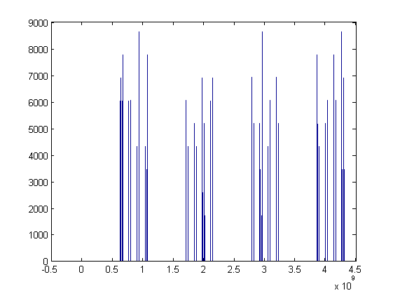

EDIT: More histograms and scatterplots. There seems to bee an obvious structure in the individual 32bit integers in the generator cache. I used 6400 bit cache with the same 17 cylinder engine Mr Black used in his example code. There was 50 passes between each number saved.
The "Histogram-of-first-32bits.png" shows the distribution of the first 32bits generated (50 passes between each number saved). Very horrible looking distribution for a RNG.
The "ScatterMatrix.png" shows the distribution of random 3-tuples generated.. The "3DscatterPlot.png" shows how the generated 3D points cluster on few spots in the 3D space.
So, my conclusion is, that even if the Black RNG passed the Diehard Battery with good results, the generated numbers still have a very strong structure in them. This structure is well hidden if the cache is very large i.e. million bits. But large cache won't remove the structure, it only interlaces multiple structured sequences together. The setup that Mr RB calls the "the worst case" is:
For the random data I just used the value in the Black RNG "cache", this is a worst case scenario as normally you would generate data on the fly as the engine progresses.
This, in my opinion, is the best case you can get. The whole (million byte) cache should be used as a sequence of random bytes. Then the whole cache should be "scrambled" with some passes with the engine.. and even then I wouldn't trust the data enough to use it in Monte Carlo applications.
I also experimented with different amounts of passes of the cache. Even with 500 passes to the whole cache before saving the next generated number, there was practically no change in the generated pattern. Only thing affecting the pattern is the cache size. And that is equivalent to setting up multiple generators in parallel with different seeds.. effectively leading to different sets of structured sequences. All datasets were generated with the cache first filled with random numbers from a library RNG.

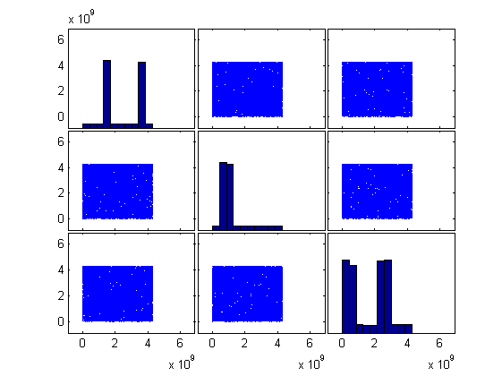

To MisterT- Thanks for implementing and testing my RNG. :) I'd like to comment on your results;
1. A 10+1 cylinder engine (that you used) produces inferior results to the 17+1 engine I used in my most recent tests. Also the quality of the output depends on the values used within the engine, the values used in my last tests worked well.
2. Your 32bit histogram test is flawed, likely your other histograms. 32 bit values have a range of 0 - 4.3billion, so your "<10000" represents just 0.00000233 of the total range! With your small amount of 100000 samples it is quite statistically likely none of those 100000 samples will happen fall within such a tiny slice of the pie. You need to stick to 16bit histogram or less with that sample size.
3. Re the further tests, a 6400 bit cache is too small for really good entropy, as the engine suffle event occurs every 256 bits average, and you are getting too few engine shuffles per sample loop as evidenced by the patternation shown in histograms and scatterplots. That patternation will also be evident if you have not correctly implemented the engine shuffle part of the algorithm, which is the only time I have seen patternation from a large enough cache.

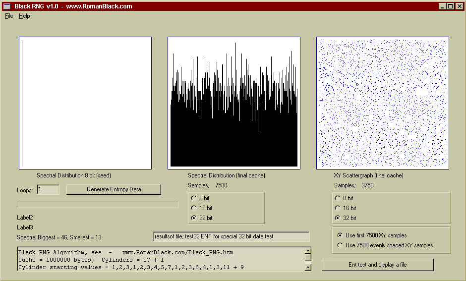

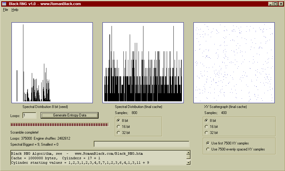

On a RNG note, after examining MisterT's findings and charts above, I took the time to today (between replacing my hot water system that blew up) to code scattergraphs into my own RNG software and updated my histogram code to display 8,16 and 32bit histogram data. I'm not sure what MisterT got wrong wither in his BlackRNG simulation or in his analysis/charting code, but I have done it right in both cases and there are a heap of screenshots on my RNG page of what the generated data, histograms and scattergraphs actually look like.
I have also provided free Windows software so people can generate their own data, and a 1Mb file of good data if people just want to test the random data.
Sample screenshot is below and my RNG page is here; My RNG algorithm page
Nothing wen't wrong with my scatterplots. The difference is that I was looking for structures in the generated data and you were not. It took me a while to find those structures.
The idea of testing is to find weaknesses in the system. When you find a problem you either fix it or you document it very well so that problems can be avoided.
I did use a small cache to find those structures in the data. I haven't been able to find visible structures in data that is generated with very large cache, but it does not mean there aren't any.. and the structures I found suggest that there might be some in properly generated data also.

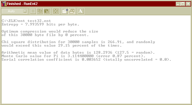

MisterT, I took the time to replicate your test where you said my RNG "failed" generating 32 bit numbers from a small cache.
This was the engine I used;
6400 bit (800 byte) cache
17+1 cylinder engine (standard start values)
Method;
1. start with typical text file as the seed
2. perform 50 loops through the 6400 bit cache
3. make sure engine pos is >100 bits so the first 32 bits must be done
4. save the first 32bits of the cache appended into a file
5. repeat steps 2-5 until 7500 32bit samples were generated
Results;
Total loops through the 6400 bit cache was 375000, ie 50 loops * 7500 generated samples.
The first screenshot below shows the state of the 800 byte cache after such a huge amount of loops, as you can see the histogram and scattergraph appear perfect indicating apporpriate randomness in the cache and no evidence of settling into patterns after 375000 loops. The spectral distribution of the cache (and 0-9 range) is exactly what I would expect to see from 800 random byte samples with a 3.125 samples/bar mean.
Now the 7500 32bit generated samples (file size 30000 bytes) was tested using John Walker's ENT.exe program, the result is shown in the second image. The arithmetic mean, Monte Carlo Pi and Serial correlation are all good for a 30000 byte sample and the important Chi Squared value that would easily indicate any patternation (as MisterT reported) showed no patternation with a great result of 29.15%, all results not too far from a radioactive decay RNG result.
The 30000 byte file of the generated data "test32.ENT" is attached.
Finally I modified my Windows program to load and display the test32.ENT file. This is shown in the 3rd screenshot. The spectral histogram of 32bit numbers is exactly as expected for good random data in a sample size of 7500, with a range of 13-46 and mean of 29.29. Likewise the scattergraph with 3750 32bit XY points plotted, is as random as it gets.
Last picture is the histogram that MisterT claimed was produced by the same tests, which is nothing like the real results. If anyone wants to see any of my source code to replicate these tests just ask.
This test of extracting the first 32 cache bits after every 50 loops through a small cache is NOT the way I would generate random data. For this amount of data over time it would be far better to generate 1 output bit for every 1.56 passes through the cache maximising the number of engine shuffles and scrambling between each bit generation. However even with such a difficult test the RNG holds up well.
MisterT, I no longer have any confidence in your ability to code up a working version of the Black RNG and test its data. :( Even your test itself is not representative of a logical way to generate data from my RNG.

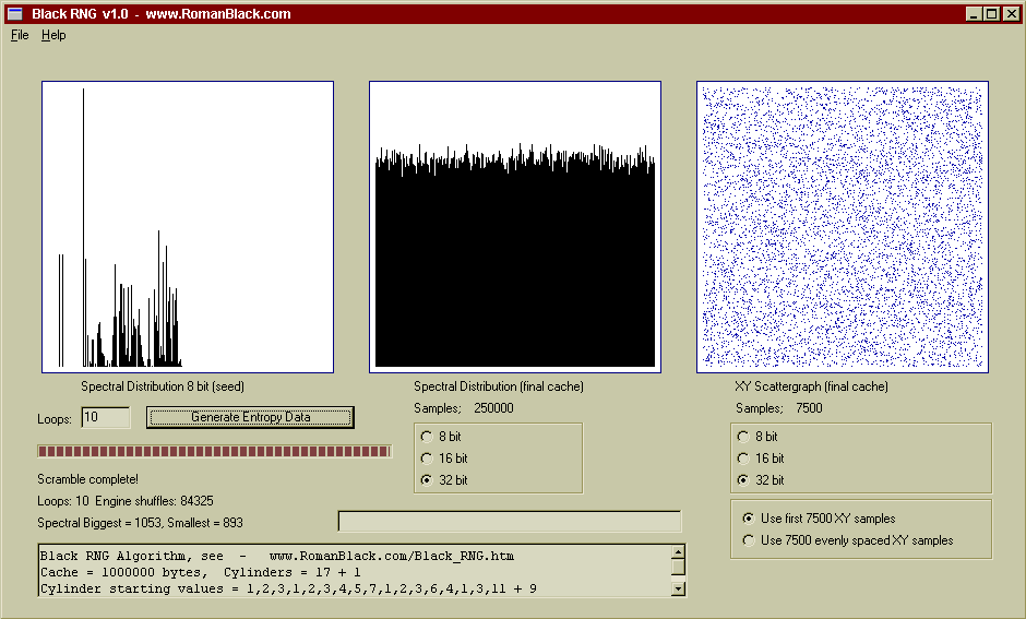

MisterT-
There is no way a sample size of 7500 can fill up a histogram like that when the number of the values range from 0 to 2^32. Can you make a histogram that also shows the values of the axes? What do you mean by "range of 13-46"?
The spectral distribution histogram in my screenshots shows all the samples plotted on a bar chart.
The chart is 256 pixels wide (for convenience) so there are 256 vertical bars, and each bar shows how many of the samples fall within that 1/256th of the total possible range. As they are 32bit samples being charted the total range is 0 to 4.3billion (same linear range as shown in your histogram).
Tha value of the axes is just scaled for good viewing, as stated by the range of min-max bar height (13-46) the tallest bar indicates 46 samples are in that bar.

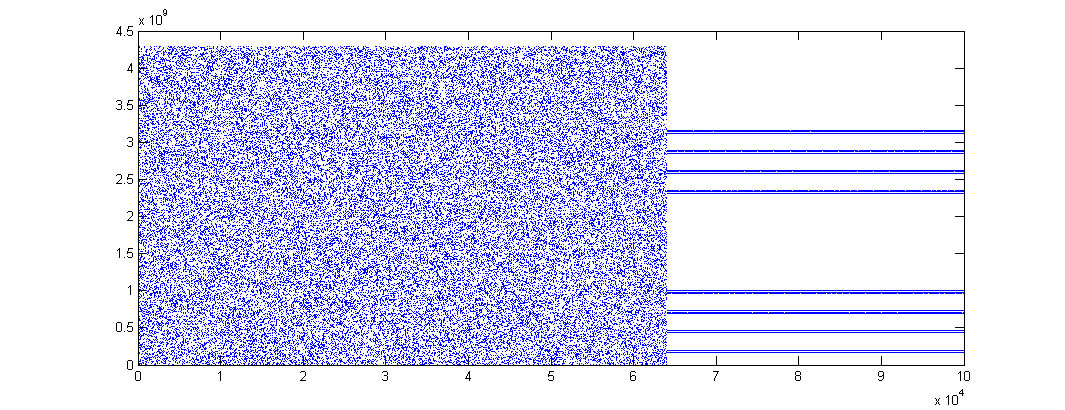

That is quite useful result you created. It got me wondering: How fast the data converges into the pattern? I initialized my cache with random data from a library RNG routine. It would be interesting to know how the data got stuck into fixed pattern.
This is the setup:
230*32 bit cache.
17+1 cylinder engine (standard start values).
1. start with random numbers from (available) library function as the seed
2. perform 50 loops through the 230*32 bit cache
3. save the first 32bits of the cache appended into a file
4. repeat steps 2-4 until 100000 32bit samples were generated
And attached is the plot of generated data. Horizontal axis is the (running) number of data and vertical axis is the (random) data value.
My quick observation is: The bigger the cache, the longer it takes the data to start repeating itself. And the transition is amazingly sharp.
So, could you (Mr RB) repeat your test with at least 100 000 samples? I noticed that with cache of 240*32 bits I didn't get any structure with 100 000 samples. And, with 200*32 bits of cache, the data started repeating itself quite early.
UPDATE: There is more to it.. With 229*32 bit cache, the 100 000 samples seemed to be uniformly distributed, but with 230*32 cache, the data is like the one plotted in the attached figure.
UPDATE: My library RNG took its seed from the system clock. I changed that to a constant so I get the same initial value for every cache.. Turns out the initial cache value is a big factor in how fast the data starts to repeat itself. I couldn't repeat the results in the attached plot with different initial cache. The results vary from better to worse.
UPDATE: The structure seems to have a very clear self-similar pattern (Cantor set -type). Black RNG could be more of a fractal engine than a random number generator. I had fun zooming into the pattern with Matlab. I'll try to make some good images to illustrate this self-similarity.
