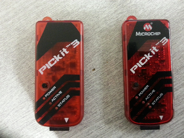

Clones are very different inside!!
Hi Doc .. the fact your Pickit will 'perform' with a dev board, still suggest your 'lashup' is wobbly, I learned some time ago the BB thing is just asking to waste hours + hair ! its ok for the odd wire ended stuff and occasional IC . My PICbed (TM) :) was quickly knocked up and cheap:happy: . Think you need something similar...

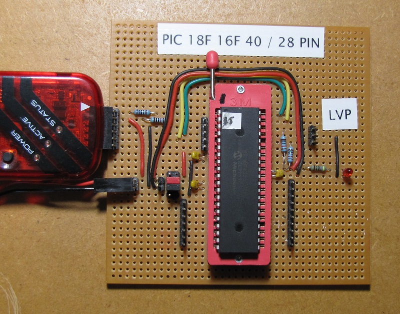

Remembered where I got ZIF from **broken link removed**

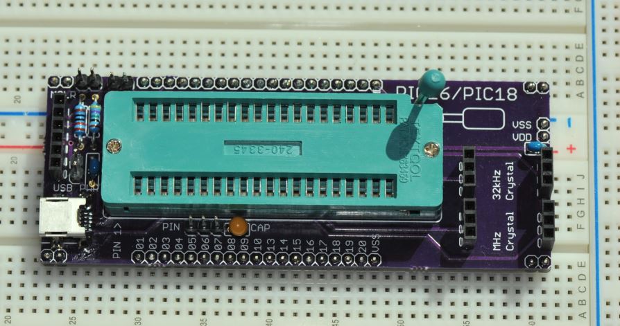

I notice you have usb port on there, is that how you program? without pickit?
this is what i use for fast programming off the board:
but usually its just the demo board used when testing new peripherals, or jumpers to a test BB circuit, i like to start with BB too since most of my designed circuits need tweaking

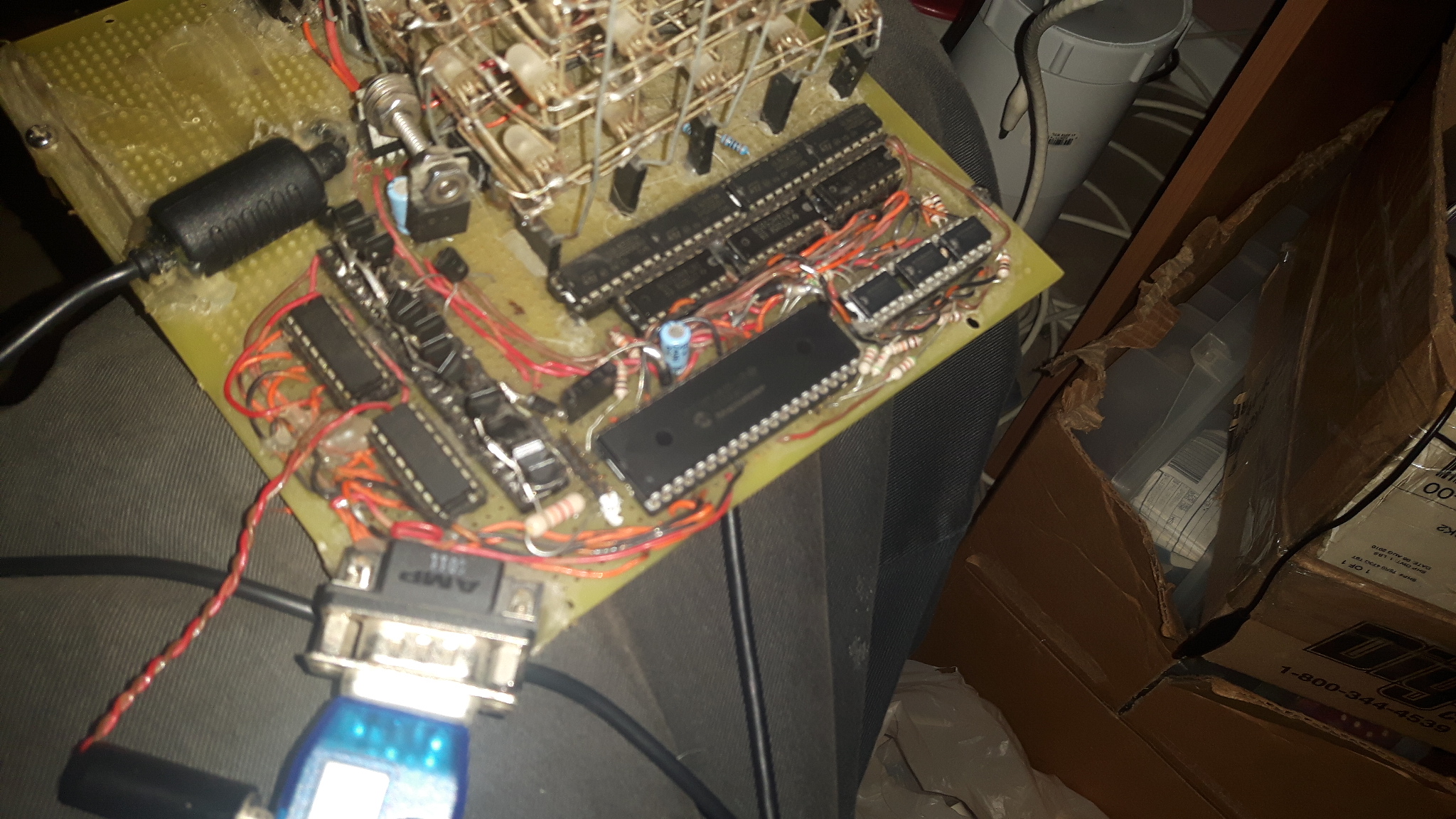

the 4620 project has its own icsp on the perf board much like grandads example, not as clean though! I just temporarily switched to BB for quick test to ensure that it wasnt perf board or the chip itself or connections failing, which i should mention that despite the looks the icsp wires are short in length and clean connections:

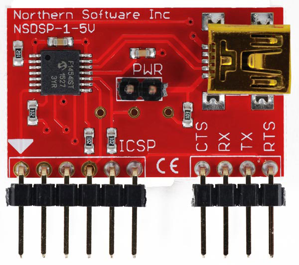

No, the USB connector is for the PIC which is put into the socket, so the PIC could tack to the PC through USB. USB is easier to wire on PCB than on breadboard. The connector for the programmer is a little bit higher. You can stick PICkit3 into it vertically. Even though it looks flimsy in this position, it works fine. I since then made my own programmes, so I rarely use PICkit3. Here's how the programmers look like:
The ICSP connector is the same as on PICkit3. But, since I have built the sockets before I designed the programmers, there is a problem with inserting the programmer into the socket - the USB connector is exactly where UART pins are. So, I had to cut the UART pins from the programmer to use it with the socket. When I make the next socket, I certainly will make it slightly different, perhaps add a connector for the UART pins too. Another idea - since the whole programmer is basically a single small chip - I can put the chip directly onto the socket. This way, I'll have another USB connector instead of 6-pin ICSP and my socket will become self-programmable.

Yes, can debug too. However, the user interface for the debugger is not written yet.
It's PIC16F1454. It converts USB to SPI which is used in ICSP. There's some added complexity because there are 1200 different PIC models all with different flavours of SPI and their own idiosyncrasies, but otherwise it's all SPI.
doesn't the linker or software on the pc side handle that though?
The linker creates a HEX file (or equivalent). It then needs to be translated into a set of SPI commands which PIC can understand and then these commands need to be transferred to the PIC. Part of the translation is done by the programming software running on the PC. Another part is done by the programmer.

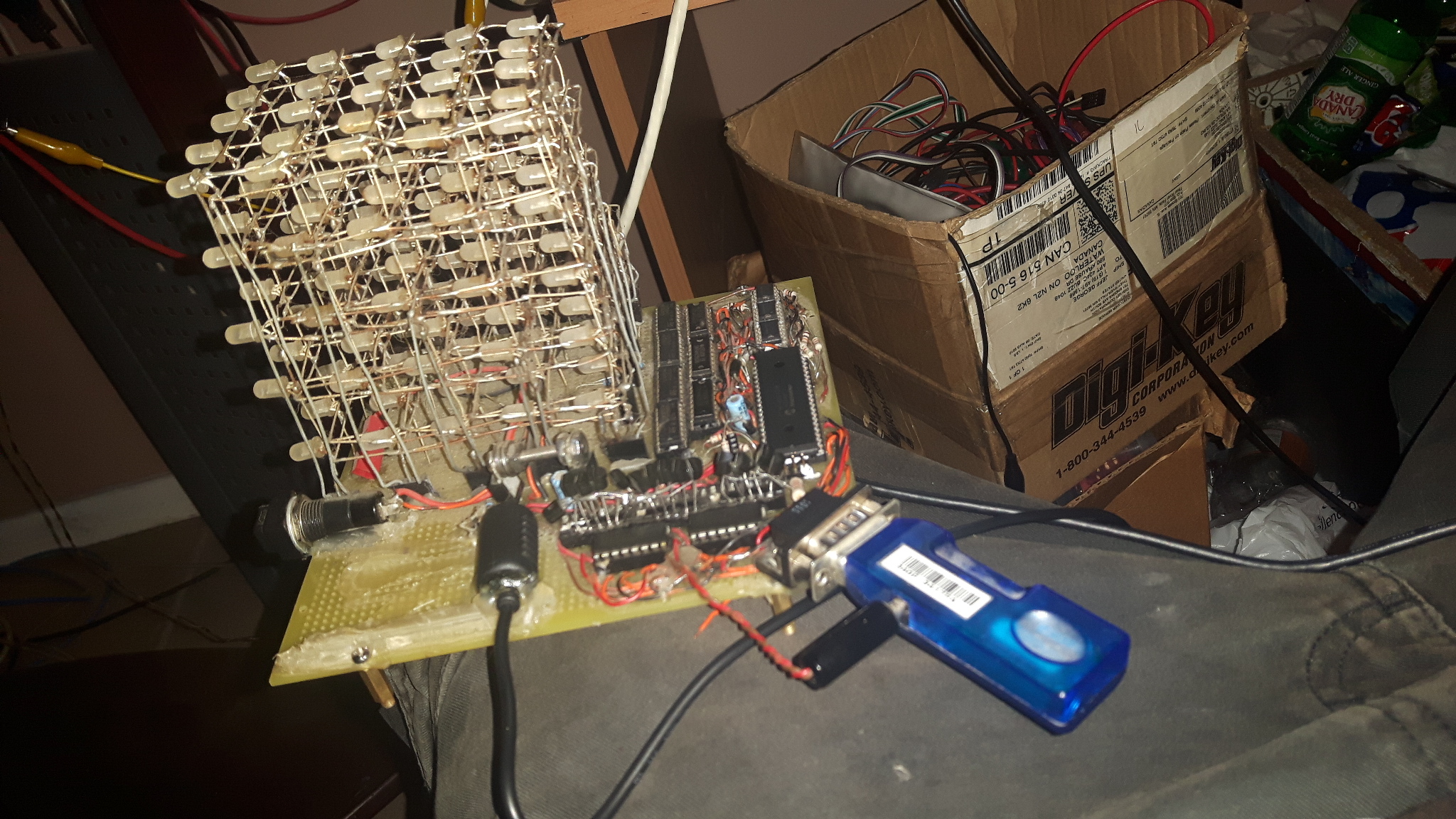

so now my cube is running nicely again...
have a few 4620 chips left, so I guess it will be simplest to steer away from using them in future designs,
