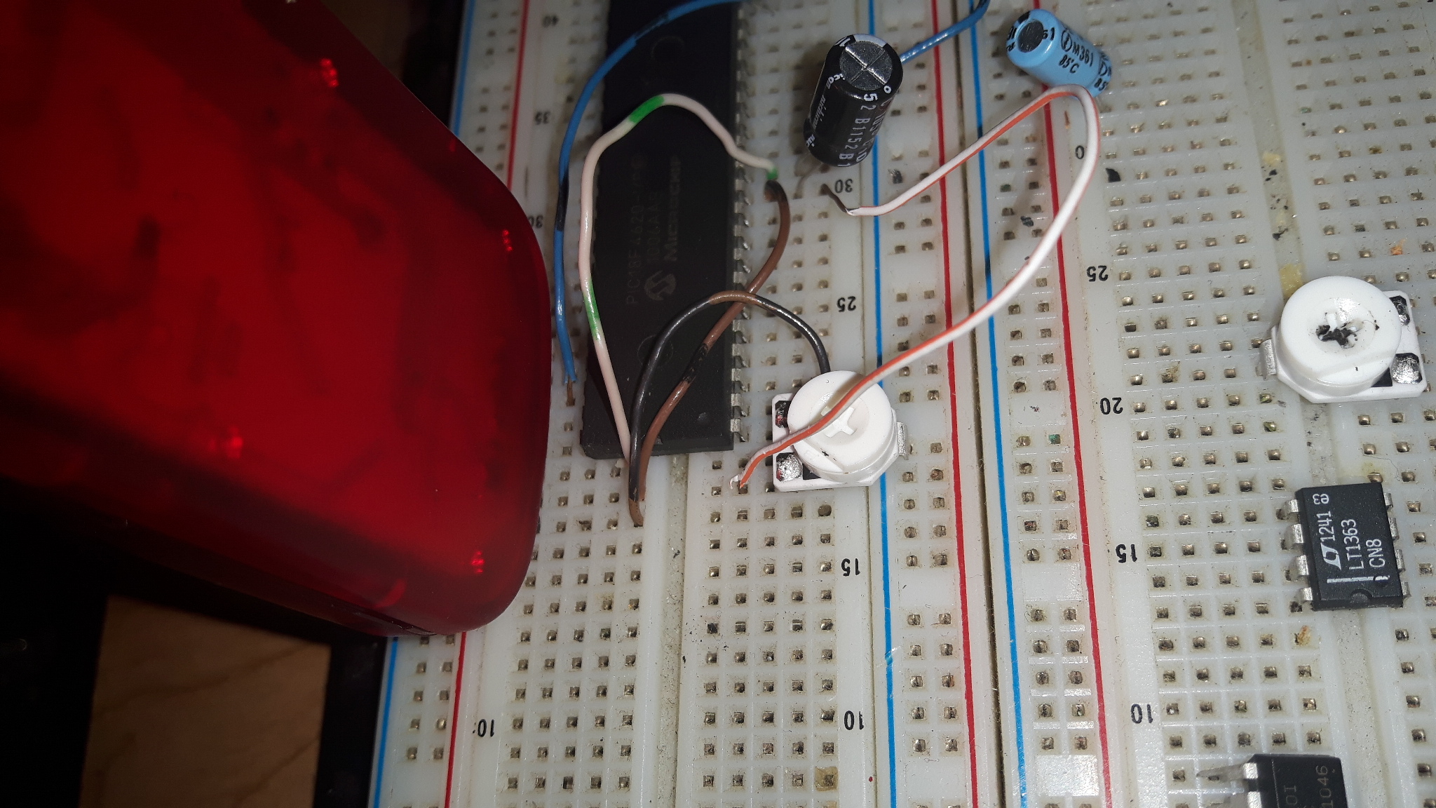

Hi doc As said , PK3 will debug your device, From your picture you have lined up PK3 data / clock pins to the IC pins presumably with a long pin header, does that include PK3 pin 6 connected to the pic pin ?. I have found problems arise if you put a signal on that pin(6) .. You don't need the large electro cap across the power you do need some .1uF on all the Vcc Vdd pins .also I see your PK3 is a clone ?
10 & 100 uf is all i had layin around, i can dig to be more accurate with the 0.1
I have removed pickit pin6 specifically (not like in photo)
both power rails hooked up now

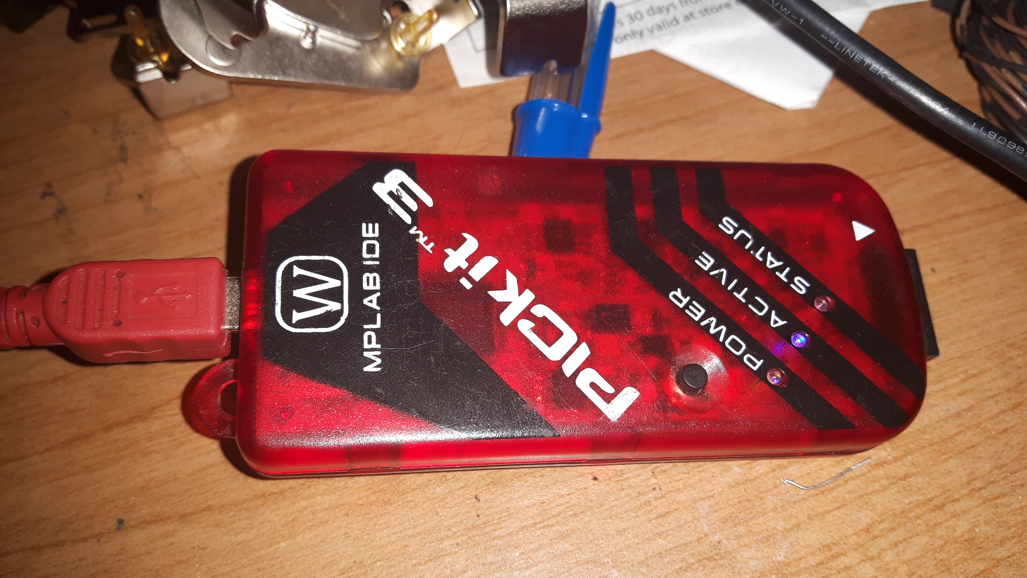

not sure about if it is clone, but dont think so, it says on the front "mplab pickit3" with a "M" on it..

Doc... Still think your PK3 is a clone , back of a PK3 has serial # , also tracks and components inside are different to your photo.
the PK3 serial number is reported in the MPLABX dashboard pane , or the project config ?
edit ( perhaps not a good idea to post # just that it has one )
I think this is what you are lookin for....also it does have serial number starting with bur... a quick search showed that clones have no serial num at all (?)
