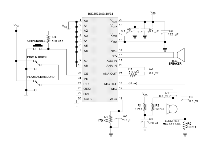

I think you can record the mp3 music as you play it on your computer. For this, I think you can use an IC like the ISD2532. and then use it in the doorbell that you wish to design.
A typical application circuit is available in the datasheet of ISD2532. Try going through it.
http://www.tranzistoare.ro/datasheets/2300/261251_DS.pdf
The page above contains the datasheet and i have attached the typical application circuit below.
