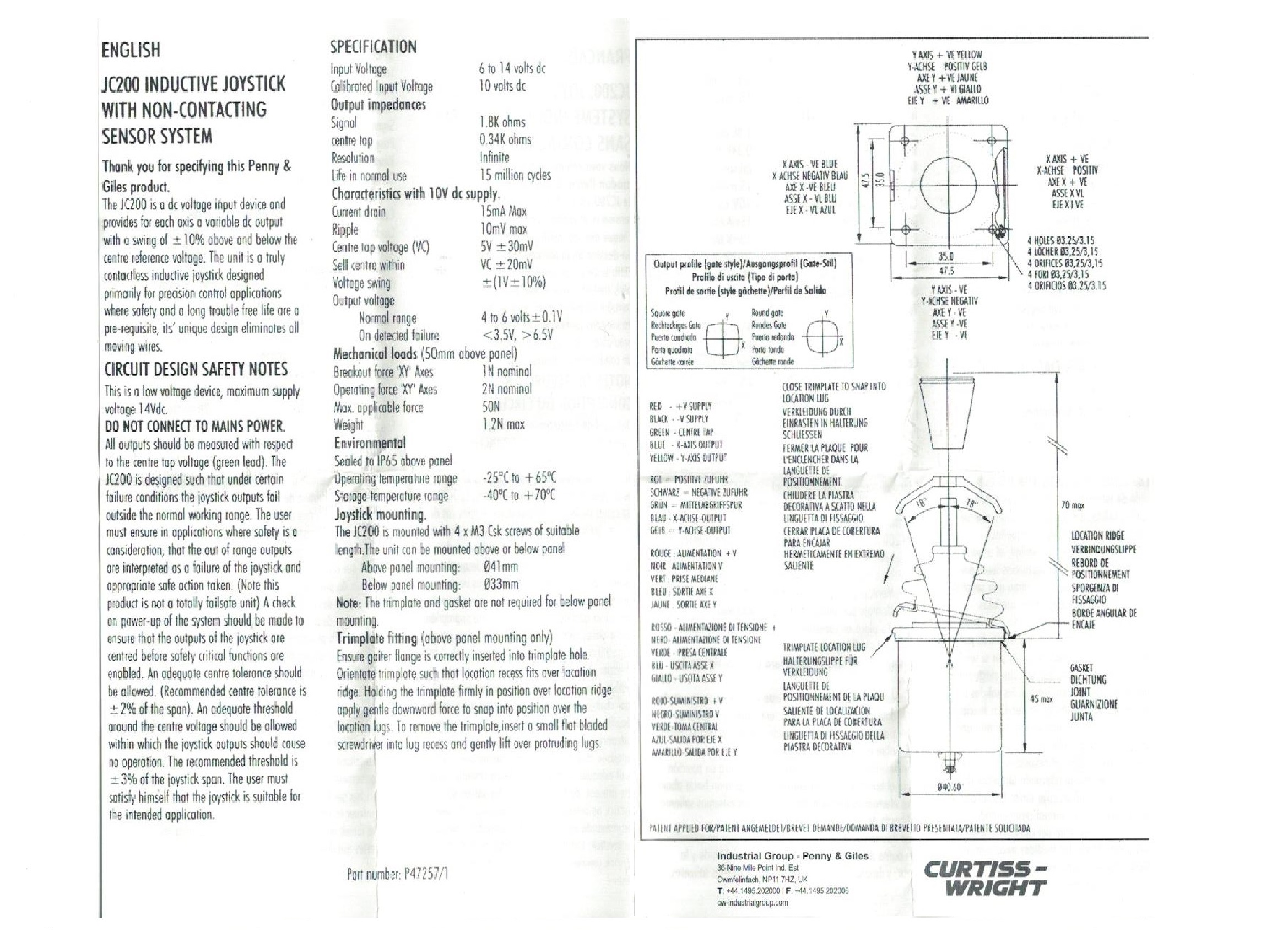

(i would like to use a joystick(wired) and have a dial for speeds regulation)
You could have a joystick which is a simple type with four switches for the directions (left, right, up, down) and a separate controller for the motor speed.
or
you could use an analogue joystick, like this one:
which will allow you to select the direction of movement, and the speed of movement, depending on how far you move the joystick from its resting position.
To implement this, you may need to use a micro-controller such as a PIC or Arduino.

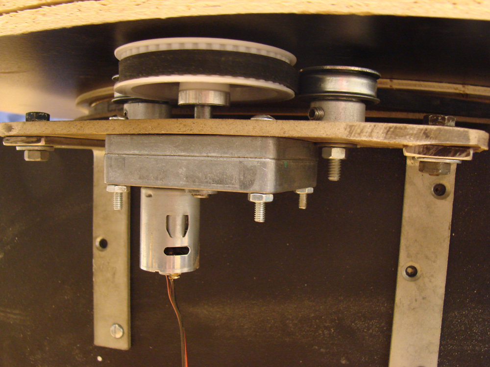

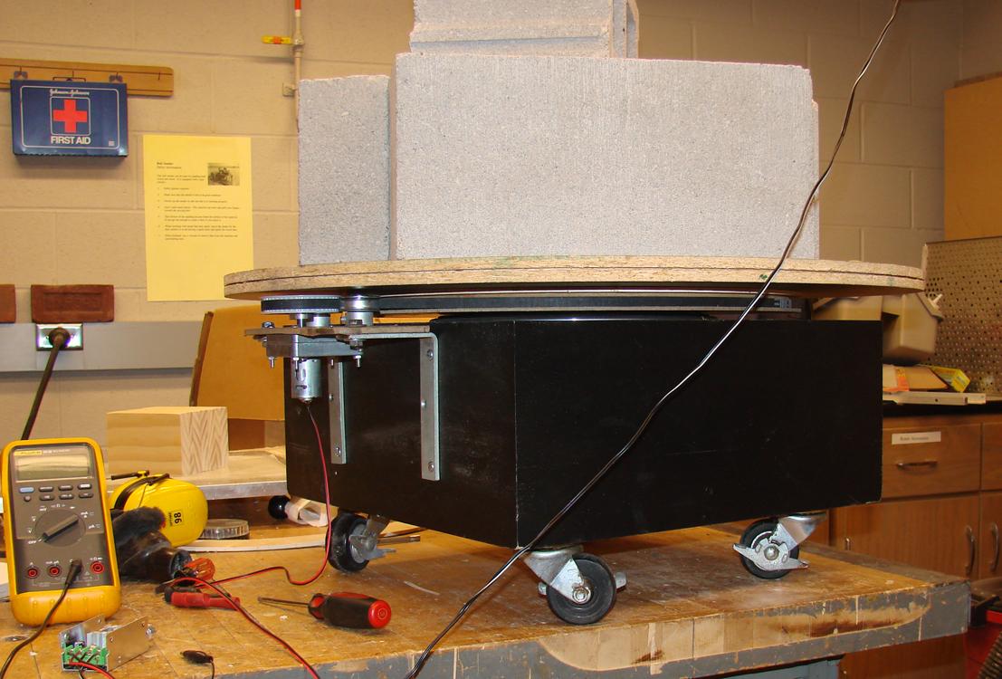

For the mechanics..I built my son this variable speed turntable for 3D scanning a person. The drive is a very small DC geared motor. The speed is controlled by a small variable PWM power supply. Enough torque to rotate a 210 pound subject. The turntable design should work perfectly for a Dobsonian azimath. And maybe elevation too.
Ken
