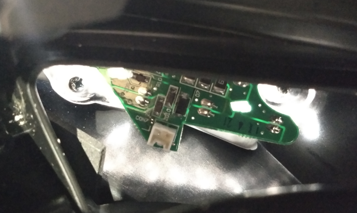

Motorcycle Turn Signal LED - Unique situation

I have a marginally better photo, and one that is much more "zoomed in". This one ought to be able to be viewed.
I hope that helps. I'm really at a loss as to how to complete this project without a way to connect things together. The other end of the wiring is just bullet plugs, and I already have some that will work.
Any help identifying these plugs, and locating a source to buy them would be fantastic!!

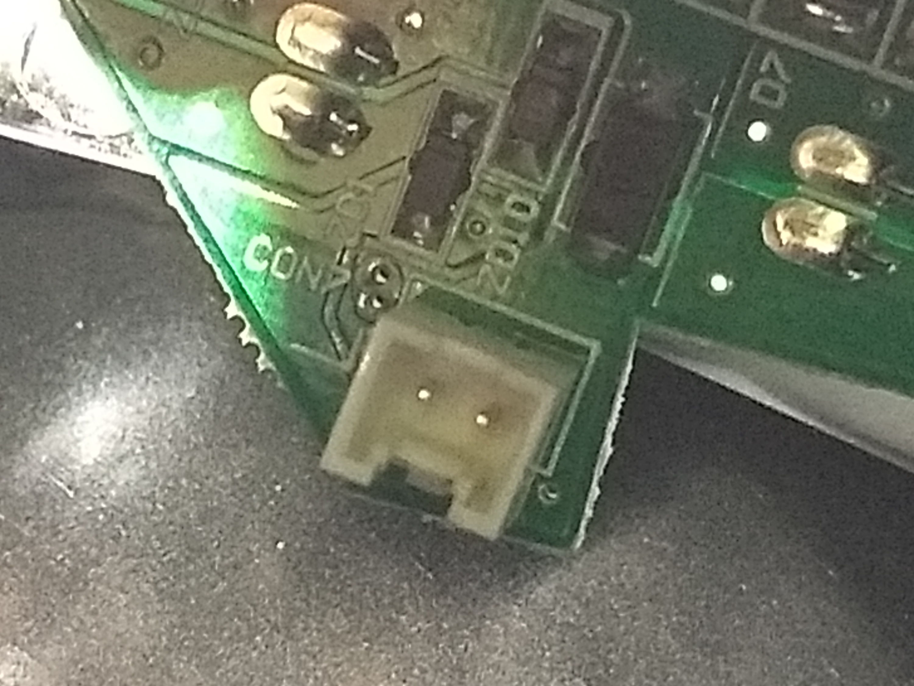

Here they are:
Right you are. Molex is a brand name
Wow... that was fast.
I'm perfectly willing to take the thing apart again tomorrow, and make some measurements to ensure that I get exactly the right thing.
Can anyone advise me exactly what I need to measure, aside from the distance between the prongs? I would imagine that I need to measure the exact size of the cavity, depth, width, and length too. Is there some website that shows standard sizes for these things?

If it is a jst socket (looks like one) you may be lucky and it's the same one used on radio control batteries. A visit to the local model shop may be worthwhile.

Pretty close. If there were a plug that fit this, it might be the one, but this is more like the male socket in the PCB on the bike. It's the female plug that fits into it that I'm after here.
I'm going to look through that page there and see what they've got like this. Thanks!
They obviously have the matching plugs as well, I sent the link to the socket so you could compare it to yours.

Why, yes, it is a fantastic idea! I don't think there's an RC shop around where I live, but I do know there's one about an hour away. It may be time for a road trip. Or better yet, I can call them, tell them the dimensions of my socket, and ask if they have any plugs that will fit it. Stupor Mundi!
That brings up only one more problem. And it's a two-parter.
First, how will I know what the polarity of the connection is? Are they all wired to some International standard? In other words, if I get a plug with red and black wires dangling from it, will they be set up the correct way? I hope there's a standard for these things.
Second, I've started to wonder if this is even the power port for the PCB of the turn signal. Is there something I can do with a multimeter (and yes, I have one, although I have no idea how to use it, but that's what YouTube is for!) to determine if that is indeed the power plug?

If you can work out the jst type then you may find them on ebay. Like this. These ones are 1.25mm between pins and type XH.
There isn't a standard polarity. I bought one of these and it's the opposite polarity to R/C batteries but the same connector.
