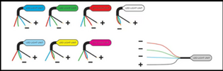

Hello
I am running common positive led lights RGB. They require the 12VDC to run on the negative (black) wire going to each light.
In turn when I ground out one of the RGB (wire) lights they light up.
I am using a common negative switch for doing so that I have run through relays.
I have negative wire going through the common of the relay so when it operates the rgb light has source to negative.
Is there a way to do this without the relays?
Something confused there???
The LEDs need negative power switching. The controller is common negative.
That says the controller switches the negative, exactly as the LEDs need?
What exactly is the "controller"? It's shown as six connections, nothing commoned in the sketch?
The controller switch's a relay that gives the led a path to negative.

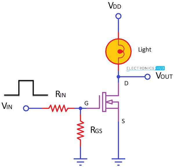

Do you mean that is is intended for LEDs that have their common to negative (0V)? In other words, the controller switches the positive side?
If so, you could use appropriately rated transistors or MOSFETS, so they are switched on by the positive signal and pull the LED connection to near 0V.
Example, something like this, using a MOSFET - one of the LED colours being where the lamp is shown:
Rin limits the peak current gate charging current, and if the control voltage is higher than the required or maximum gate voltage, that and Rgs act as a divider to limit the voltage to a safe level.
Rgs ensures the MOSFET is off when there is no input.
For a typical power MOSFET the gate should be at around 10 - 12V for minimum dissipation when "ON".
If the control device produces a 5V signal, then you need "logic level" MOSFETs that can operate with lower gate voltages.

The MOSFET circuit I showed would be suitable then; one MOSFET and two resistors for each colour,

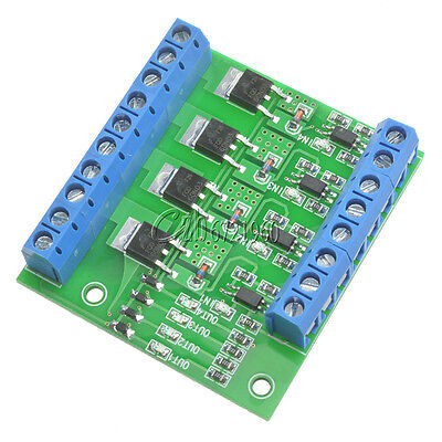

For simplicity, can't your controller uses a common connections for the relays? That layout is time consuming.
Im wondering about the outputs as it seems the board it switching the input voltage.
The outputs are switched to 0V as you need for the LEDs; the OUT+ terminals are all connected directly to power +
There are photos from different angles & the board underside in this listing:
You can see all the output side "+" terminals are tracked together.
i see that now, like using common positive as I need and switch the neg.

I'm sure this would work but I would have to build it.
I'm not setup for building cct. board as such.
The other one is setup already and not expensive.
