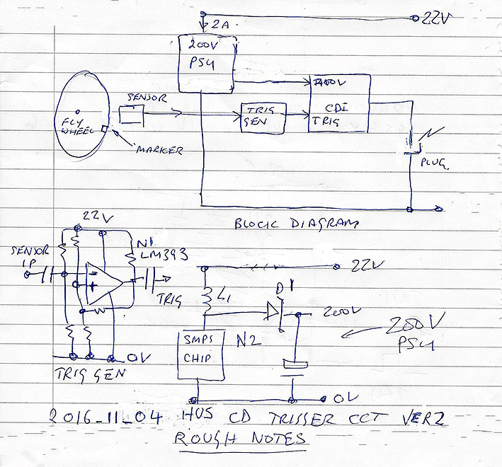

Hi Max and Les,
I am thinking about a single magnet and single sensor, which means that there will be no lost spark. The question is though: is the lost spark required, say for plug cleaning?
Below is an outline block diagram and circuits that I hope will do the job.
spec
Another question Max
Is the power for the ignition system to be taken from the 22V battery? The current will be around 2A.
spec
Another question: is there any reason why you have gone for a 22V electrical system rather than the more standard 12V system?
spec

Hi Les,
Yes, you are quite right. SCR latch-on is a hazard. I had envisaged inhibiting the 200V SMPS for a period sufficient for the SCR voltage to drop below its holding voltage.
The CD ignition systems that I designed, had a current sensing resistor in series with the SCR and, if there was any current detected, the 400V inverter was inhibited to prevent SCR latch on.
One consequence was that the inverter sounded like a chirping bird, which the users really liked.:)
spec
PS : In theory, the oscillation of the the ignition coil primary winding should turn the SCR off automatically, but there is always the daily one-in-a-million event that disproves the theory.

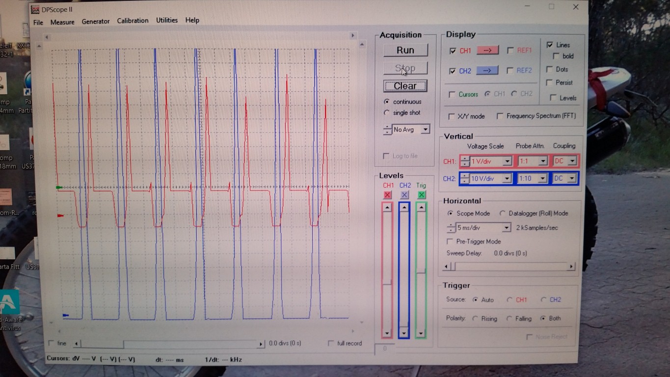

Well, apologies for the poor quality pic. Had to take a photo of the computer screen to get it small enough for this site to accept.
Please see attached pic.
It is the trace of the charge coil voltage, one probe on each lead from the coil to the CDI unit. Ground lead connected to the engine case. Engine running at around 3500 rpm, calculated from the trace frequency. The probes were set to 10x . As you can see, looks like I mis-read previous measurements of the Charge Coil output voltage, over 1,000 on the blue trace, ( I'm guessing very high input impedance ) to whatever it goes to inside the CDI unit. So the red trace is probably being held low by charging the cdi capacitor.
About the lost spark question, I do not know the answer to that, but my guess is it is not needed for cleaning or any other purpose. I suspect it is just a remnant of needing the 4 magnets and three original coils for the original generator.
Hi Max,
I assume the red trace is the trigger pulse. What is the maximum and minimum speed that the engine runs at ? There is a free utility that I use to capture parts of the computer screen that should give better results than using a camera. It is called Gadwin Printscreen. This is a link to their website.
If you had a better image that was too large here is an**broken link removed**
http://www.gadwin.com/printscreen/
Les.

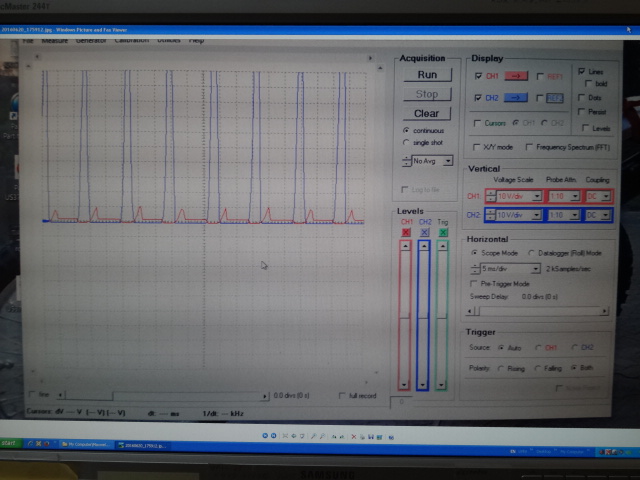

G'day Les, thank you for those links. Below are a couple of clearer pics of the traces. This is taken at just over 2000 rpm (trace frequency, remembering it has a wasted spark)
There is no Tacho, but a practical minimum would be somewhere from 1,000/1,500 rpm to a maximum of about 9/10,000 rpm.
I did learn that the original CDI/magneto will not spark until the rpm is somewhere between 217 and 432 rpm, the only speeds I was able to set on the lathe. Which means the kick starter is spinning the engine over at a similar rate. But at 432 rpm, it will jump about 8 mm at the high tension lead. At 2086 rpm, it will jump over 20mm. So creating some serious voltage going to the spark plug.
So you would expect that shape of signal and voltage level on the Blue trace to charge the CDI internal capacitor ?
Its actually over 2,000 volts, or am I mis-reading something.
If the Red is the trigger signal, what would you expect it is driving that would give that trace shape and hold the voltage down like that ?
Those two probe leads are connected to each end of the charge coil as the engine was running.
These were the original measurements I took. I could not get the stand alone scope or the USB scope to work correctly while running the system in the lathe. Getting weird readings on both, so whether its stray EMF's or earth issues, I don't know.
I downloaded the Gadwin program, but two attempts failed to get it working. Said something about not being a valid Win 32 file or something.
