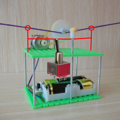

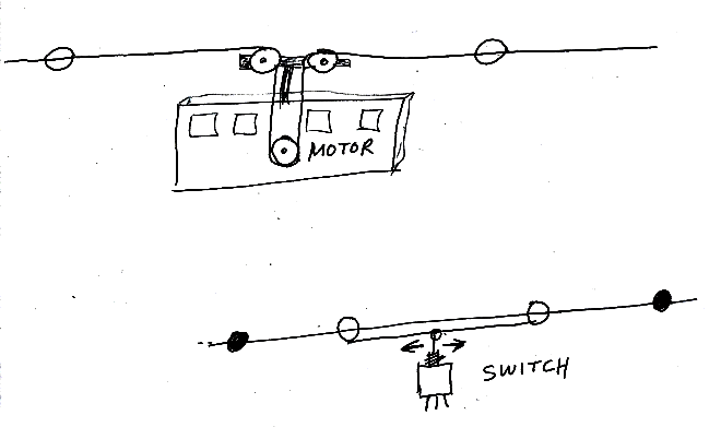

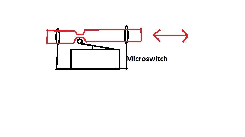

What does your cable car look like? I found this one on ebay.com and it climes a string.
The string passes around the wheels around the motor and on. On each end of the string there is a bead that indicates the end of string.
Here I added a forward/reverse switch. The switch has a rod and two hoops added. When the hoop hits the end of the string the switch is switched to the other direction.
