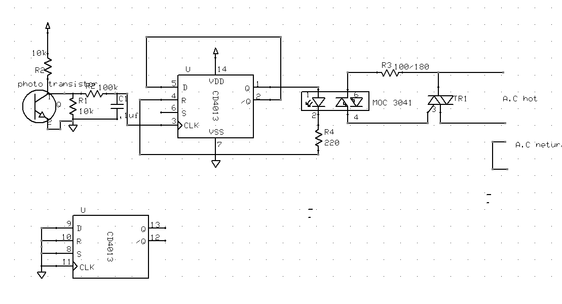

a photo cell, an ssr and a D flip flop is all the major componets needed.
a few caps, a voltage regulator into the mix
you have to have the phpto cell shielded from the light or it won't work as planned.
a simple switch debounce might trigger the the flip flop?? need to research.
my bad not a photocell
but a photo transistor
see attached schematic
use a wallwart for powering the electronics.
be forewarned this circuit should work but ??
and you are dealing with high voltage!!!
the D flip flop is a divide by two.
you pass your hand over the flip flop changes states from low to high
you pass your hand over the flip flop changes states from high to low
hope this helps
do a search and see how this works

got to thinking about the schematic I posted
might work better if the photo transistor is connected from the Vcc/clk input to ground
see attached

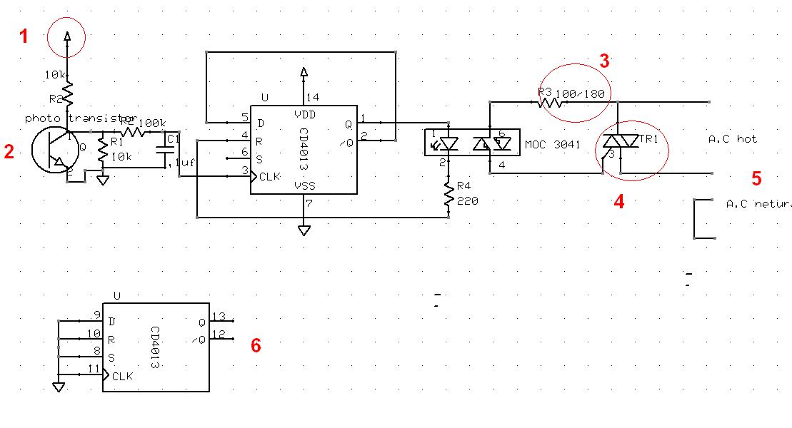

Using wikipedia and google I’ve managed to gain a partial understanding of the circuit you’ve kindly post for me. I’m struggling in a few areas however and would really appreciate your assistance with a few questions I have (I’ve add numbers to your drawing to correlate with my questions). Please accept my apologies in advance for what I assume are extremely naive electronics questions.
1. What does this symbol stand for and where should it connect to? I did an electronics symbols search and couldn’t find it.
2. What size photo transistor would I need? Would this one suffice? **broken link removed**
3. You’ve placed two values, 100 and 180 on this resistor. Which should I buy?
4. I assume this is a triac of some sort. Is there a specific rating triac I should buy?
5. I’m confused about how the AC power connects to this circuit at this point. Using a wallwart, how would the active, neutral and ground connect to this circuit?
6. Probably the most naive of my questions, why is this CD4013 out here unconnected to anything?
7. Lastly, I’ve found the CD4013 and MOC3041 chips at my local supplier I believe. Are these the correct ones?
a. **broken link removed**
b. **broken link removed**
I’m not sure if I’m allowed to post links to supplier websites on the forum. If I’m not allowed please let me know and I’ll remove them straight away.
Many thanks in advance!

ansewers to important questions
2. What size photo transistor would I need? Would this one suffice? Infrared Phototransistor - Jaycar Electronics
3. You’ve placed two values, 100 and 180 on this resistor. Which should I buy? the value can be anywhere in between
4. I assume this is a triac of some sort. Is there a specific rating triac I should buy?not really. your only switching half of your A.C. poweryour A.C. power comiong from the wall plug has 2 outputs - one is considered HOT while the other is NETURAL(but still has potiential for shock!) You only need to have the triac switch one side of your A.C. power
5. I’m confused about how the AC power connects to this circuit at this point. Using a wallwart, how would the active, neutral and ground connect to this circuit?The wallwart is for powering the electronics only. not the triac
6. Probably the most naive of my questions, why is this CD4013 out here unconnected to anything?In the cd4013 there are two seperate indivual circuits in one package. You only need one hafe of the package.
Be sure to use sockets for the I.C.'s\
As a suggestion, when your at Jaycar, see if someone there can offer assistance. You are in dangerious territory when dealing with 110/220 voltage
hope this helps
oups, forgot to address #1 question
the little triangle denotes dc power
this can be a regulated walwart unit or a battery, The electronics could be powered by a battery if you don't want to use a wal wart.

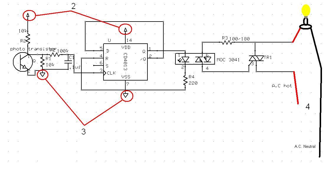

If you've the patience to humour me I've a few more questions just to make sure I'm on the right path before I attempt making this circuit - as there are a few things I've not quite got my head around:
1. Does the rating for the wallwart that connects to the sensor depend on the PIR sensor rating alone? Based on the one I linked earlier I assume it's 5v max, but what current should the wallwart produce?
2. Are these 2 points where the wallwart connect? And does it matter whether the positive goes to one or the other?
3. Are these ground connections? Or part of the D.C. power? - again, sorry for the really naive question.
4. Is this roughly how the light would be connected to the triac?
5. Jaycar don't seem to have the MOC3041, would the MOC3020 or MOC3021 suffice instead?
I've made lamps running off 240v before but have never attempted to go down the electronics route before, rather than the simple in-line switch... I'm really enjoying learning this and will be sure to have the fellas at Jaycar help me out to ensure I'm safe :)
Thanks again!

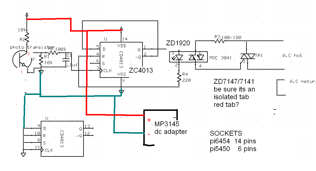

revised drawing
note, after looking at data sheet for IR led I changed the pins (see data sheet for both the phototransistor and both ic'c
the wall adapter has a plug on the end. if you have no volt meter or can't denote the + wire from the - then suggest getting a jack for the plug end.
You could buy an LED and place it across pins 1 and ground (be sure resistor is connected to led as well (just plug the LED into pins 1 & 2 of the 6 pin socket.) This you can do before connecting high voltageto your circuit.
Just to see if your electronics work as planned.
if LED dosn't light then you might have it backwards.
the flat side goes to pin 2.

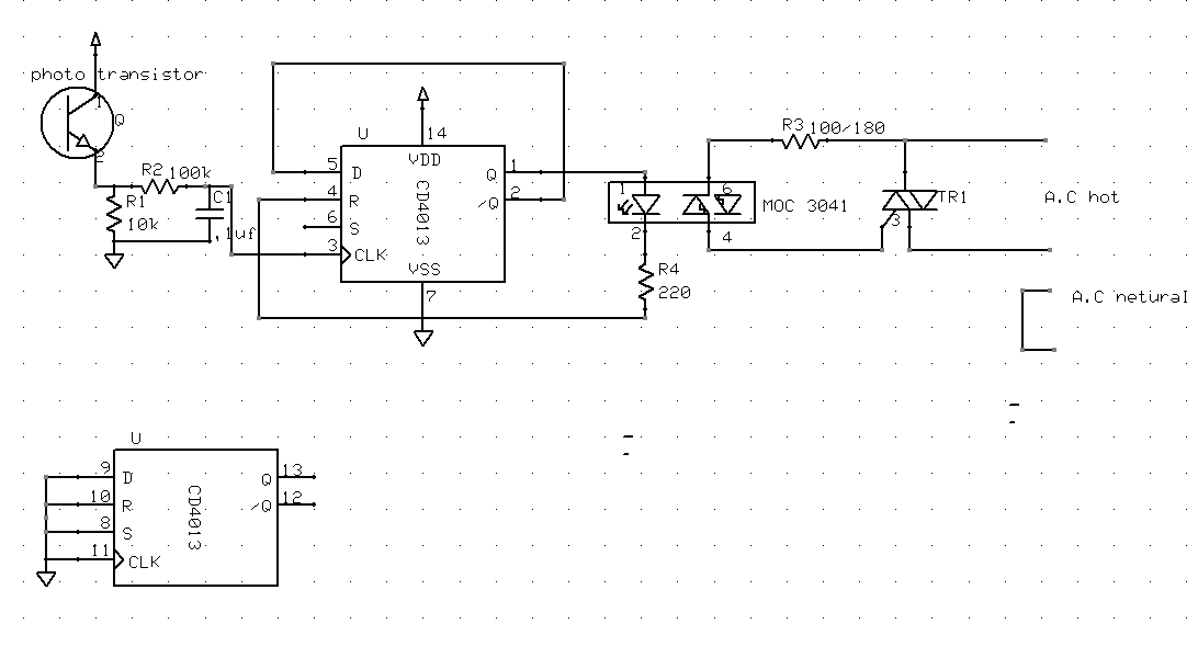

a phototransistor
is what I am proposing.
the phototransistor makes the input low. passing hand over turns off the phototransistor thus creating a high.
no need for reflection but am wondering if the IR detector will be as sensitive as a true phototransistor or perhaps a photodiode would work better?
Perhaps I could buy a few sensors that would be interchangeable should one of them not work or not be sensitive enough. Suggestions?
Just go with the phototransistor
connect an LED into pins 1 & 2 of the 6 pin socket to test before inserting the opticoupler and connecting high voltage.
