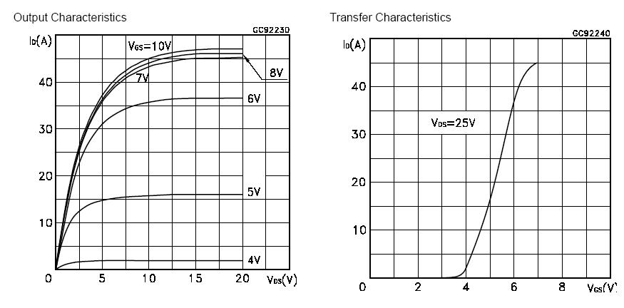

ok i just want to get this right.
Assuming if the is Vt= 2V and Vds=12V.
If i apply a voltage of 5V to the Mosfet's gate, that would mean i have already TURNED ON my MOSFET and able to get around 15A of Id current ( referring to the IV curve). Am i right or wrong?

right. If you are running your motor at more than 5v, as i said before, you can easily add a couple transistors to operate the gates of the motor switching MOSFETs at the higher voltage, which would increase efficiency. Basically the higher the voltage on Vgs, the larger the induced channel is, and thus the more the MOSFET will look like a switch.
yes, the power supply voltage and motor windings are going to determine Vds, but if you are using a large gate voltage, then a Vds of more than a volt or two corresponds to a VERY high current, more than a reasonably-sized motor would ever draw, so Vds will remain pretty low. and of course at Vds of 1 volt, you only get 1 watt per amp of current... and with a decent Vgs you should be well below 1 volt for Vds.
Got it. My current rating is about 7A max, therefore i dont think i need a higher Vgs.

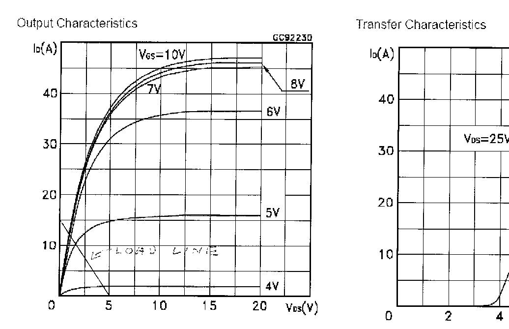

Here is how to calculate the drain current of a MOSFET with a resistive load: When the Vds is 5 volts, the current in the load is zero, so put a point on the charactisitic graph at zero amp and 5 V. When the Vds is zero, the current in the load is 15 amps, so put a point on the graph at 15 amps and zero volts. Draw a line between those points. Where the Vgs line crosses the load line, read the drain current and Vds. I get about 3 volts Vds and 10 amps current. That represents a big power loss, you would do better with another MOSFET.

I dont understand how come the drain current is 0A when Vds is 5V. Is this done practically or am i suppose to assume that when Vds is 5V, Id=0? i also dont get the Vds=0,Id=15A part .
How come there is a big power loss? Totally loss :cry:
He's assuming a 5 volt power supply... if Vds were 5v, then there would be zero volts across a resistive load so the current would have to be zero. I don't know where he's getting the 15A from... but you would want to subsitute the current value if Vds were zero, based on the resistance of your load. for instance, say you had a 2 ohm load; if Vds were zero, then the full 5v would be across the load, so I=V/R=5v/2ohms = 2.5 amps. Since it is a resistive load you can draw a straight line from the zero Vds to the zero Id points and where that "load line" intersects the curve for the value of Vgs you are using, that is what your current will be (your operating point, or Q-point, as they call it)
P=Vds*Id. at 3 volts and 10 amps, that's 30 watts of power dissipation. using a better MOSFET you can easily get a value of Vds more like less than one volt for a drain current of 10 amps, which will cut your power dissipation immensely. The more power you are dissipating in the transistor, the less power is going to your motor.
If you can wade your way through everything we've just said, congratulations... I just realized how big of a crash course you just received in MOSFETs. keep asking questions if you need help and I'll do what I can to straighten it out for you... I know this is a lot of info to absorb when you're starting from zero.
Enlighten me, where do you get the 3Vds from? I don't have my glasses on but I think that I see a value of about 1.25V-1.50 @ 10A :?:
