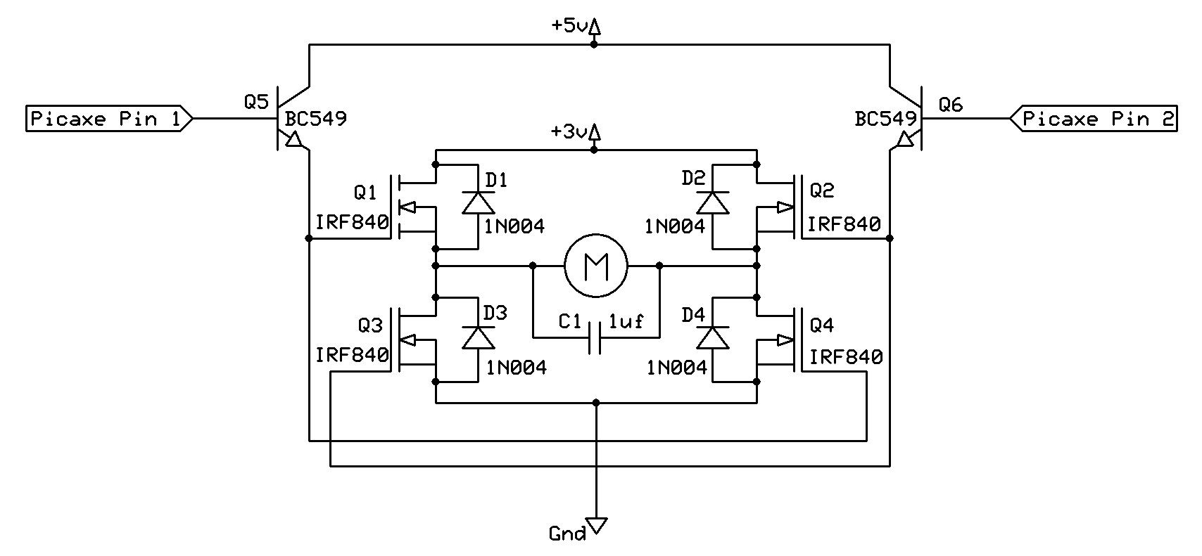

Hi I have designed a mosfet h bridge for a bot i am currently working on from parts i have in my parts bin and was wondering if it would work as i haven't really used fets before and if anyone had any suggestions on how to keep the magic smoke in. I know i probably need some resistors in there but where and what values?
Thanks in advance

Kinda hard to comment without seeing your schematic. :)
Torben
It won't work because the gate voltage isn't high enough and there are no pull-down resistors.

It depends on the switching speed, if it's just DC, i.e. you just want to reverse the motor, it's not important, just add a 10k pull-down to each MOSFET gate.
And what would a minimum gate voltage be?
Look at the datasheet to find out what gate voltage is required to pass the current required by the motor.
My guess is that you'll need to increase the voltage ot Q5 and Q6 to 12V and you'll need some additional level shifting to enable the PIC to control them.

You need to look in the notes for the Rds(on) parameter and see what voltage they used to determine it. In your case it's 10V (which is typical of most MOSFETS) above the source pin. You will need a bootstrap supply to drive the high side FETs, or they will not turn on properly. It would be easier to get some actual MOSFET drivers at this point, as it will make the entire h-bridge much more functional and stable.

Why are you using a 500V MOSFET to drive a 3V motor?
There's nothing wrong with overrating components but higher voltage MOSFETs have a much higher drain resistance than lower voltage MOSFETs. Use a lower voltage MOSFET such as the IRL540.
You still haven't said what current the motor requires?
If it's <1.5A you'll be fine with a gate voltage of just 5V (see figure 6 on the datasheet) but that still means the gate voltage on the high side needs to be at least 8V, relative to 0V, because the motor is 3V.

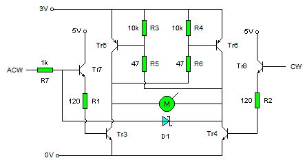

See attached.
NPN transistors = BC548
PNP transistors = BC327
