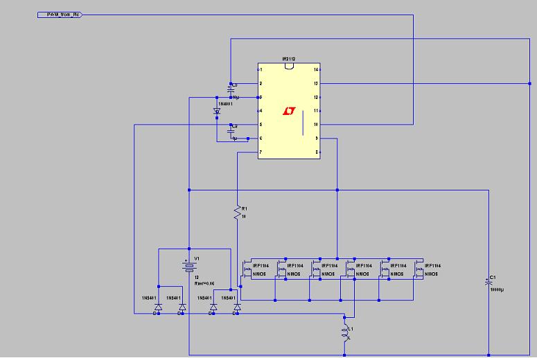

Hi all,
https://www.ortodoxism.ro/datasheets/irf/ir2112.pdf
i have this thing in stock, what i want to do is to let it control 6 fets (IRF1104 , N channel) in parrallel (the gate) wich are in the high side configuration.
also the low output needs to control 1 fet (for a bit of regen braking).
Input voltage will be 12/14volts. (car power).
The chip has some pins i have no idea what to do with them.

also there are caps / resistors drawn can anyone help me a bit?
with their values or simple explain me where there are for?
In the heigh side configuration we need more gate voltage then suplly voltage right??
Hope you all can help me abit with some values to test it with.

I think you should at least try to understand the documents instead of following the pictures. As zevon8 said if something goes wrong you won't have a clue how to fix it unless you do some legwork.
VSS is the pin that is conneced to Logic Ground
VCC is a positive supply voltage to which the gate of the lower MOSFET is pulled, called the low side supply
VS is the voltage on the Source of the upper MOSFET, called the high side floating supply return.
VB is voltage which is generated on the chip to drive the gate of a high side N-channel MOSFET to a voltage above VS, called the high side floating supply.
Right there on page 4 of the datasheet, underneath the functional block diagram, is a description of the pins. If you're having this much trouble then I strongly suggest you switch to a simpler project and learn to crawl and walk before trying to do the iron-man tiathalon.
Incidentally, IGBT's are crosses between Mosfets and BJT's - typically used for high voltage devices. Personally I've never used them...
So the general idea is that to turn a N-channel mosfet on, you need to put a positive voltage on the gate. Ignoring some of the finer details - the higher the voltage you can put on the gate, the lower the resistance of the mosfet. Obviously check the data sheet for the max gate voltage (Vgs). Exceeding this voltage - typically ~20 - 30V even for a nanosecond will cause the mosfet to fail, usually by short-circuit and lots of smoke. The gate has a capacitance of ~1 - 10nF which is large considering how fast you want it to change between on and off - which is why they make dedicated gate driver chips.
So if you look at the internals of the IR2112, you can see what it does is connect the gate of a mosfet to either a positive voltage or to it's drain - on or off. I assume the lower mosfet is pretty self explanitory - the tricky part is the upper mosfet. If you want the upper mosfet on, you need to connect it's gate to a voltage that is ~12V (or whatever your Mosfet rating) above the load supply - in your case 14+12V. The usual way of doing this is with a "bootstrap" capacitor and diode connected to the switched node - check pg 15 of the design note. One very important thing to keep in mind is that this bootstrap approach will only work if you are PWMing the signal. If the PWM signal ever disappear, or there is some delay on startup, those upper mosfets may suddenly overheat as they turn partially on and dissipate a lot of power.

Ok,
I'm designing the scheme with the Free LT spice program.
I was thinking isn't it easyer to convert 14volts to 10+14 = 24volts????
shouldn't that do the job instead of the bootstrap?
Tks

The decoupling/boost caps look reasonably sized. If you want to supply an external bootstrap voltage, just plug it into Vb, and reconnect the 1uF between Vb and ground so it can decouple the 2-3A current spike that will happen when the mosfets turn on.
If you do decide to just keep the diode/cap bootstrap configuration, just read through what I wrote before about not having the lower mosfet. It may work sufficiently well with out it for your configuration, but you'll need to test it out.
I can't make out the diode ratings, but they're in the right direction. You should also clamp it to ground as well - hypothetical question: what happens when the motor terminal spikes down to -20V with the gate being held at ground?
If you go through the data sheet and app notes, the only other thing might be to put 6x ~100 ohm in series with each of the mosfet gates to prevent some high frequency oscillations. Otherwise, using the gate driver chip is about as easy as it is going to get.
James
Ok, sow in fact i could better eliminate the diodes and fit 1 mosfet?
problem is that i need/don´t want overlapping of the mosfets because then the lower one will be burned out quet easy....not?
Will fit 2 to ground and 2 to vdd if they blow i will fit more??
they are huge! will try to add as much of them as i can.
the gate part i don´t untherstand what would you do? thats in fact what i need to know...

Correct, if the circuit tries to brake with the motor spinning at a good clip, it could burn out - but I'm also saying that without a mosfet there, the upper mosfets may not turn on fully when you approach no-load speeds. If the motor is always moving relatively slowly (back-EMF is low), the circuit should be okay as long as the PWM signal is present.
Are you talking about the diodes?
They need to be sized so that they can handle the voltage spikes that happen when the mosfets switch. The average current they need to handle is relatively small. A "1 Amp diode" might have an instantaneous current rating of 3-5 Amps, so read the data sheets.

Ok, i wanted to fit 4 3amp (rated) diodes.. but if i hear you than i should be done with 2 of each in both direction right??
Can i eliminate the resistance of 10R?? i don't have a 10R with significant wattage...
guess its 1/4 or less.. :(
Tks
p.d. the circuit should be able to do a full motor start with load on it.. i don't have a overamp limit built in because of the reason that fitting resistor in the feeding line with a starter as consuming doesn't look wise... also because i will limit the max rpm/amps with the max pwm the controller feeds...
anyways 6fets of my size should give me 600amps continous and 2400ams pulses sow i gues it should be quit bullet proof also i hope that the amd cpu cooler will let the lot stay cool.
is it a trick if i fit a 27volt zener from the motor to the 1uF cap??
it would need to stay open when the cap doesn't has de 27volts on it...
sow in fact i though of charging the cap with the back emf of the motor?????
maybe a diode to prevent to blow the chip? before the pin?
