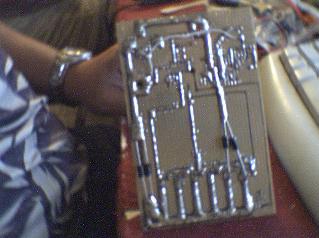

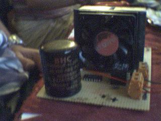

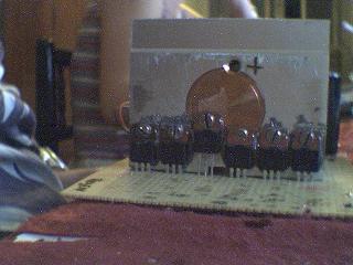

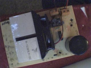

Mosfet driver IR2112 help needed
I'm now realising that the only reason for me to use this chip is that its for purposes of positive feed to the N channel Fet..
Is it possible to fit a bootcap to a normal driver for example the 9amps TI one i earlier posted??
Tks
some pics to!

okay, where to start...
The diodes should be more than sufficient.
Can i eliminate the resistance of 10R?? i don't have a 10R with significant wattage...
Mosfets have capacitve gates - there is only current going through that resistor when the mosfet turns on and off, otherwise there is no current going through them, and I'd expect acual power dissipation in them to be in the milli - microwatt range.
anyways 6fets of my size should give me 600amps continous and 2400ams pulses sow i gues it should be quit bullet proof also i hope that the amd cpu cooler will let the lot stay cool.
Considering "0000" copper wire (i.e. 1/2 inch or 13mm copper rod) is rated for 400amps, and I don't see any of that, I'd expect the realistic rating is a bit lower...
sow in fact i though of charging the cap with the back emf of the motor?????
maybe a diode to prevent to blow the chip? before the pin?
? the back emf from the motor won't cause the voltage on the capacitor to increase (by much). If the motor is being forced to turn externally, then you'll need to worry about over-voltage.
If you mean: "The only reason to use this chip is to drive a high-side FET", then yes, that would be it (and a good reason as well). You can find less capable chips, and might be able to save ~20% of the cost of the chip or something.
i was studing the datasheet and i saw that COM = low side return, the above pic its just ground..(page 1)
watching at VCC its Low side supply is it true that bove are for me ground?? how the hell that cap can then charge it self??
This chip has two *different* sections. One side is built to drive a low-side mosfet, the other side can drive a high-side mosfet. The low-side mosfet is easy to drive and doesn't need the bootstrap capacitor or diode. The high-side on the other hand -
The idea is that when the high-side mosfet is off, the motor terminal will be at ground. At this time, the capacitor will have 11.4V across it (because of the bootstrap diode). When the high-side mosfet turns on, the motor terminal will be at 12V, the capacitor will *still* have 11.4V across it, and the upper capacitor terminal will be at 12+11.4=23.4V, which is enough to turn the mosfet fully on.

Have soldered a bit more Pb on the strips to the fets... to make sure they are better balanced... my old soldermachine couldn't cope with the heat (think because of the heatsink)
but i'm sute uts quite balanced now..
is the lower one cruisucial??
Tks

Ok, i have hooked up everything cables where prepared terminals where put on. Have brought some 4mm dia cable..
Ok, first i connected it all up to the battery a small spark occured the 10.000uF cap charged.
Then i prepared the gearbox program to work with the reverse controller.
I made a small test program wich puts some pins high and wich outputs a PWM signal to the board.
First thing i noticed was that the relais didn't switch sow i guessed that the transistor was wrong, changed the transistor and it worked.
Sow at least when i select reverse the universal relais is activated, the fan will start blowing, the reverse light on the car will light up, the starter solenoid will be meshed up with the gear ring.
Anyway that point i reached... then i tested the mosfets...

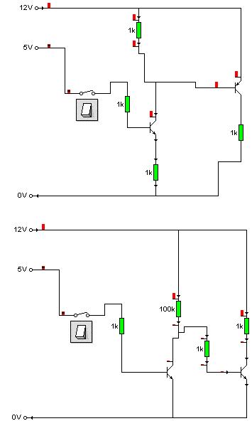

Well Fase 2 Succesfully ended!! BUT one small side is that the chip needs 8,5 / 9 volts minimum input voltage!! on the HIN pin!!! thought it was TLL compatible but it isn't sow! there is a solution needed to convert 5volts in 10 volts..
The good news is that when i manualy tick the HIN pin to VDD (12volts) the bulb iluminates!! on full brightness altough i have to say that it automaticly shutsdown but when i tick fast its clearly to see that it iluminates more then when only applying 12volts to the gates sow almost don would i say and then we can try the motor!!!
can i convert this with a NPN transistor?? or do i need a PNP one?? or just an opamp (more hassle??)
Tks
Well wich of the 2 cant choose :D wont make a huge different i guess :D
Don't want to use a opamp because i have limited room...
I made the 2nd one because i think i don't have a PNP in my toolbox sow basicly i just made 2 invert setups but feeded the resistors with 12volts..
TKs
Tks
It *does* support different threshold voltages. Connect Vdd to the logic power supply(5V) and leave Vcc connected to 12V
