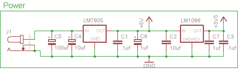

I will thanks. Also can someone tell me if this is good. It seems to have alot of caps but i think its worth it to get nice clean voltage. I might add a inductor or 2 to stabilize the current. Something small perhaps.
power-png.24625
I dont know how to calculate the uH needed for the current. Any thoughts?
