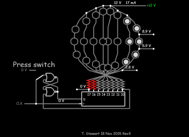

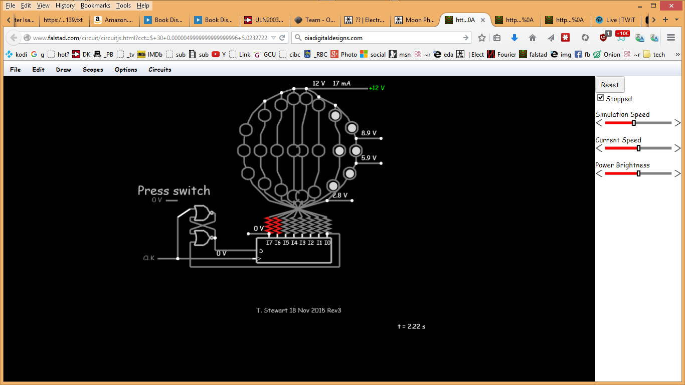

You might like my 16 phase Lunar Design, which you may cut in half and move feedback from 8th to 4th stage.
https://www.falstad.com/circuit (enable Java and press switch)
Edit: keep in mind 74HCTxxx uses very thin gold bondwires and Power or ground current is 50mA max. chip power is minimal with low ESR, but 220 Ω works well with good 3V White LEDs to 5.0V using <7mA per port with all 8 ON., but if you want full 20mA per LED then use ULN200x hex driver. ( but only 7 port)
If you block the light from left to right and use as a backlight using WHITE LEDs and crescent slots in front of each LED ( with heat shrink, diffuser film and cutouts) onto a large rear film image of the MOON .... you can show all the phases exactly as it would appear to enhance the effects.... and of course show the sequence from right to left as we see it .
Design Time: 30 minutes.

Notice Rather than an individual LED per phase, mine shifts like the light reflected off the Moon where you can choose 8 Phases with 4 LEDs or 16 phases with 8 LEDs as you may prefer for Backlight Suggestion to Film image of MOON, which would be kewl. :) or laser printout on transparency or paper. For even brighter Illumination consider running the SIPO off 5V but the LEDs off 12V using PC PSU but then you need two extra vertical Series White LEDs so that the LED string is 9V and when VOH=5V with Vled=12 the LEDs are OFF with 7V across a string of 3x3V LEDs or 2.33V per White LED. :cool:
Then you have 24 White LEDs total in vertical Strings of 3 and 1/8th phase increments fading from Right to Left with FULL MOON having all 8 LEDs ON and NEW MOON will all OFF. I suggest LEDs with 30 deg Warm White 10 Cd. min @20mA but using only 2.5Cd at 5mA. Can you choose these? If you have 12V WHite StripLeds, this will work too from 5V logic output to (-) side with (+) to 12V... Note if you do this with 3 LEDs and no Series Resistor per string, you may damage the Drivers.

Notice in the animation on Tony's site that the light pattern is different from my circuit. Because of the way a 4017 works, only one output at a time is on. As the counter is clocked, the ON output steps through the 10 possible pins. This is basically the same as one possible output pattern of a shift register. Tony's output is another possible pattern, where all previous outputs are either on or off depending on which part of the cycle you are in. In terms of a group of 8 lights, his better mimics the way the moon looks. But if you have 8 little backlit signs, then you want only one sign on at a time the way the 4017 works. The point here is that these are not two different ways of doing the same thing; they are two different types of display effects. Your choice.

"For even brighter Illumination consider running the SIPO off 5V but the LEDs off 12V using PC PSU but then you need two extra vertical Series White LEDs so that the LED string is 9V and when VOH=5V with Vled=12 the LEDs are OFF with 7V across a string of 3x3V LEDs or 2.33V per White LED. :cool:
Then you have 24 White LEDs total in vertical Strings of 3 and 1/8th phase increments fading from Right to Left with FULL MOON having all 8 LEDs ON and NEW MOON will all OFF. I suggest LEDs with 30 deg Warm White 10 Cd. min @20mA but using only 2.5Cd at 5mA."
UMMMMMMMMMM...I think this may be past my comprehension...my brain hurts:wideyed:
complexity vs simplicity vs features
12V power to 12V LEDSTRIP (+) Anode of 3 White LEDs (~3x3V)
5V power to 74HCT164 with output to Cathode (-) of string. using Output driver= Low (<0.5V) when ON.
Reverse direction of layout so shift from right to left. ( sorry about the mess)
16 clock pulse per Lunar Month
Rs external >= 270 Ω per string. chosen for VOL<=0.5V and If= 7mA max per string.. You may also use 330 Ω to 1K for even lower current using 12V with 3S string of Warm White.

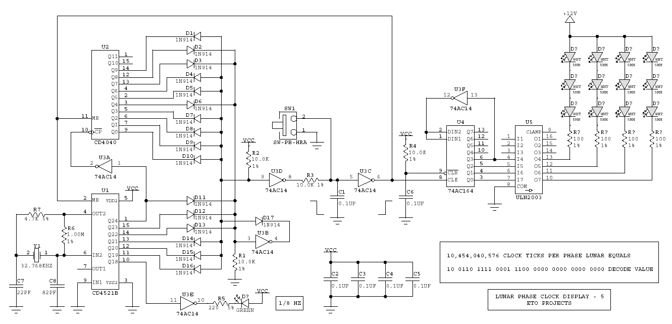

There is not true consistency in the labeling of multi-bit counter outputs. Some, like the CD4040, have outputs labeled Q0-Qn. Others, such as the CD4521, label the first divider output Q1 and go upward from there. So for this part with a 32 kHz clock, 1 pps or 1 Hz appears on the Q15 output. Unfortunately, because of a limited number of device pins, Q18 is the first available output, equating to 1/8 Hz (4 seconds on, 4 seconds off).
It looks like I might have the decoded outputs shifted from their correct positions. I include the most significant trailing 0 in the decode value, and I think it threw me off. Checking...
And, shifting (!) to a display with 16 phases (8 waxing and 8 waning) means shifting all 17 decoded counter bits one position downward on the schematic, the equivalent of dividing the decoded reset value by 2 for twice the output frequency.

Here is an updated version of the schematic in post #19. This has Tony's shifting output display for the originally requested 8 standard lunar phases, 4 waxing and 4 waning. The shift register requires an extra inverter. Changing to a hex inverter and dropping a superfluous decoded bit maintained both the chip count and diode count. A power-on reset purges the shift register, and the switch makes it possible to set the clock at the start of any phase rather than waiting for a full moon.
I think balancing the logic and LED voltages based on the LED Vf is a bit tricky for the OP (based on the experience level in his questions) and reduces greatly the selection of workable LED types. With the 2003, or discrete transistors, the display devices and brightness levels are independent of the logic, the supply voltages, etc.
Note that by adding strings of LEDs to the shifter output and adjusting the decoded reset value, you can have any arbitrary number of phases per lunar cycle.

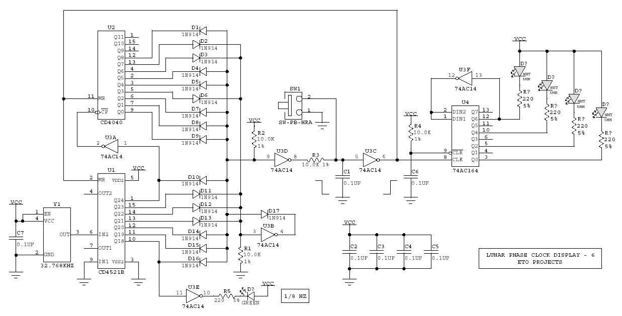

OK, I think we're getting to the end. Here is version 6, with an integrated timebase oscillator, single-LED outputs, no LED drivers, single 5V supply, etc. Note the spacing of the shift register outputs. I adjusted the decoded reset value so the shifter now moves twice as fast (only 5.2 billion ticks per shift register clock pulse). Using every other output gets you the original 8 phases. If you want the higher resolution display as in post #32, use the disconnected pins and more LEDs.
Note - the individual inverters are interchangeable. You can reassign them to make the wiring easier.
