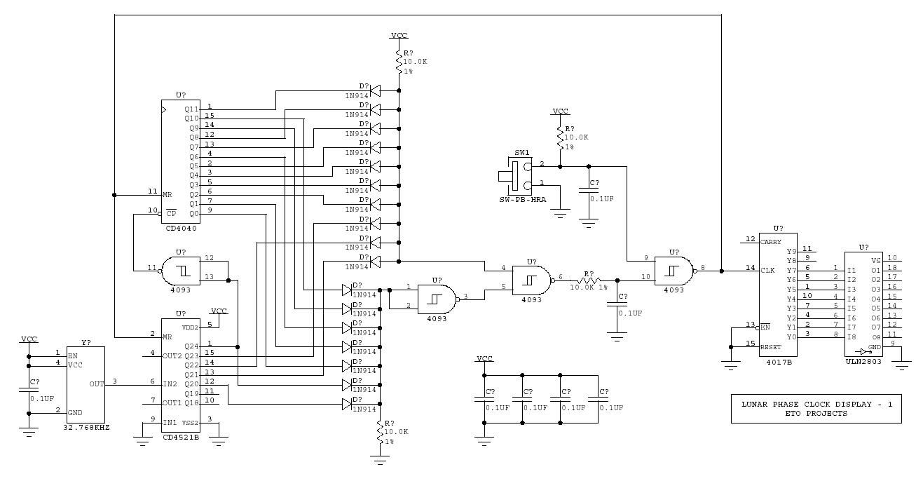

Here is one approach. To count down a normal crystal frequency to a 3.7 day period takes 34 stages of binary counters. That's two chips, plus some decode logic.
1 CD4521 - this is a 24 bit counter that can work with a 32.768 kHz "watch" crystal. Only the last 7 bits are available, but that's enough for reasonable precision.
1 CD4040 - this is a 12 bit counter with all bits available.
19 small signal diodes like 1N914 - these are used to decode the counter state that is closest to the correct period for one phase.
1 CD4017, drivers, and LEDs to make the phase display.
One moon phase lasts 319,032 seconds, and one second is 32,768 counts of the crystal oscillator stage. So when the counter reaches 10,454,040,xxx (decimal), that number is decoded and used to reset the big counter and increment the 4017. This is about 80% of the overall counter's full range. It's not as scarey as it might sound, and it is more stable than either phase locked loop (PLL) or direct digital synthesis (DDS) techniques. Decoding only the top 19 bits of the 34 bit counter adds 4 seconds per month to the system error budget.
EDIT: Here is an updated schematic with full decoding and decoupling, missing the displays. For the decoded binary value that equals the transition of phases, the upper group of diodes connects to the ones and the lower group connects to the zeros. The decoded output of large ripple counters usually has some small glitches caused by timing skew in the bit transitions, so this circuit has an RC filter that also acts as a pulse stretcher for the advance/reset signal.
ak

Well...HOLY CRAP Analogue.. once again you truly are amazing...its a simple, elegant design
Just 2 questions:
-can the output just go to switching transistors...like 2n2222's to drive the leds?
-is The oscillator is just a stand alone unit, such as:
ABRACON Oscillator 32.768MHz 5V HCMOS ACO-32.768M, DIP-14,
Thank you for all your timer and effort.
1. Yes. The 4017 can source about 2-4 mA reliably. This can drive directly the gate of a small MOSFET like a 2N7002, or a small NPN through a gate current limiting resistor. That's essentially what's inside the 2803, without having to connect all of the individual parts. But if you've got the discreets, go right ahead.
2. I show a stand-alone, integrated oscillator because that's what's in my design library. For less cost you can hang a 32.768 kHz watch crystal and two capacitors on the 4521 (it has the electronics for a crystal oscillator built in). Note that most integrated oscillators run on 3.3V or 5V, while the rest of the parts are true CMOS and can run on anything up to 18 V.

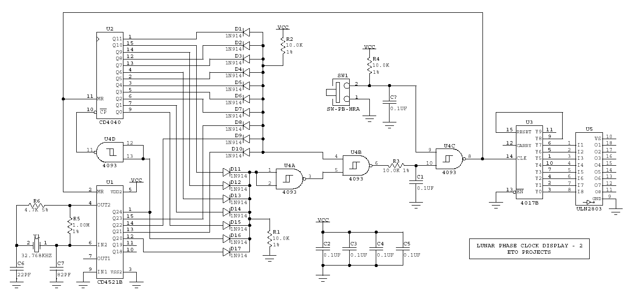

To set the clock, pressing the switch advances the output one phase and resets the timer. So, for example, if you want the phase display to change at midnight of the transition day between phases, or noon of the peak day, that's when you press the button.
NOTE: I just noticed that I left out the connection between 4017 output "8" and its reset input. Here is a corrected schematic that also shows a crystal connection.

Thanks so much Analogue, once again....this is truly a beautiful circuit.'
Is there a way to expand the output of U5, as the phases reverse after a cycle, not start over again at one,
(Im not certain how to explain this)
for example, the first cycle is:
1 2 3 4 5 6 7 8
The next cycle is:
8 7 6 5 4 3 2 1
Could this be done by just cascading U5 with another 2803, and adding some diodes to all the outputs to steer to the appropriate LED??
Thanks,
Kim
Yes, there is a way to do that. But last time I checked, the lunar phases haven't reversed in a very long time, as in never. Is this for something other than a lunar phase display?
