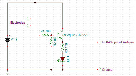

This circuit will feed the RAW pin of the Arduino - a better method of control when using an NPN transistor as a switch.
You might have to play with the value of R1. Don't forget that the conductivity of the "moisture" will greatly affect the performance of the transistor "switch".
And there is no real need for R3 and the LED, since the Arduino already has an "ON" LED.

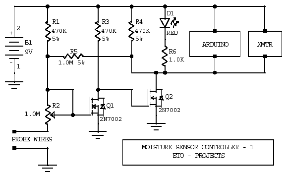

Is the arduino modulating the transmitter with a data pattern or message? If not, you can key the transmitter on and off with one 2N7002 transistor and a couple of resistors.
ak

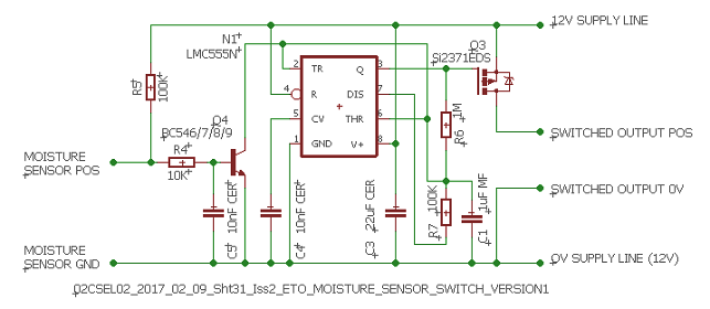

POST ISSUE 11 of 2017_02_09
Hi IBW,
Below is a circuit for you to consider.
spec
ERRATA
(1)
CIRCUIT DESCRIPTION
(1) The circuit uses no microcontroller, although a microcontroller can be switched on in addition to the RF transmitter.
(2) If no moisture is detected, the PMOSFET is turned of and the circuit consumes only a few micro amps.
(3) When moisture is detected the PMOSFET is turned on for 100 mili seconds and off 1 second (to save power).
(4) The on period is set by R7/C1.
(5) The off period is set by R6/C1.
NOTES
(1) The timing capacitor C1 is a metal film type.
(2) Unless otherwise stated all capacitors are ceramic X7R dielectric +-10% or tighter, 25V or higher.
(3) R5 is nominal and may need to be adjusted to suit the characteristics of the moisture sensor.
(4) The 555 timer is a CMOS type for low current consumption and enhanced performance
(5) All resistors are metal film, 250 miliwatts or higher, +-5% or tighter.

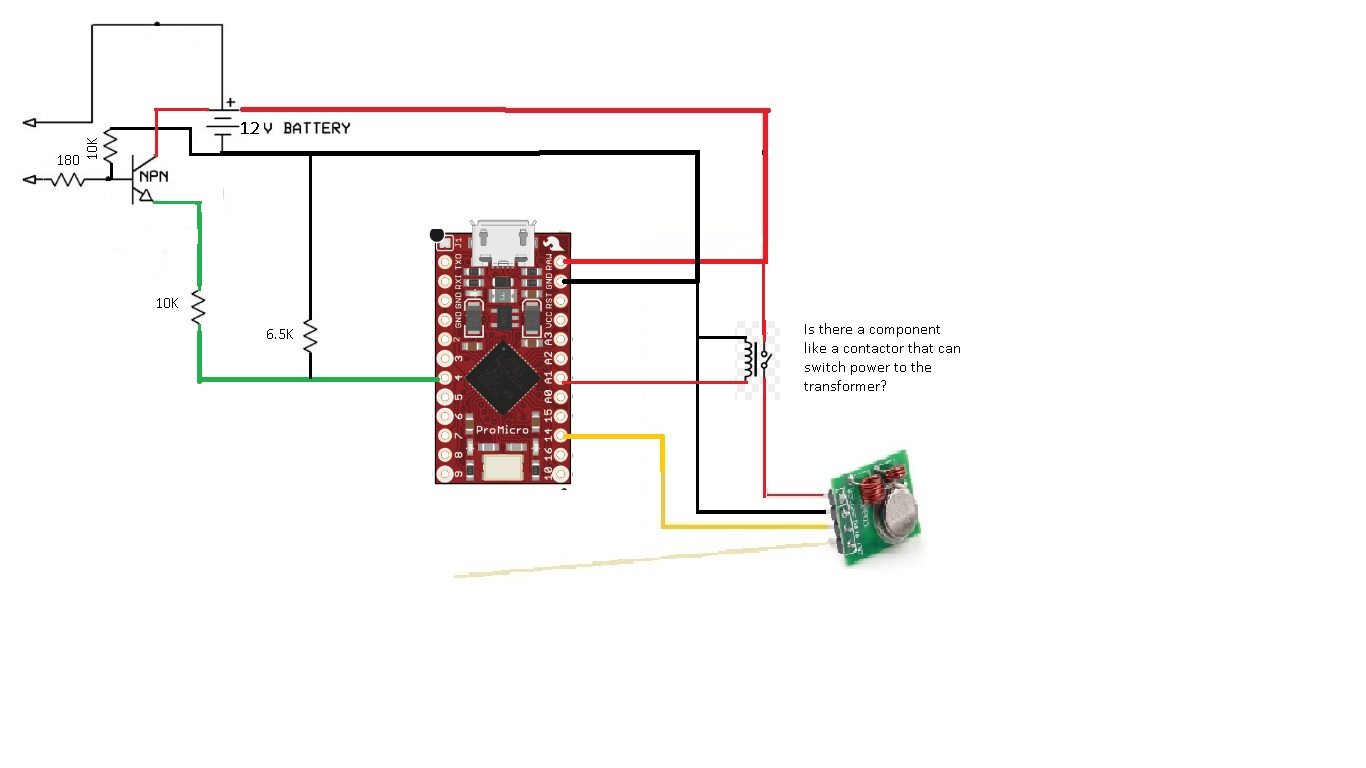

Is there a component similar to a contactor that might can toggle the power to the transmitter?
1. In your first post you had the sensor transistor switching power to both the arduino and the transmitter.
2. In post #16 the arduino is powered constantly, the sensor transistor sends a trigger signal to the arduino, and the arduino switches power to the transmitter.
Either way will work, but having the arduino powered all the time will run down the batteries much more quickly. Which way do prefer?

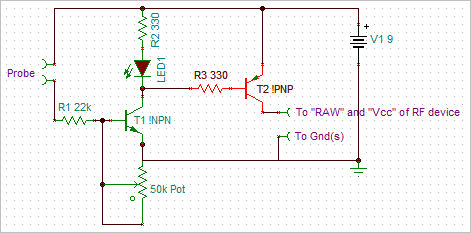

Here is an update to your schematic in post #1. It adds a 2nd transistor for better switching action. This circuit draws about 20 uA when dry, so the battery life should be pretty good.
ak

Let's go back to your original circuit and add a simple modification (the components in RED):
I simmed the original circuit (from Post#1), using resistors of various values(up to 0.5MΩ) as substitutes for varying conductivity, and the original circuit (somewhat to my surprise) worked quite well. The circuit was most sensitive near the "0" position on the 50k pot device above.
The 433mHz xmitter only draws about 40mA but I have no idea what the ProMicro draws. Not sure why LED1 is needed. Just seems like wasted power since the ProMicro has an LED. If removed, replace R2 with a 4.7k resistor.
The life of the 9VDC battery is unknown for this circuit.
