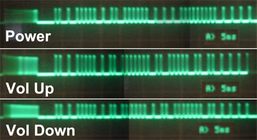

There are plenty of tutorials out there to learn ASM from. Nigel’s site is a good source (has the software and circuits to go with the projects). I’m attaching the source for the IR transmitter I was working on, its pretty simplistic if you want to try and work though it. It was my first project written in ASM in a few years. The programming is probably crude and is defiantly a dumbed down version of Nigel’s IR transmitter but it works. The carrier signal seems to be a fairly precise 38 kHz even when using the 4MHz internal oscillator. My particular remote (for an orion TV) seems to send out a 32 bit packed. I captured the signal from the remotes with a camera and pasted them back together. The two signals labeled Vol up and Vol Down are actually Channel up and down. Guess I was pushing the wrong button while I was capturing the signal and didn't find out till I got the whole thing working and the stations started changing instead of the volume.
