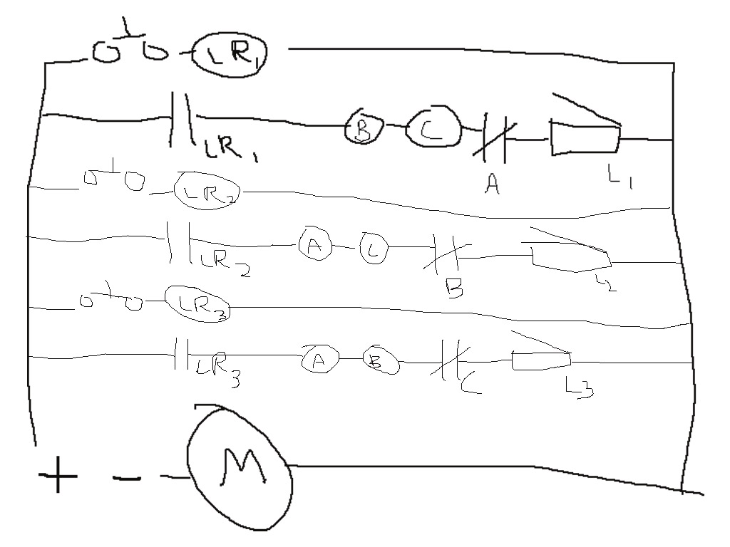

I did come up with a circuit using only relays, but I am unable to control the direction of the motor. Can anybody help me?
How many relays did you use?
This is what I managed
I intend LR to mean latching relay, or a relay that latches the button press.
I don't even know if it will work.
It is pretty messy as i don't have a scanner.
Your diagram is not an electronic schematic but more like a PLC Ladder Logic diagram.
How do you reverse the motor?
Try downloading and installing the free 30 day trial of Electronic Workbench and you can build it virtually before you assemble the real thing.
With only 3 days left you better hurry.

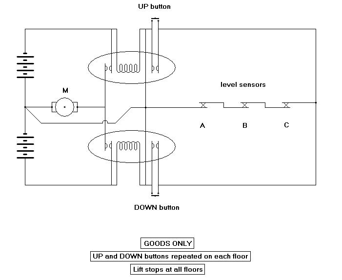

After drawing and discarding many attempts,
i have come up with this.
Its only an outline, it needs some additional work.
Maybe opening contacts at the upper and lower points
to prevent the 'UP' relay being engaged with the unit at the top.
And similar at the bottom,
to prevent the 'DOWN' relay being engaged with the unit at the bottom.
Also i dont like the two N.O. contacts across the supply, i would
like to put in extra contacts to reduce the likelihood of shorting.
Or rearrange the circuitry.
However, it looks workable, but only as a 'Goods' type unit.
Making it miss out floors, and including buttons in the lift
starts getting very complicated.
Best of luck with your efforts,
John :)

Hi shashankhr,
Thank you for your appreciation, it took me three days.
And i realise it does not meet what you want, i put it forward as a possible basis for including extra circuitry.
You may not need flip-flops, you may only need bi-stables - which are easier to drive.
I assume that you would want them as 'memories' or just 'flags'.
A short 'wait' period would also be needed i think, so that the lift can then respond,
to a call from another floor, after completing the call in progress.
The arrangement i posted (# 45) uses simple 'make' press buttons for UP and DOWN,
these can be paralleled up and extended to the other floors. The thing i could not see an easy way to perform, is the operation of 'going past a floor' to answer a call more than one floor away. There might be an easy way to do this, but i havent seen it yet.
If you can see a way to do that, then i think that will meet your request.
With only three floors, such a call can only come from the top or the bottom.
It might be possible to include two relays specifically for those two eventualities.
The arrangement 'as-shown' is extendable over as many floors as you like, but as said- it would stop at each level.
It would no longer be extendable in that way if such special purpose relays were included for the middle floor of a three floor set-up.
I dont really see adding buttons for each floor as a problem.
I have tried to see an arrangement using relays, because they are easier to understand for many people, but i cant see an easy way to meet your spec.
I think that your best way would be to sort out a micro-processor driving a motor, and fix up three sensors to drive the micro-processor.
Then ask nicely for someone to help with programming it.
Or maybe such small programs are aready downloadable from somewhere.
Given your limited time, and limited experience, i really think this is your most likely route to success.
Fixing up a small microprocessor and giving it a program to run from press buttons to call the lift, and sensors in the lift shaft is something that can be done in the time available.
I would be interested to hear from others, whether or not they agree with this approach.
Best of luck with your project,
John :)
