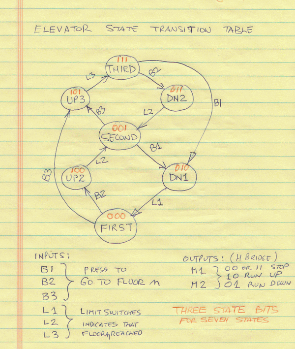

I am in the 10th grade and am going to do a project for a science expo/competition. We have to build a model elevator with a minimum of 3 floors. There has to be a button for each floor(Not on each floor). The cabin has to stop only at whichever floor it is asked to go to, without stopping at the intermediate floors.
We have been given a DC micromotor rated 12 volts, a 1 inch pulley, 2 2inch pulleys and 3 shafts. We can use more pulleys if needed.
We are allowed to use ICs, but no PCBs. We can use sensors, microswitches, etc.
Please give me a circuit diagram so i can attempt to make this project a success.

The elevator can initially be stopped be on any of three floors. If the button for the floor it is already on is pushed, nothing happens. If the button for either of the other two floors is pushed, the elevator goes to that floor in the correct direction and stops when it gets there. If it is at either end, it will only go in one direction.
What happens if another button is pushed while the elevator is moving?
Can you use relays?
I don't think we have to worry about another button being pushed when the elevator is moving, but if anything can be done to ignore the push, or take it into account and move, it is good.
It is perfectly alright to use relays
Can anything be made so that it can handle more than 3 floors? More the number of floors, more the points.
Here is a State Transition Diagram which I think implements your requirements. There are a total of six inputs, three Buttons B1,B2,B3, and three limit switches mounted at the parked position for each floor L1, L2, and L3.
There are seven states, where the elevator is stopped at FIRST, SECOND, and THIRD; is moving up during states UP2 and UP3, and is moving down during states DN2 and DN1.
It takes three flip-flops to represent seven states (with one possible state unused). I have assigned state values so as to make them easy to use to control the motor. Note the bit pattern 100 and 101 occurs when the elevator is moving up, while 011 and 010 occurs while the elevator is moving down. 000, 001, 111 occur while the elevator is stopped. If you look at the leftmost two of these bit patterns, they can be used to control the motor directly, where 10 means up, 01 means down, 00 or 11 means stop.
