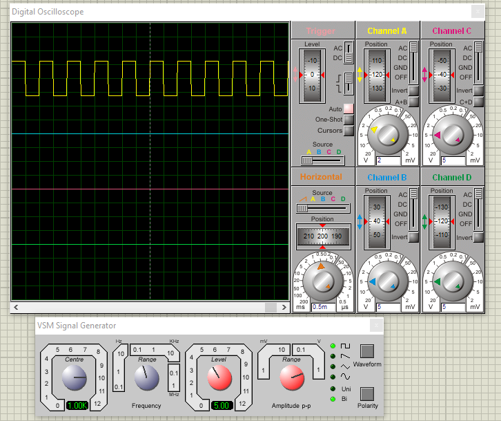

I have a knight ml2010 mini-lab and a Tektronix tbs 1104 oscilloscope, I am a student at Devry for my bachelor's in electronic technology and I am doing a lab and the time setting on the lab sheet got me confused because when I set the time on the scope the waveform I have set goes almost out the screen can anyone give me some pointers so I can finish this lab
What time base have you set?
Where is the horizontal trigger set? ( small arrow on the top of the display )
I have a lesser scope, but some time bases do not have a horizontal trigger, but these are 100ms -
One of the time base sets is 50ns/div, 0.5ms/div and 200ns/div so I move the arrow at the top of the screen and not the horizontal on the bottom
There are two triggers... It sounds like your wave is partially off screen... Are you new to oscilloscopes??
What frequency ( ish ) are you trying to watch... Can you post a copy of the lab question so we can help you select the correct settings..

This is a 5v 1Khz signal on a time base of 0.5 mS set to 2v/div
Is this what you see..

something like that but on my scope where do i set them setting at at the bottom of the screen or use the arrows
If you can see 10 pulses on the screen when 0.5 V/div is selected, then it represents 1khz..
Ian, I think you are mixing up the axes?
