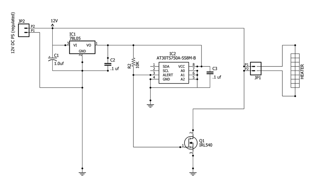

A while ago there was a thread that included a thermostat/heater for an incubator. I still do not know where the schematic came from, but I had the feeling that it was from a few years ago. I was thinking about it and wondered if I could do "better".
Here is what I have come up with so far:
So far, I have only bread boarded it.

Very simple.
Not sure about the fet drive, is the chip o/p open drain pull down, and the 10k a pullup?, if so switching time will be slow, 1k might be better.
Very simple.
The temperature sensor is rated at 4 mA, so 1k is a marginal overload. I don't see any reason why slow switching would matter. It'll only happen every few minutes.
I don't see any need to regulate the 12 V.
Appreciate the comments...working on it right now...
Glad to see you notice that. I looked long and hard to find out how much current the Alert pin (which is open drain and with programmable polarity) could sink. I too saw the testing specs at 4mA and figured...well I know it can do that...and I actually worked on the programming using a pulup resistor and LED connected directly to the alert pin so I could see the behavior of that pin.
As for the 'regulated', well I put that in the schematic because I am using a 12V lab bench supply, which is regulated. I suppose I would use a larger value for C1 if the 12V PS was 'less' regulated.
I also thought about using a zener with a 390 Ohm, 1/2W resistor for the 5V source to the chip. It draws so little.... I did some homework on the issue because I have often read that zeners as regulators can be problematic. After a good deal of reading (like here), I was all set to use one but changed my mind because 5V regs are so cheap and easy, I couldn't see how a zener would be 'simpler'.
The sensor is nice. When it powers up, it will use NVM stored values for high and low temperature registers. You can write them programmatically with or without writing them to NV memory. Up to 12 bit resolution for temperature (programable 9-12 bits with conversion time shorter at lower resolution). Also with shutdown mode and interrupt (or comparator) mode. It also uses a fault setting...so, for eample, if you have it set for an alert when the temp reaches a low limit (IOW to turn on the heat), you can program it so it takes not 1 'read at/exceeding limit' but 2, 4 or 6 such 'triggers'. I have it set to 2, ostensibly to avoid any noise.

I made an incorrect assumption, I thought using a micro that the system would use pwm at some frequency instead of just on/off.
If your only switching very slowly then 10k probably would be fine.

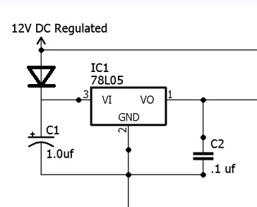

My thought was that the heater doesn't need a regulated voltage. It would be quite happy on half-wave rectified mains, and significant voltage variations won't matter.
I agree that a 78L05 is about as simple as it gets. Zeners are often worse regulators and often use more power. You have to dissipate a lot of power in the resistor. However they are more robust against short-term overloads or spikes and against reverse polarity.
If you do use an unregulated supply, I would add a diode like this:-
That way C1 is only supporting the temp sensor and the regulator during voltage dips. If you don't do that, the heater will pull the voltage down which means you need a much bigger capacitor, and you risk overheating the capacitor with large ripple currents.

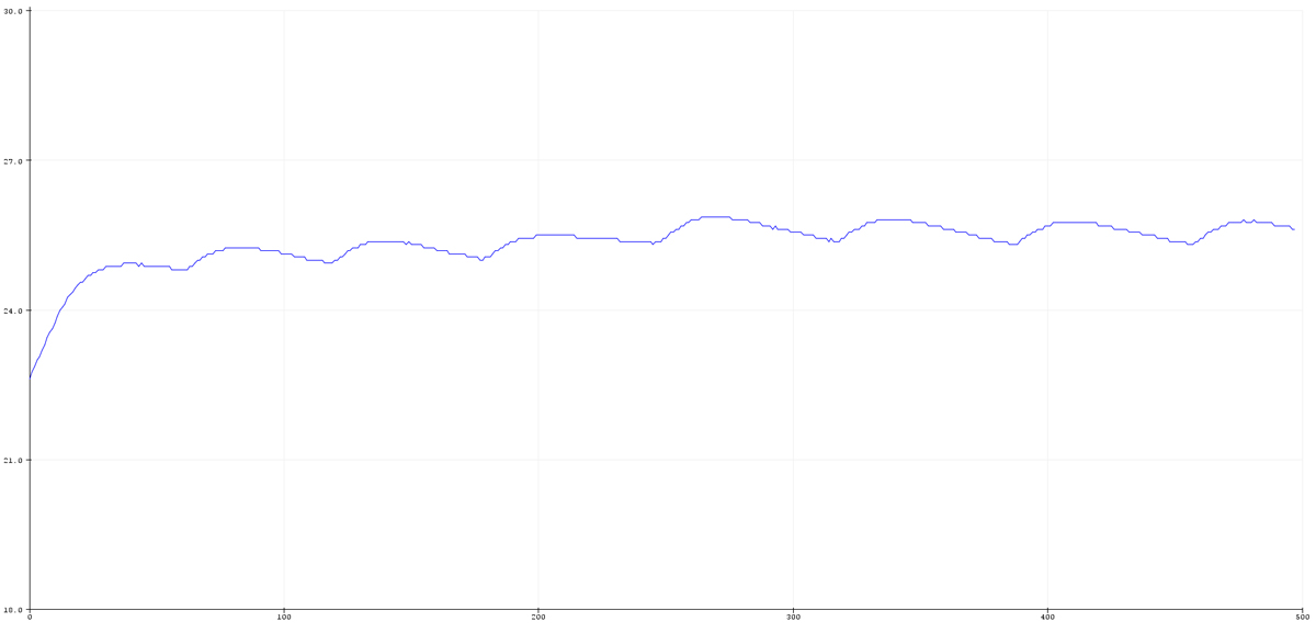

I did some testing this morning. Nothing rigorous for sure. Just slapped the heater in an old food storage container and attached the circuit to the the inside top. I also tossed a DS18B20 in there and measured the temperature over ~80 minutes. The setting was: Thigh=27C and Tlow=25C. Ambient was ~22.5C. I am good with the results below:
The "final" schematic is below (just added the screw terminals):

An impressive result, what happens if you change the limits to be one degree apart I.E set Tlow to 26C.
I don't know how impressive it is - it is what I expected, or at least hoped for, given the small size of the container and how little ventilation was present - I didn't add it in the post, but the ds18b20 is read every 10 seconds. That graph is from the built in serial plotter in the Arduino IDE.
I have put it away and don't want to test that specific scenario, unless it is particularly important to you. I would think that a great deal depends on the characteristics of the heater.
Would it chatter? I suppose it could in the sense that it is going to switch the polarity of the alert pin accordingly whenever the comparison meets the requirement.
As I recall, the data sheet says only something to the effect that Thigh has to be greater than Tlow in order for alerting to work properly. With 12 bit resolution, you could have a .125 degree C difference between Thigh and Tlow. Additionally, you could set the fault number to 1 (I had it at 2) so that one detection at/exceeding a limit triggers the alert. I don't recall a specific clock speed - meaning how long between conversions in free running mode. Conversion time is in there though as I remember specifically that lower resolutions are faster.
