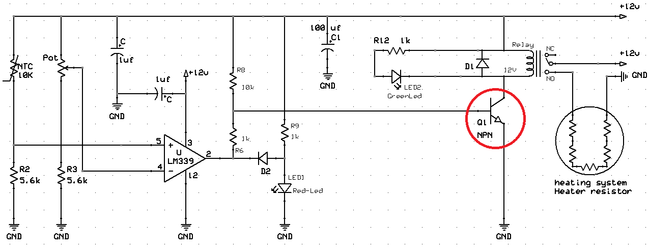

I don't have an electrical or electronics engineering but i know some basics about electronic

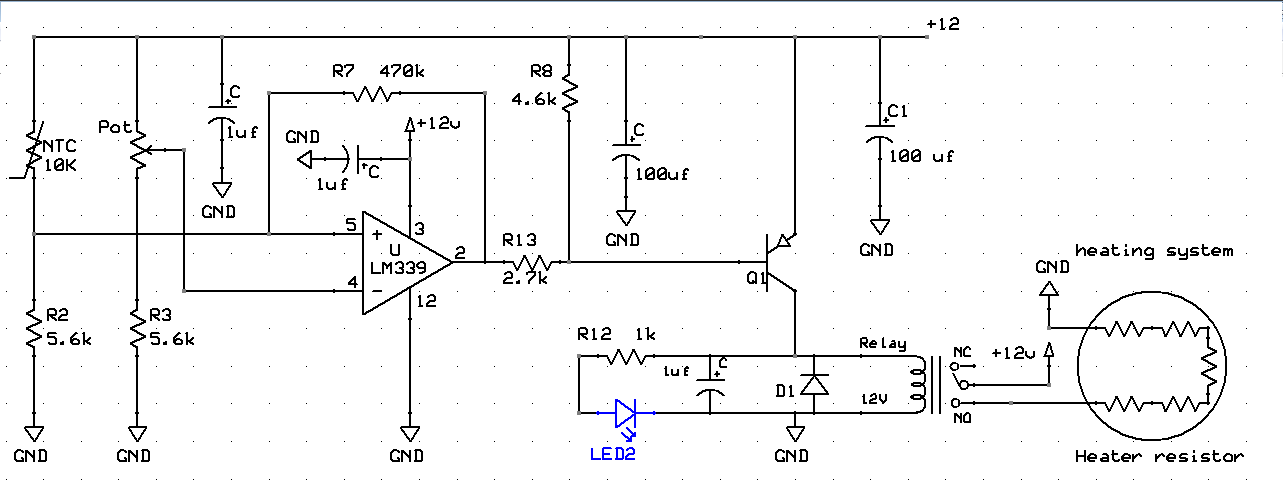

I'm trying to build a thermostat please help
i want to add capacitors on this diagram, can you tell me where and why please

hi, could you tell me why you want to add additional capacitors?
Without more information, I can only suggest that you print out the schematic tape some colorful capacitors to each corner.
The parts in the circle are resistors, are these what you mean?
That sounds a little difficult to respond to because you are literally saying that you want to add something and you are asking how and why.
So, I am looking at the circuit and it looks simple enough for me to understand. You have a comparator with two voltage dividers as inputs. One input is dependent on a thermistor's resistence (i.e., the temperature) and the other is dependent on the setting of a pot. When triggered, the comparator operates a relay that turns on the heating element (the resisters inside the circle. There are also a couple of LEDs
You have three capacitors on the power line.
Others here will know more, but there are only two places that I see: One is at the comparator Vcc to ground (again, you already have three smoothing the power supply. The other is across the relay coil. You have a diode there, which is appropriate but I have seen RC snubbers used as well (search terms - RC Snubber relay noise suppression).
Maybe I am missing something, but that is what I see.
You will get a better response if you provide more information.....where did that schematic come from? Why do you think you need to add capacitors? Homework assignment or what?

i should say : I want to add or remove capacitors on this diagram, can you tell me where and why please !?
like dr pepper said :
The thermostat is for the egg Incubator; a comparator lm339 with two voltage dividers as inputs. One input is dependent on a thermostat’s sensor (thermistance NTC for 37 °C) and the other is dependent on the setting of a pot (reference for 37 °C). When triggered, the comparator operates a relay that turns on the heater resistor
yes it is heater resistor
I don't have an electrical or electronics engineering but i know some basics about electronic, while i am searhing on google i found a lot of schemas , they add two type of capacitors : the polarized and non-polarized capacitor
can i
replace a polarized capacitor with non-polarized capacitor !?
please tell me why you add each capacitor and why and also their values are they correct or no !?

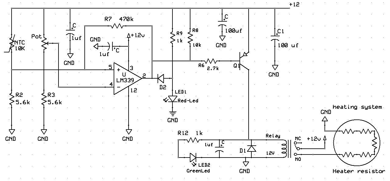

The capacitors on the drawing are all 100uF, and they all connect to the same point, this might seem confusing.
It is however where they are positioned that is important, each capacitor decouples a section of the circuit, and should be placed close to that section of the circuit.
This is because of the pcb tracks & wiring resistance affecting the circuit.
You can replace a electro with a non electro so long as the voltage ratings etc are the same, although for 100uF a non electro would be very large.
And non-existent :D
If we're really been picky on the circuit, it certainly doesn't need four 100uF on the supply - I would suggest a 100uF on the incoming power, and a 1uF across the comparator, and leave the others out. The circuit presumably wasn't designed by anyone who knew what they were doing, and used pointless overkill on the decoupling.

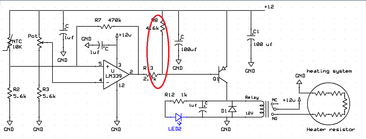

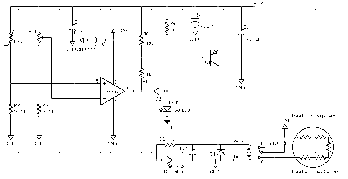

i modfied the diagram ,please see it

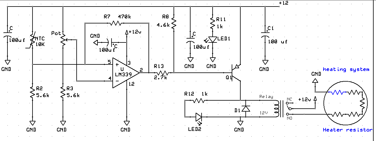

another thing :

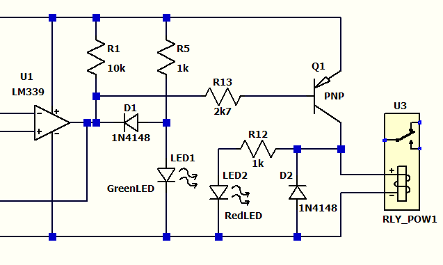

The led2 is on when the heating system is on, I want to add a led 1 to be on when the heating system and the led1 are off. Please how can I do that?
Add the LED1, with a 1k series resistor, between the relay's NC pin and GND.
You could modify the right-hand side of the circuit like this:
Note: I haven't shown the capacitors. The LED colours are arbitrary.
thank you very much , I'm so happy , I had taken a long time searching for this sollution

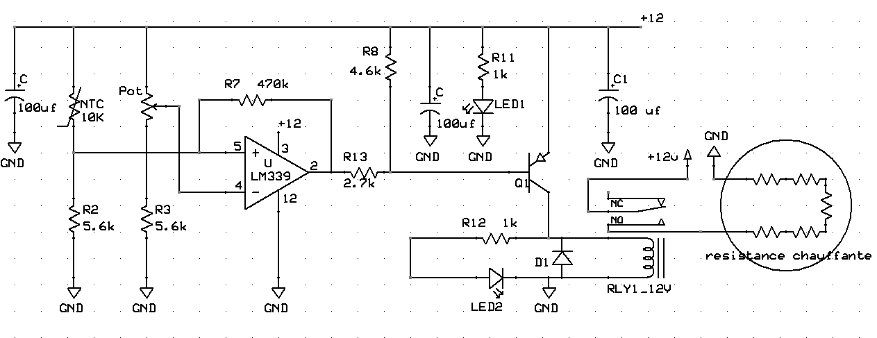

so i modified the diagram as you suggest :

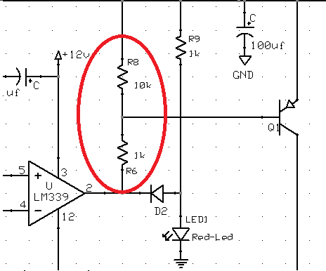

i want to give me your opinion for another thing please :
in my old diagram there was a voltage divider like is shown (red cercle) , i want to keep it if this is possible :
That should work.
Why the voltage divider?

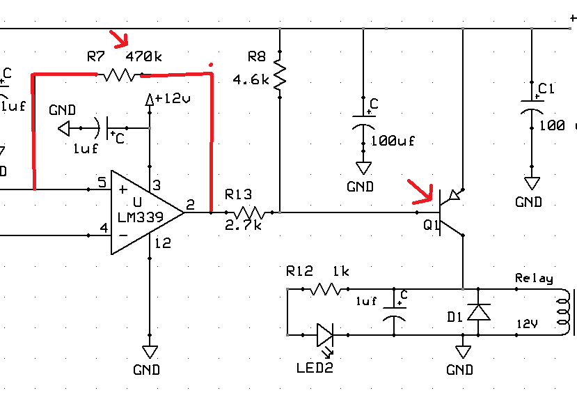

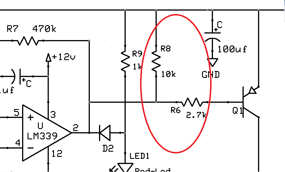

i want to replace the PNP Tr by NPN Tr (red cercle)
i don't know , i think that it would be better with the NPN , also by the voltage divider ,i can have good control for the NPN Tr ! ?
but please i want from you to give me another way to do this :
on my old diagram the hysteresis was done by big resistor (red ligne)
please are there any other method for this (for example a voltage divider ) because i don't like to use a this big resistor

What do you mean "big"? High value resistors are generally very small in physical size (or the same physical size as any other resistor) because very few amps can get through them so very little wattage. I've never heard of anyone being concerned with using high-value resistors when a high value resistor is perfectly suited (needed) for the circuit.
For the above circuit with the NPN transistor:
1) The R8/R6 potential divider will prevent the NPN transistor from switching off. You can replace R6 by a short-circuit.
2) Depending on how much current your relay coil draws, R8=10k is probably too high a value. I'd suggest no more than 2.7k.
3) Without hysteresis the relay will probably 'chatter'.
4) Going from a PNP to an NPN means the switching logic is reversed. To compensate, you can connect the heating element to the relay's NC contact instead of the NO contact.
The 'big' resistor is the same physical size as the other resistors. What is your objection to its use? This is the usual and simplest way to provide hysteresis.
