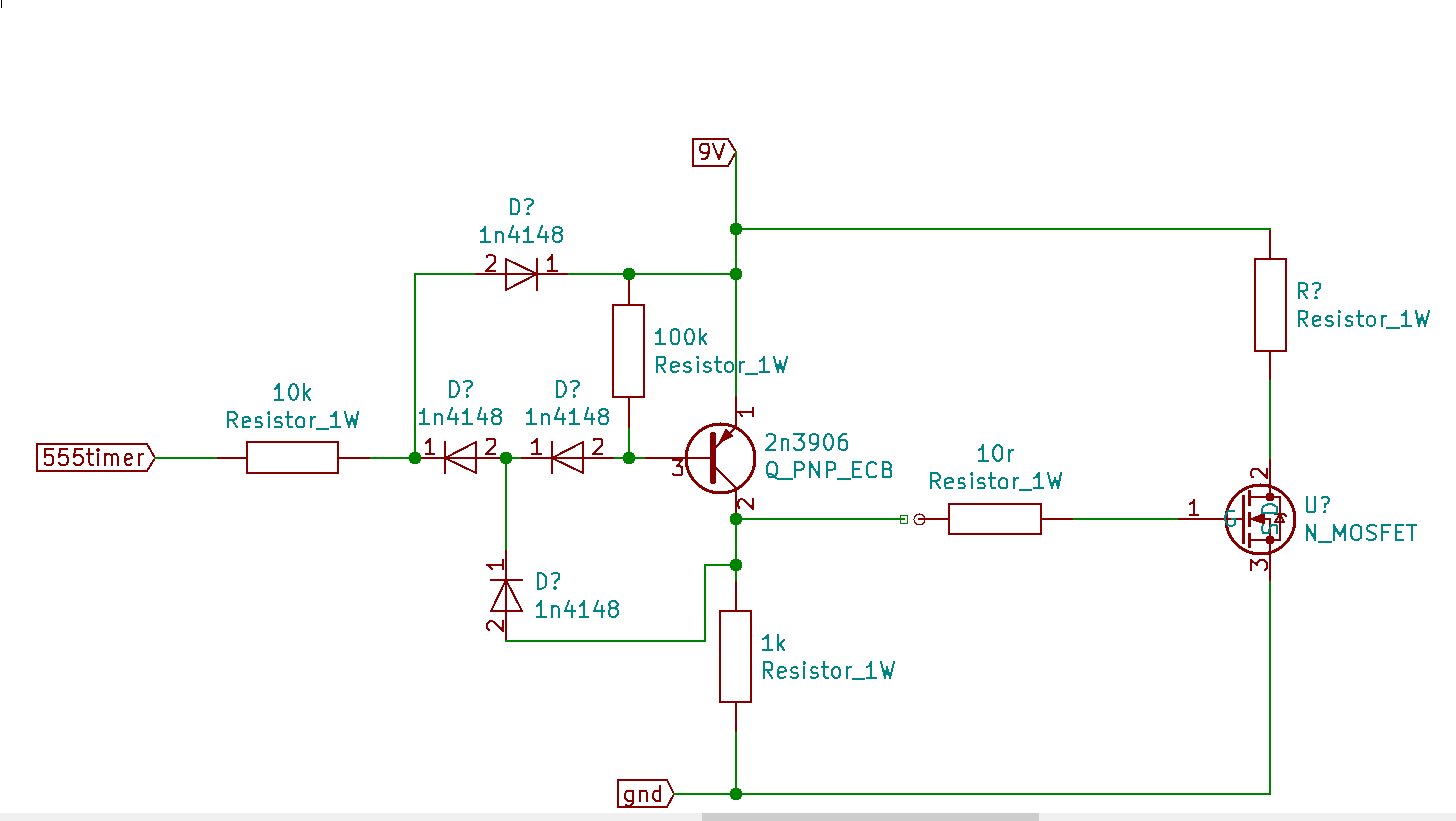

Hello,
I would like to ask how can i get rid of saturation. PNP transistor is turning off slowly. I want to invert logic level of timer 555 to have regulation from 0-50% duty cycle and control mosfet.

This is my circuitry:
Several things to look at.

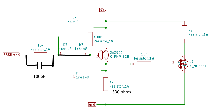

1) remove the diodes and start over. Put a small capacitor across the base resistor. I don't know the actual value but you want the base to go up to 10 to 13 volts when "555timer" rises.
2) There are large capacitors inside the MOSFET. 1k is not enough current to turn off the transistor. Play with reducing the 1k to 330 or some thing.
This circuit will drive the Gate on/off. It makes the "1k" a transistor and will pull down much harder. Also it will keep the little transistors out of saturation.

My circuitry at the moment only contain base resistor 10k with pararrel cap "102". 100k resisitor on BE. 220R resistor at collector to ground.
Works flawlessly.

What are all the diodes for?. And what is the supply voltage for the 555?, is it the same 9V rail?.

Diodes? Dont know. Created from some schematic on internet when googling for "pnp baker clamp".

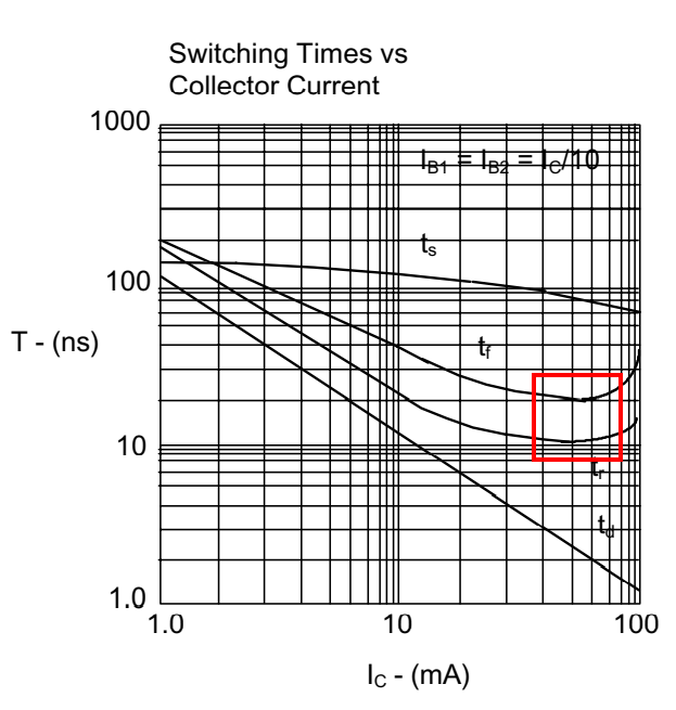

2N3906: Under conditions different than you are using but..... switching time (not delay time) is best at 50mA of collector current.

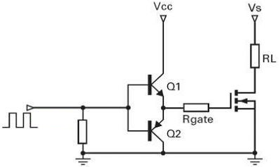

This is some thing I typically do. Inverts! Pull down is active not 1k or 220 ohms. Will pull down hard. It also pulls up hard.

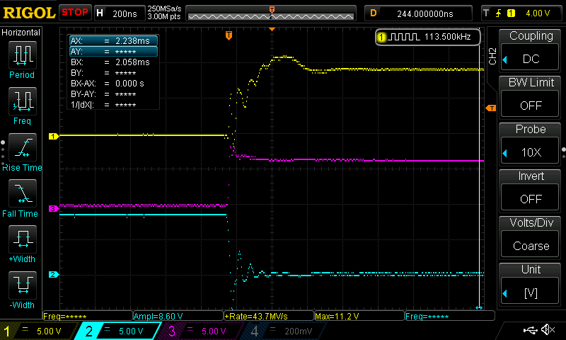

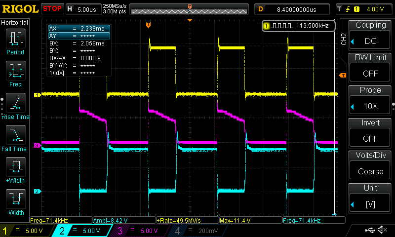

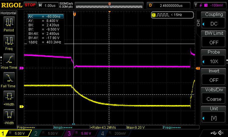

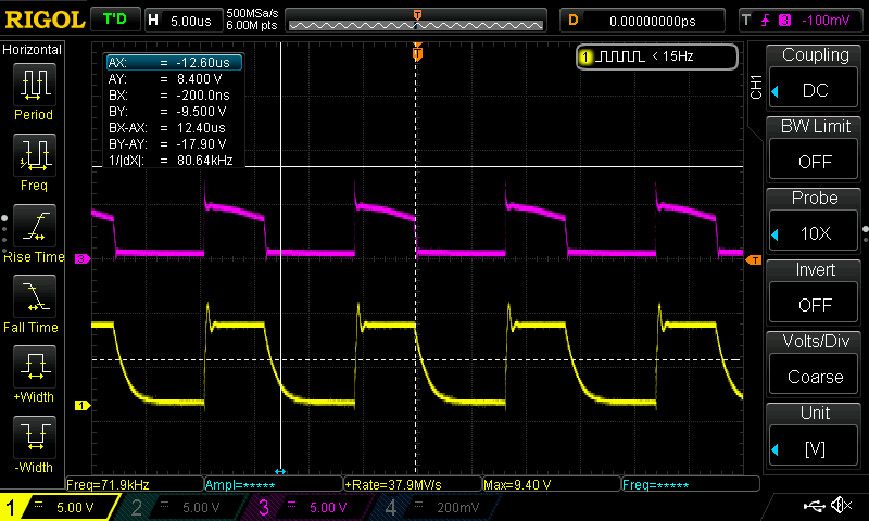

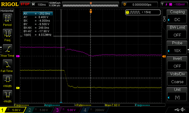

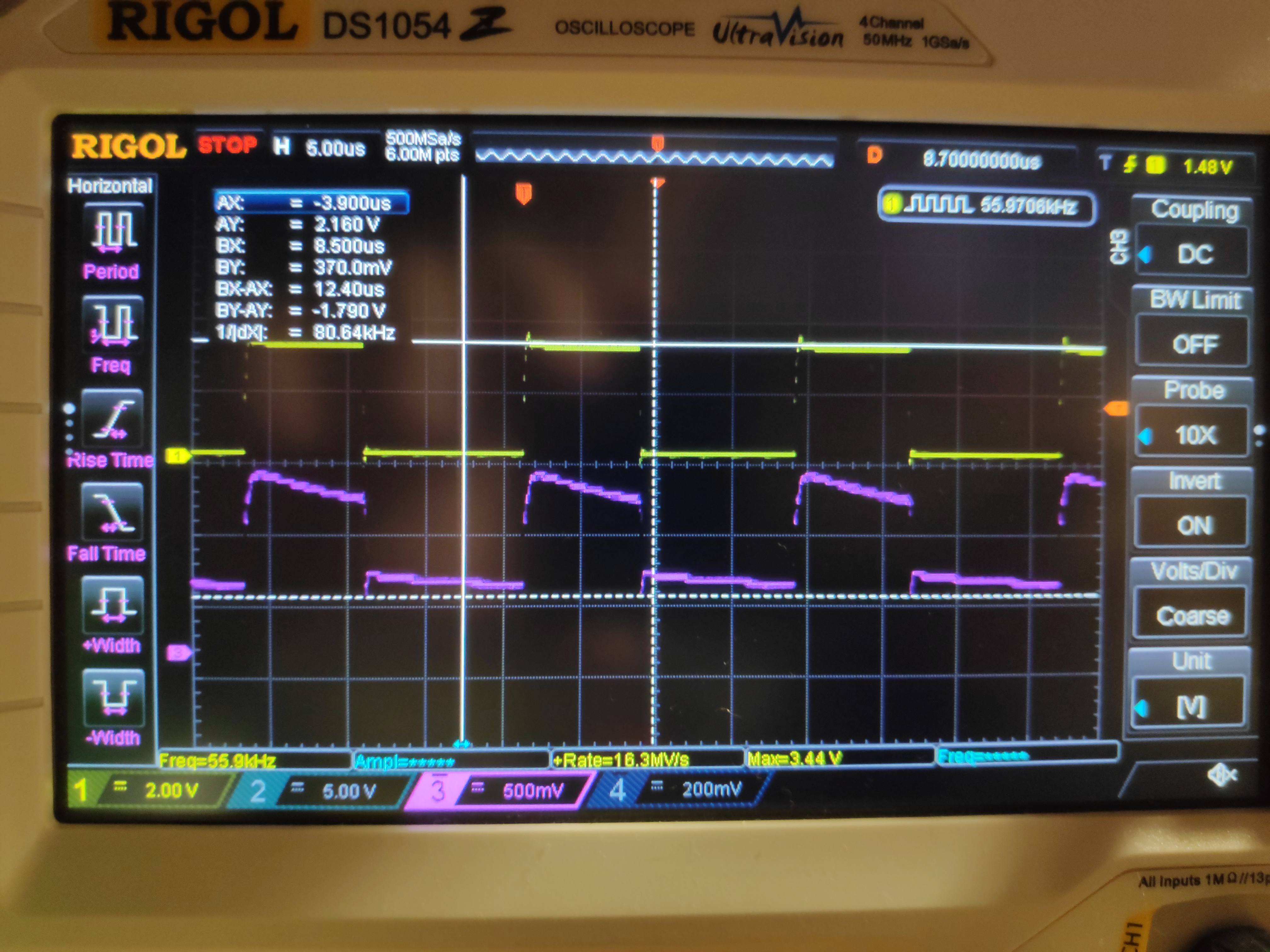

Here are some measurements on oscilloscope.
Yellow are variant with 2n3906 100k, 220r, parralel cap with 10k base res.
purple is yours invertot with 2 npn transistors. Its software inverted to positive level.
quickprint 17/18 is without mosfet attached
19/20 mosfet is attached
Any sugestion to improve?

The B-E resistor=100k, change to 10k or even down to 1k, but not less. With 100k the Base might have 0.5V B-E. Not good. The Base speed up cap should have pushed the Base above the 9V supply for a short time.

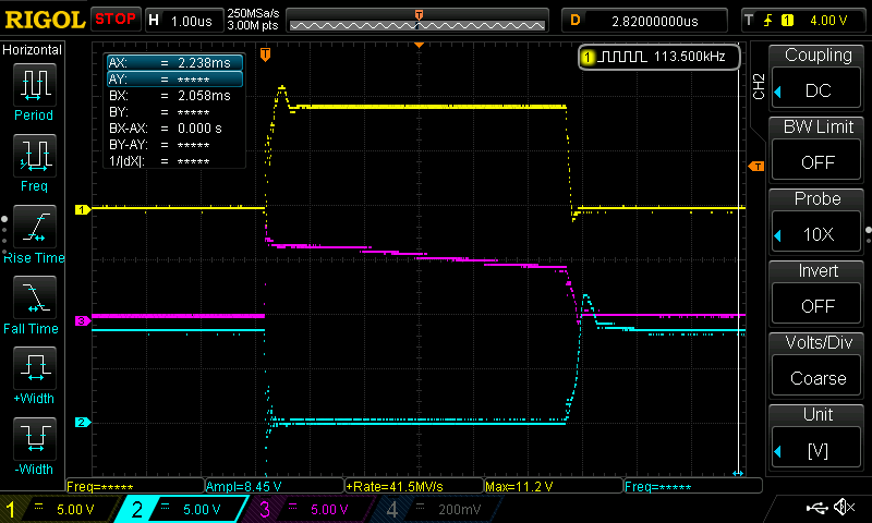

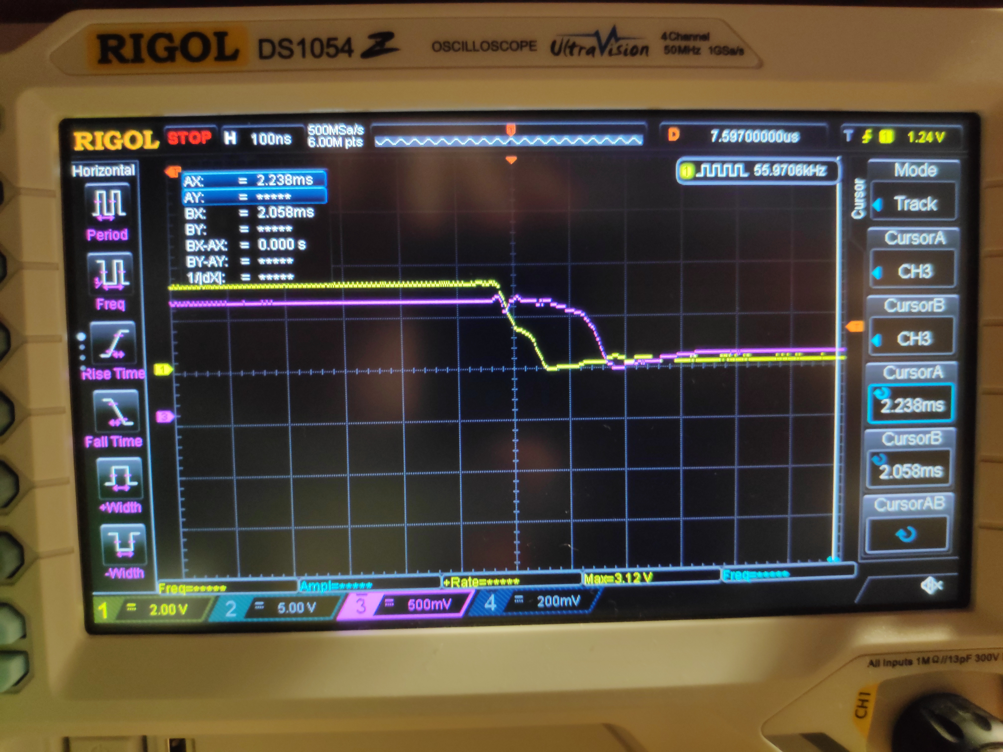

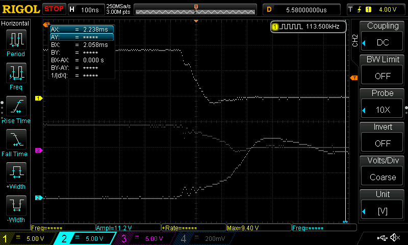

U just turn off computer so i just take a photo. Its with aditional diode and pnp close to mosfet

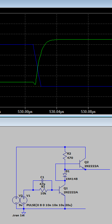

looks like more diodes than necessary for a Baker clamp. [this description] might explain better how a baker clamp is supposed to work.

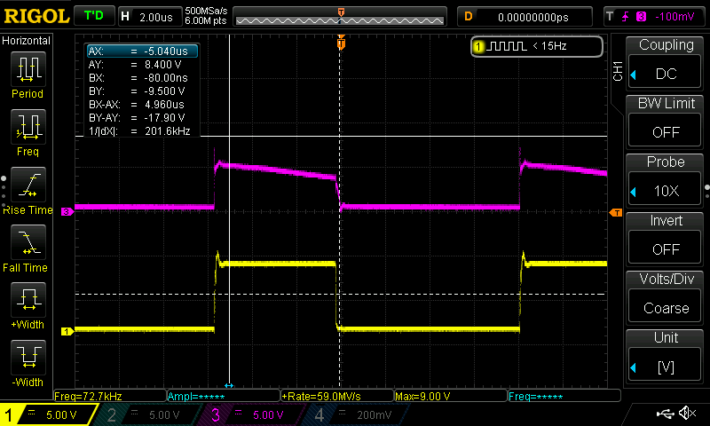

Please show the output of the 555. Is the rise and fall time about 100nS?

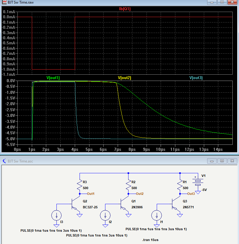

You might try a fast switching transistor such as the 2N5771.
It has a much shorter saturaturation turn-off delay as compared to most general-purpose BJTs.
It's main limitation is the 15V max collector-emitter voltage rating.
LTspice switching comparison simulation below:
Notice that the 2N5771 has a very small delay (<100ns), compared to the 3us of the other two transistors.
Yellow are variant with 2n3906 100k, 220r, parralel cap with 10k base res with aditional diode and pnp close to mosfet.
purple is yours inverter with 2 npn transistors. Its software inverted to positive level.
blue is 555 timer
