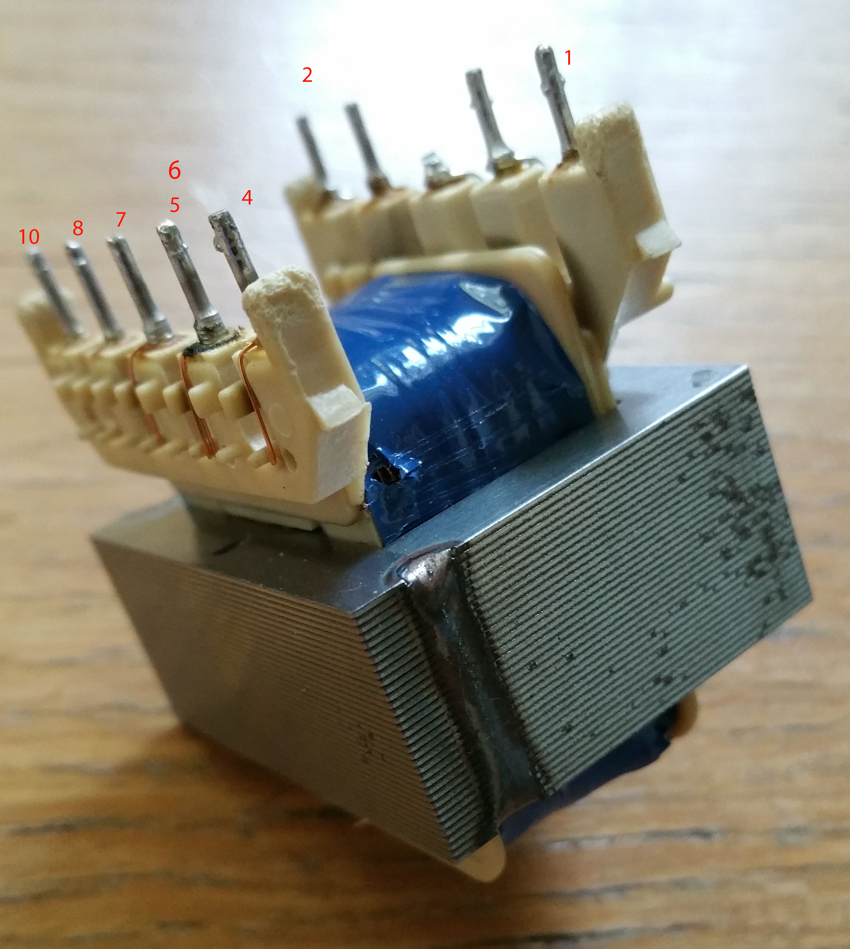

The attached photo shows how I have been numbering them.
What I wrote earlier.............is not the same numbering system so I will try again
ON THE BOARD ITSELF on the secondary terminals with the transformer removed:
Terminals 1 & 4...........reads 40 on the x10k setting. This is 4 and 8 in the photo (albeit on the transformer)
Terminals 3 & 5...........reads 30 on the x1 setting. This is 7 and 10 in the photo (albeit on the transformer)
In black ink above I was just counting the terminal 1, 2, 3, 4 , 5 as they appear on the secondary side.
Hope this is clearer, otherwise I will try again.
Note that on the board..............4 and 5.............and 8 and 10 ..........are both open circuit
John

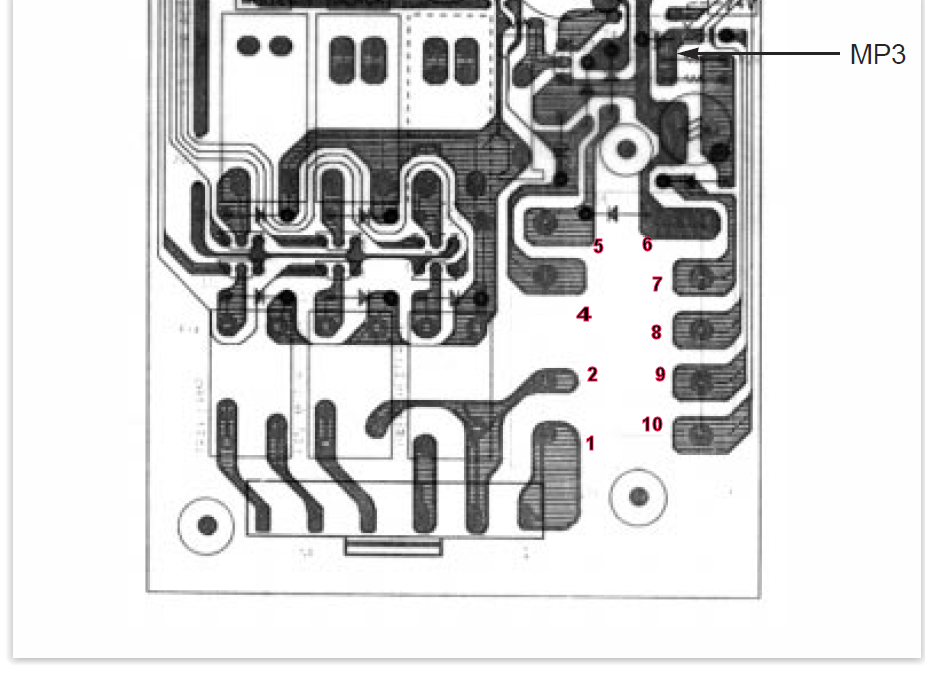

Hi John,
I think your numbering of the transformer pins is wrong.
This picture is from the manual. I am assuming it is from the etch side. (Pictures of the board from both sides would be useful.)
From your picture of the transformer.
starting from top row left hand end.
Correct number 1 your number 2
Correct number 2 your number blank
Correct number (Would be pin 3 but cut off as it is not used.
Correct number 4 your number blank
Correct number 5 your number 1
Continuing from bottom row right
Correct number 6 your number 4
Correct number 7 your number 5
Correct number 8 your number 7
Correct number 9 your number 8
Correct number 10 your number 10
We need to know the resistance reading between points 8 and 10 on the board to see if the filament on the display is OK. This will give us a better feeling as to the filaments on the hiFi.
Les.

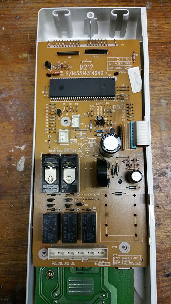

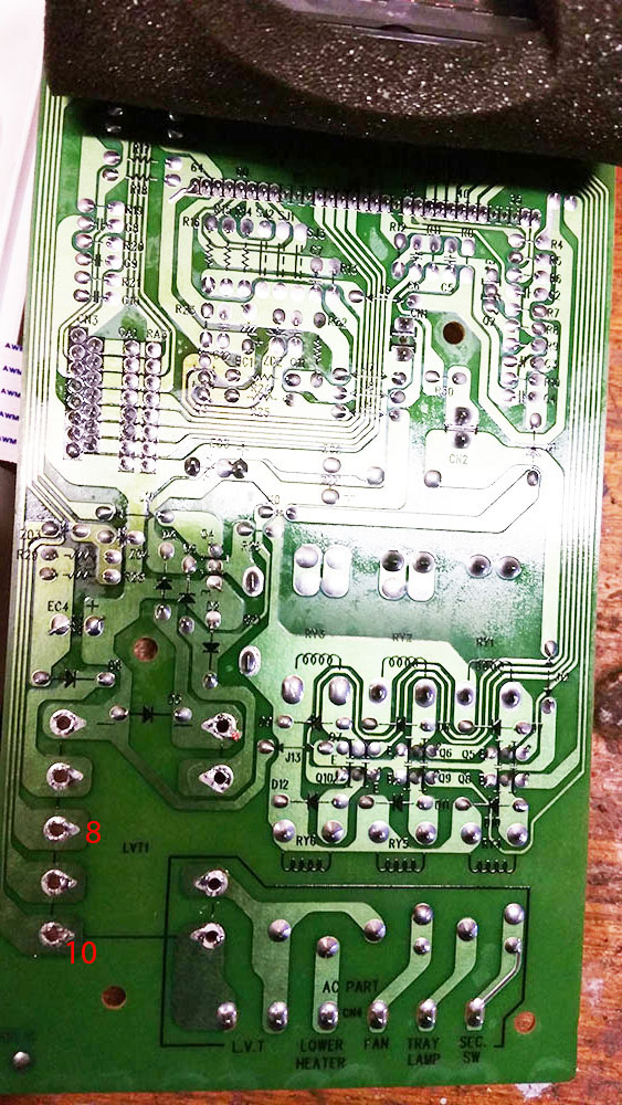

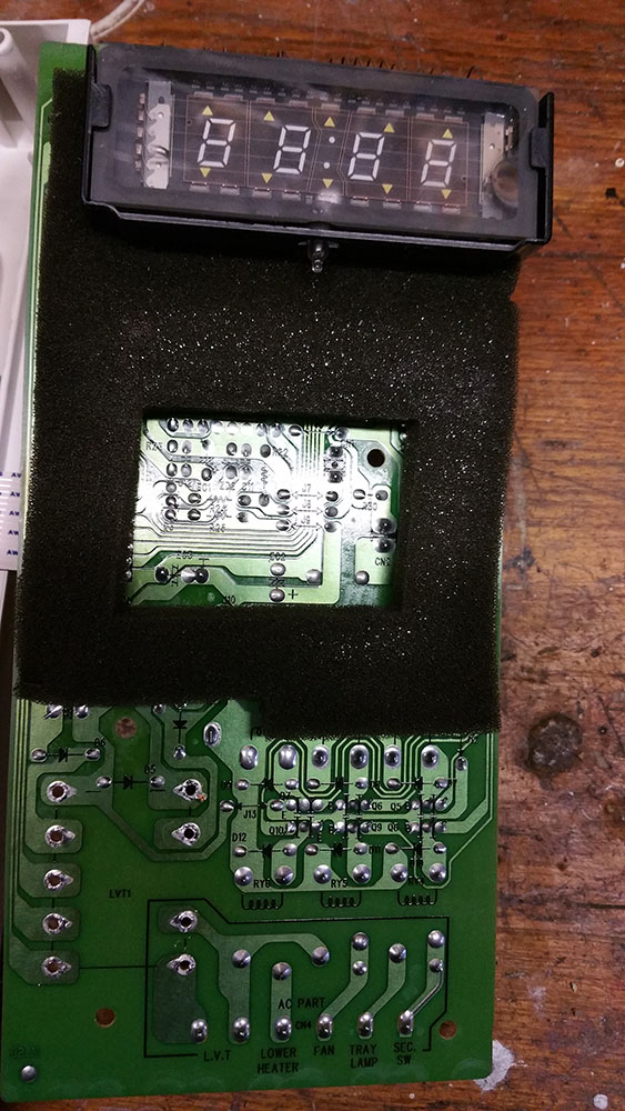

Please see attached. By the way I put all photos that I take in the original "onedrive" link : **broken link removed**
should you wish to review all the photos in the same place........(and do the same for the Pioneer HIFI).
If you require other photos (or a better photo), I will take more.
The resistance is 30 ohms between points 8 and 10.
Thank you again,
John
Photos are in the link, but I will attach them here as well

Hi John,
Thank sfor the very clear pictures of the board. The good news is that 30 ohms seems about right for the resistance of the filaments in the display so I think it will be OK. I suggest getting the microwave working first then looking further into the HiFi problem. I had a thought about the freezer. I think you are having trouble getting the higher rating varistors suggested by spec. As an alternative you could connect a number of the original type in parallel. Sorry you had bad weather for your weekend away. Did you go far away from home ?
