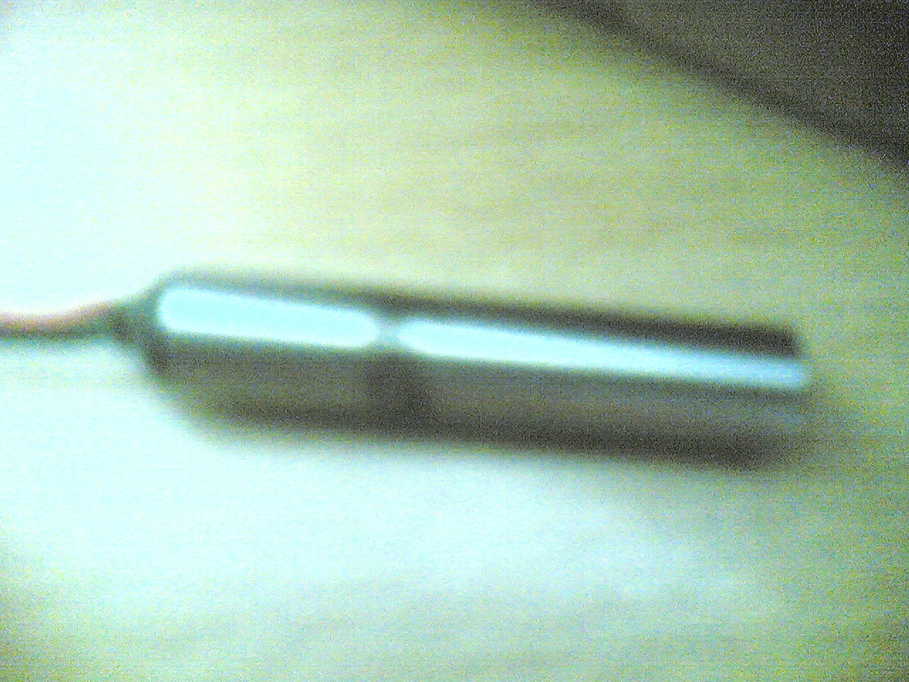

I just bought this so called metal detector, it has three wires coming out, red, green, black. I tried some testing with battery and a multimeter. No effect of any metal on any voltage. It also attracts iron.. Some guesses about what it is..

Are there any numbers or identifying marks on it?
A photo which is in focus would help!

Seems to work fine detecting ferrous metals (magnet/iron)... Do you have any data/source for this device? I don't think its a complete metal detector, bit unusal for wand like at the airport or courthouse. The picture isn't very clear, so its a mystery. Any manufactuer markings or numbers?
It might be a sensing coil, which requires an oscillator circuit. Metal alters the inductance of the coil and thus the output frequency shifts. Simplest type of metal detector around.
-First, try to measure the resistance between the wires, this could be a good helpfull for anyone in the forum to help you.. could help us guessing the internal components.. (winding?, ICs?, etc...)
-recalling the basic idea of metal detectors, there is somekind of a transformer and the metal to be detected act as the core of the transformer.. however i don't know how can this be applied given there is only 3 wires in the output...
-Maybe it needs amplification, maybe the signal is changing of some milivolts is the presence of metals... and op-amp would do the job, and would allow you to adjust range/sensitivity ... (i guess)
Thanx people for all your comments. I tried getting a better pic, will post it wen possible. It has TS-Yx7684 very faintly marked on it.
Resistances are...Red to black is 26.5k, red to green is 4.2k and greeen to black is 30.6k...
I searched on google for that but no use. Any more ideas?? How do i go about testing it further??
My best guess is that is something that can be described as a Proximity Sensor.
Look here
for similar sorts of things.
As for the one you have, my best guess is that if you power* it, +ve to Red, -ve to Black, then measure the voltage between black and green while you move a piece of steel near to the end of the sensor. You will see the voltage switch between 0 and the power volts.
*Start at 5volts, if that doesn't work, try 12volts, if that doesn't work try 24volts.
Ya i tried that but voltage between green and black was the voltage i gave to red. I am confused. The site you told is in German, not sure, and shows some error when I try to see the English version.
I'm pretty sure oznog has it right. I have something similar burried in my driveway. The reason for the 2 coils is to distinguish between in-coming and out-going vehicles. You will have to guess/exoperiment at the resonant frequencies.
