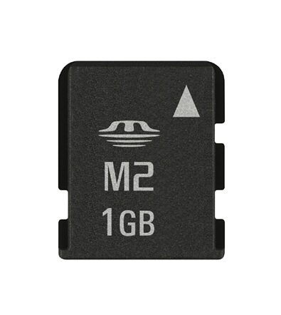

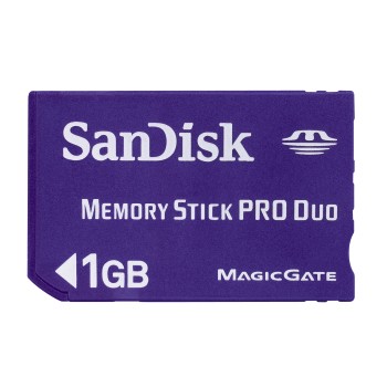

Memory Stick is a removable flash memory card format, launched by Sony in October 1998, and is also used in general to describe the whole family of Memory Sticks. In addition to the original Memory Stick, this family includes the Memory Stick PRO, a revision that allows greater maximum storage capacity and faster file transfer speeds; Memory Stick Duo, a small-form-factor version of the Memory Stick (including the PRO Duo); and the even smaller Memory Stick Micro (M2). In December 2006 Sony added the Memory Stick PRO-HG, a high speed variant of the PRO to be used in high definition still and video cameras. Memory_Stick_Micro.jpg00056155abb.jpg

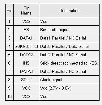

Pinout
Pin Signal Direction Description
1 VSS
2 BS IN Bus State. Indicates the Bus State (0-3) on the SDIO and the timing to start signal transfer.
3 DATA1 IN/OUT Data
4 SDIO/DATA0 IN/OUT Serial Data In-Out / Data. Transfer direction and types of data change depending on the Bus State.
5 DATA2 IN/OUT Data
6 INS OUT
7 DATA3 IN/OUT Data
8 SCLK IN Serial CLocK. A host product outputs signals on BS and SDIO af failing edge and inputs (latches) at rising edge. SCLK is always output during BS1-BS3.
9 VCC
10 VSS
