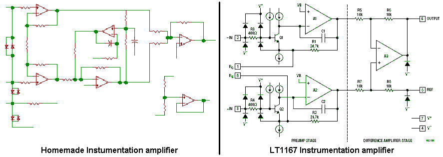

Okay, so the nearest instrumentation amplifier is the LT1167, if I want to construct my little ECG machine (using Jason Nguyen's example - he has made one too but with a few opamps together).
Is one instrumentation amplifier represents the whole thing, like **broken link removed**
or must I have to combine it one-by-one? (that means 3 instrumentations amp together)
An instrumentation amp has the opamps and perfectly matched resistors inside.

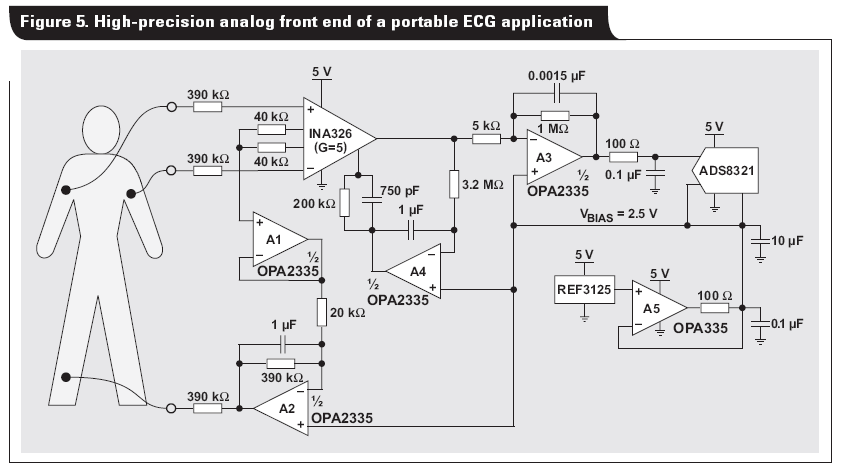

An ECG circuit feeds back to the patient some of its zero signal instead of having a ground.

Jason Nguyen's Homemade ECG
^ Here's the link, and his circuit, he has constructed the whole amplification circuit that is similar to that of an instrumentation amplifier. Can I just substitute the whole 3-opamp area into one LT1167? :)
You can substitute anything you want if you understand the circuit.

Many ECG circuits use an active 0V feed from the output of an opamp to the patient. This also reduces hum pickup.

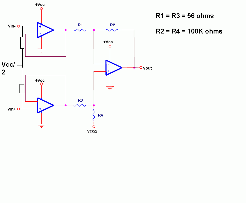

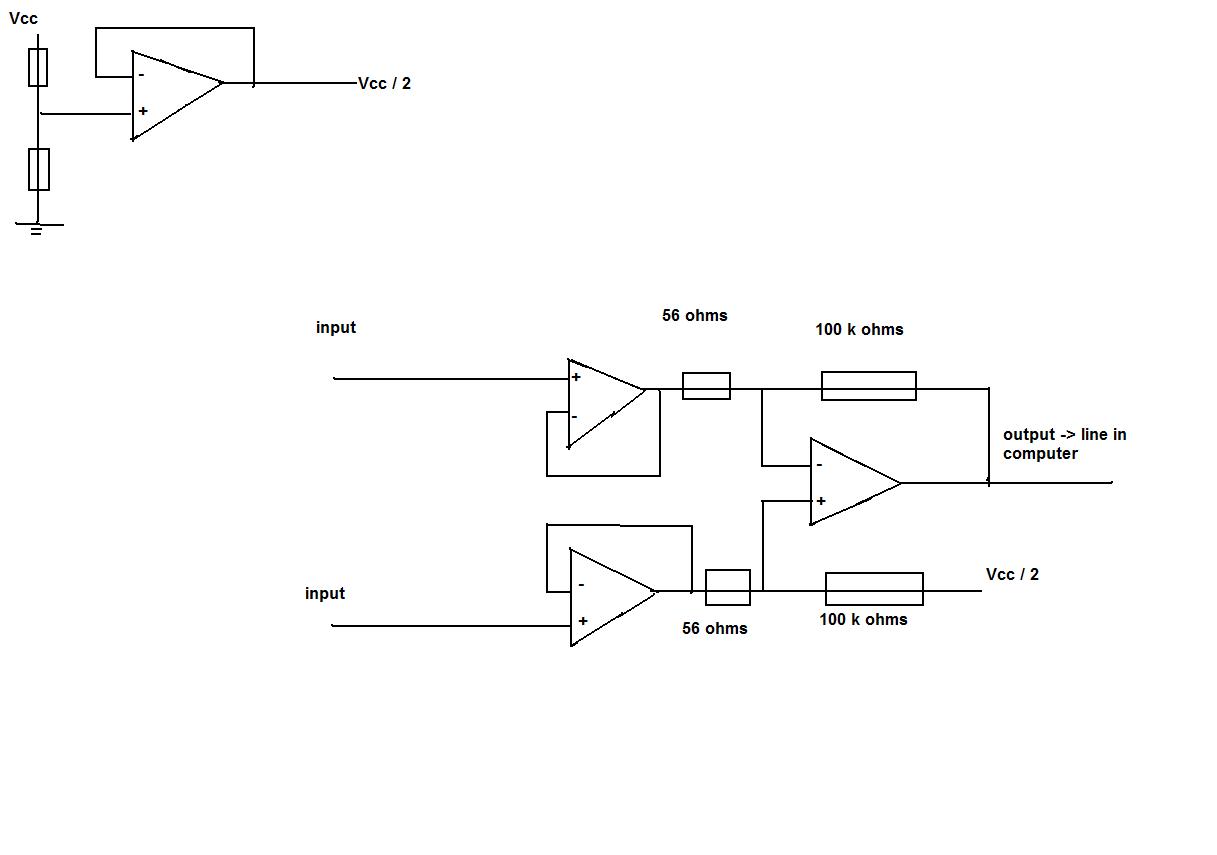

Hey there. I just reconstructed my homebrew instrumentation amplifier, but with using single supply. This time it failed to work. Here's the schematic... what could be wrong in the circuit? Btw, the two inputs are for the left and right arm together. :confused:
You didn't bias the inputs so the input opamps didn't work.
An instrumentation amplifier has resistors that are matched, and has additional resistors so that the input opamps also have gain like this:

audioguru said:
You dodn't bis the inputs so the input opamps didn't work.

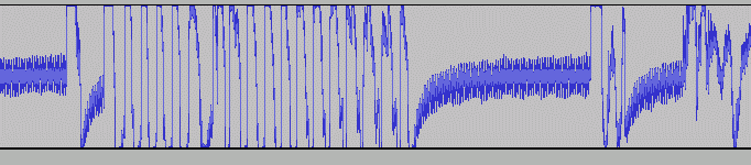

Hey, the thing you suggested amplifies, but there's another problem - I connected both electrodes (right and left arm) and the noise is attentuated, but I still couldn't get any signals. The strange thing is, when I keep touching the tip of the electrodes, the signal jumps and jumps.
I'm pretty sure the homebrew amp is working well, and I only could be missing one last thing! :confused:
What could be the problem?
Here's the attachment - the waveform spikes are caused by the repeatedly touching the tip of the electrodes. The straight line (polluted by noises) are when I connected the electrodes to both arms.
I think Vcc/2 also must be connected to the patient.
The gain of the instrumentation amp must be 500 to 1000.
Attach your schematic with its parts values.

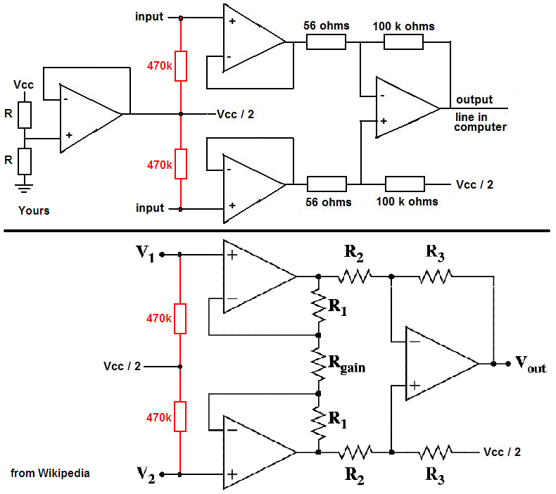

Okay, this is the modified, simplified homebrew instrumentation amp I got from T.I's Single Supply Guide Book and the resistors values are stated already. Yet I couldn't get it working - any testing guides? I read that all of the opamp's output must be equal to the Vcc/2 if I'm not mistaken for the testings.
The gain is around 1785 - is it permissable for this operation? :)
Also, must I ground the output for this battery-powered system?
