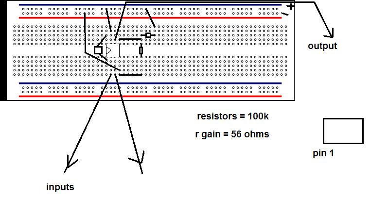

Yeah, I have these conductive greases. Looks like when I rip out the Rgain, that thing still doesn't budge - I suspect the thing isn't amplifying at all, regardless of the presence of the resistor.
Here's my breadboard attachment - I'm sure there are errors inside, but I couldn't find any so far. :)
Your circuit is missing the 100uF capacitor from pin 5 to pin 4. The inputs are not balanced without it and then they pickup and amplify a lot of mains hum.
Also, you don't show a wire called Ref from pin 5 that connects to the patient's leg. Without it then the inputs are not biased.
Measure the output DC voltage again. It should be close to half the supply voltage. What is the supply voltage?
