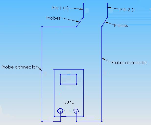

I'm going on the information that was provided for me. Which is:
Where is states that the circuit must be BROKEN.
This is what I done.

You said that you took the LED wires off the motherboard then placed the meter's probes on the output.
But to measure current you are supposed to connect the meter in series between the current source and the load which is the LED. Then the meter is just a piece of wire and the LED lights with almost its normal amount of current.

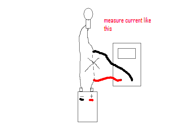

If I read this right, it sounds like you shorted the output with your meter. In current mode, a meter has very very low resistance (like in the milli ohms). You are supposed to break the circuit and insert the meter, but while the load is still attached...
lol He removed the led all together. You are supposed to break one side of the circuit, then put the meter in series with it, not break both sides of the circuit and put the meter in parallel. You must measure current in series with a load.
