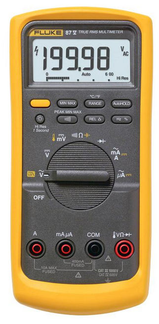

I wanted to measure the current draw.
Connected the FLUKE 87V leads to COM and mA uA in series with the battery (12V 8Ah ) and the lamp as shown.
An unexpected event occurred.

I would suggest you might have a problem with your meter if the LEDs are working normally.

I agree with Pommie; some Fluke meters default to AC current and you have to switch to DC with a button.
Exactly this - my work Fluke 179 defaults to AC current and needs the yellow button pressing before I get to DC. It catches me out almost every time despite me using it every day for the last seven years ....
My Fluke 87 defaults to DC and for AC requires a button press.

Are you sure, it looks like my 179 where AC is the default ? View attachment 137936
Never owned a Fluke, never used a Fluke, but is it possible that models intended for electricians default to AC (as that's mostly what they use), and models intended for Electronics use default to DC (as that's mostly what is used).
It would make obvious sense, and make them more user friendly.
Yep, about as sure as I can be. On an interesting note I noticed the symbols for mA A in the image are yellow as is the button below the display. Mine are Blue. Ahh, I got it. Meter I looked at was my older Fluke 87 no suffix. My Fluke 87 III is the same. However, here is the twist, my newer Fluke 87 V is exactly like your image and guess what it comes up AC for default.
Over all the years I never noticed this difference, go figure? I do have one old 87 III that just flashes the display when turned on. Tried a few tricks / fixes I saw online but no joy.
