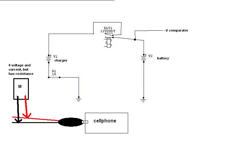

i've tried to cut my cellphone charger's output jack and plug it to my cellphone to measure its voltage, but the multimeter doesn't display its voltage, but it displays battery's resistance.

It won't connect to the battery, it probably connects to the input of the charging circuitry.
...and the charging circuitry is not connected to the battery?
this is one of the main problems on our project (auto-shut off cellphone charger)
the comparator should sense a voltage across the cellphone, but unfortunately we've not expected this problem.

Of course it is, but that's no help to you.

Certainly with NiCd and NiMh the battery voltage FALLS when it's over charged, you have to detect this drop, so a comparator isn't any help.
You need to research specific charging requirements for your particular battery chemistry - Lithium Ion is common in modern phones, and has difficult and dangerous requirements, which is why it's usually built-in.
so is there any hope in our project?
based on the schematic, we can't put the -V of comparator to the +V terminal of cellphone battery because at 'no load condition' (charging voltage is greater than or equal to the Vreference of the comparator, the comparator is OFF) and the comparator will sense a 0V across cellphone which turns ON the comparator and eventualy it will turn OFF again because the comparator will sense the charging voltage which is greater than the Vreference, hence the comparator will ON/OFF at a rapid motion...
if we will tap the -V of comparator to the +V of the charger...
at 'no load condition' again the comparator is OFF, and we can't charge the cellphone because the there is no connection between the +V of the battery and the +V of the charger.
If we set the circuit to be in charging condition at no load... the battery voltage should exceed the Vreference of the comparator in able to turn it off...

MAX1551
MAX1736
For me Comparator idea is not a good for battery charges.Because its a very basic level technic.Battery Manufactures they won't suddenly stop their charging when it reaches to its cutoff mark.They will look (sense) over & over again the voltage drop happening during charging period.
Thats why I still on research on building my own Li-ION battery charger.
I have an idea to detect the upper voltage limit of the battery periods of time in regular intervals by use of a micro controller.This is the only thing I can do at home.

As an afterthought, you could try investigating the current drawn by the phone from the charger during the charge cycle, and use that as the basis for switching the charger off.
A cell phone already has a charger circuit in it.
Take the battery out of the cell phone then charge it with your own charger circuit.
If the battery is a Lithium cell:
1) Limit the charging current to what the battery manufacturer recommends. 2) Use your comparator to stop the charging when the battery voltage reaches 4.2V or whatever the manufacturer recommends.
3) Use the temperature sensor in the battery as a backup to stop the charging if the battery gets too hot because your comparator might have failed.

this project is to be designed to avoid overcharging of cellphone batteries. this is just a design project for out electronics design course, in fact, tommorrow is our initial defense of our prototype( all we can present is the multiple charging system of the cellphone charger)
is this the same as the voltage comparator? at no load condition, the charger must be off.. if there's a load, the charger is on, and if the battery is fully charged, the charger is off, basically, no load and full battery condition is the same ( but how can we achieve this condition?)

The cell phone already has a charger circuit in it. Adding another charger circuit won't work.
so there's no other way but to change our auto-shut off feature for the cellphone charger... how about an alarm system? the charger alarms when the battery is already full (but i think at no load condition, the charger will alarm, unless theres a load) any good suggestions for our project?
Lithium powered cell phones dont overcharge the battery( unless the charging circuit is damaged) if they did you would have a fire any time the battery was overcharged ( it was allready mentioned that overcharging them ,even a small amount, will cause a fire).
All of the cell phones I have seen in the last 5 years have the charger circuit in the phone and that circiut limits the charge. The power supply that plugs into the phone is just an unregulated supply.
