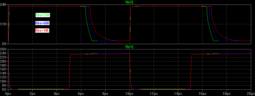

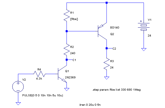

The value of the base-emitter resistance affects the turn-off time of the transistor. See below.
It's of VERY little concern though, if it was of concern you would make better arrangements than that so it turned off much faster still.
I was taking issue with those who said that Rbe is unnecessary, or at least irrelevant. It may or may not be important in this particular circuit.
