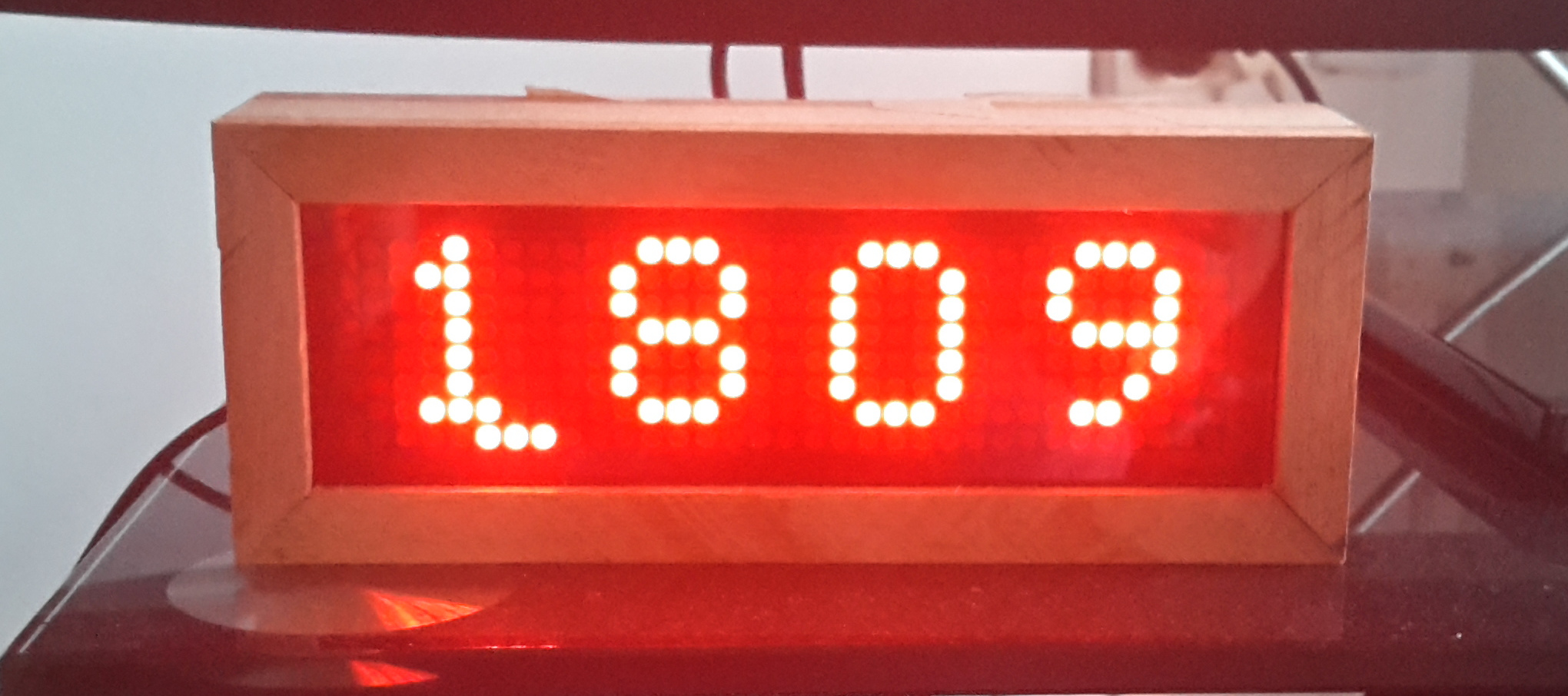

This is my current clock with one 32x8 display.
The 3 dots on the bottom line are the seconds indicator. As the display is 32 pixels wide, it starts at the left as 2 pixels, changes to 3 and then extinguishes the first pixel so it takes 60 seconds to complete the 32 pixel movement.

What about a flashing colon in the middle for seconds? :D

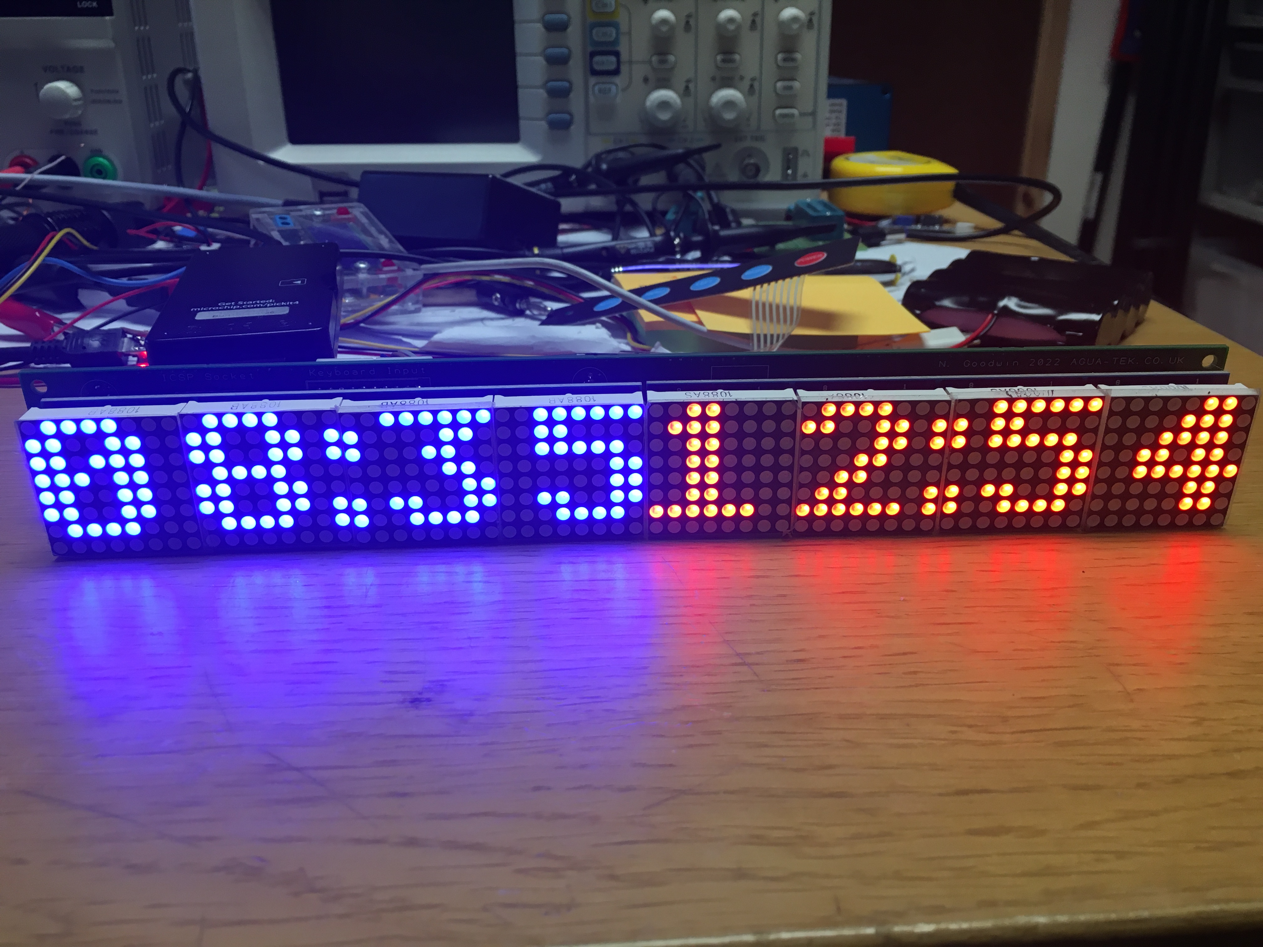

I've been doing a lot of work on the MAX7219 recently, and one experiment was (of course) a clock display.
While there's no space for a colon, it's easy to make space - simply move the first two digits left one column, and the right two digits right by one column - this leaves a perfect gap for a flashing colon. The numeric font is only six pixels wide, so allows space to do this.
You can do the exact same to add a decimal point as well, but in that case you need to make the positions of the digits leave the gap in the correct place.

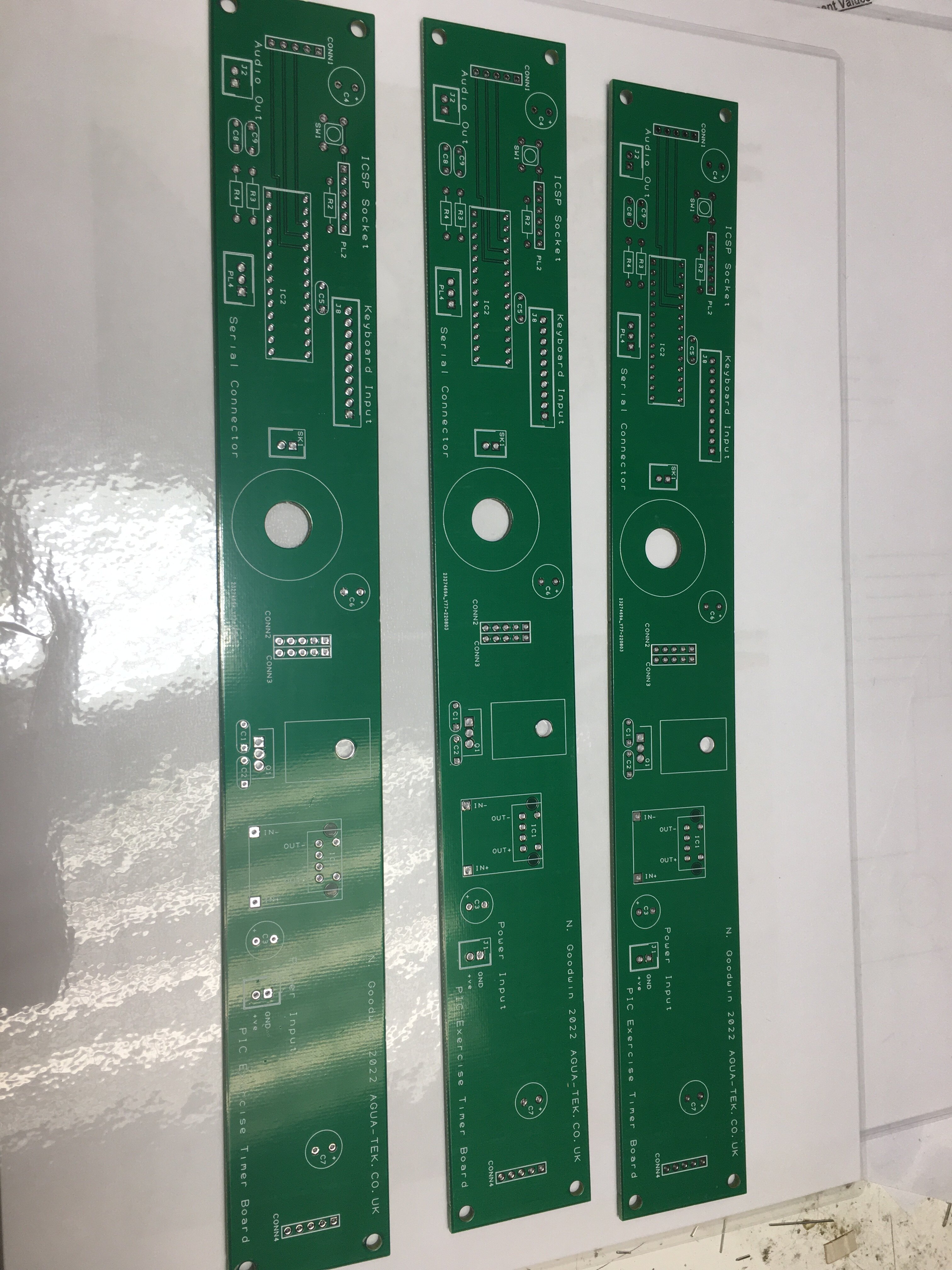

Here are my experimental boards, as can be seen they have space for two 4x8 displays side by side - so far I've got a rather nice 'gym timer' project running on one. The mysterious hole in the middle, is for a piezo sounder, which is hot melt glued to the board.
If you look the digits are 5 pixels wide so leaving 3 pixels between digits where the colon happily sits, just happened to be off when the picture was taken.
However, I really like your double pixel font, does give it a very chunky feel.
Right, so you've space for a colon - mine wasn't a 'real' clock, I just threw a bit of code together to demonstrate the character spacing. However, I have had a clock running, with the colon flashing - using a half second interrupt flag to flash the colon, and a one second interrupt flag to update the clock display.

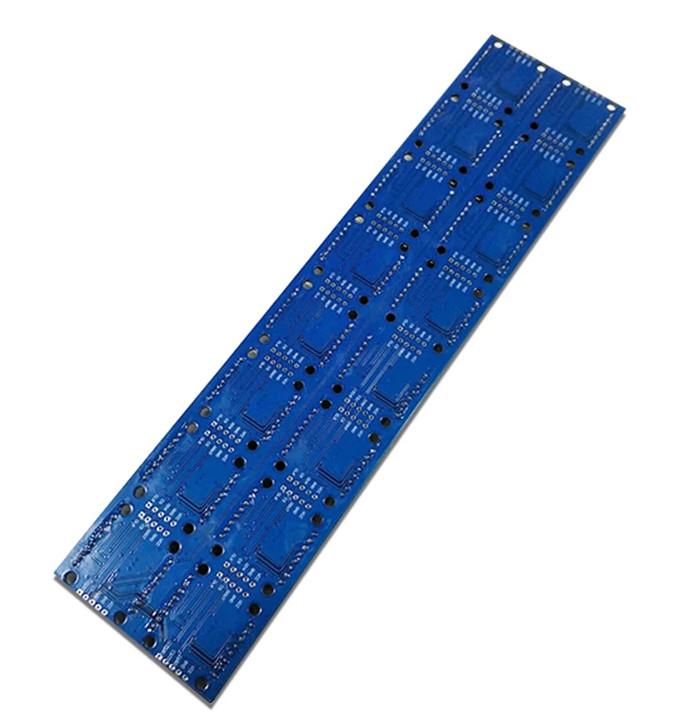

This is a picture of the back of a 64x16 display,
It's not clear from the image but they are all individual 8x8 displays before cutting up so the top line has Dout on the right which needs connecting to Din of the second line on the left.

No, I meant the 32x16 ones (two rows of four modules) - I have a couple of those and the output of the first row links back to the input of the second. They don't tell you which two link together though, but it's trivial to find with a multimeter on low ohms.
On my 32x16 ones the input (as you look from the back) is the top right, and the top left connects down to the bottom right, with the pass through at the bottom left.
Get your meter out and check from Dout to Din on the outside connectors - it'd be strange if they weren't connected?.
