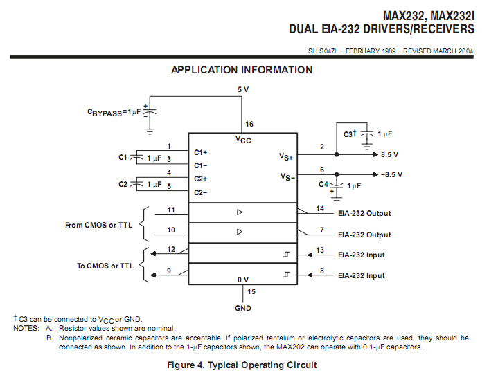

hi guys i have tried to use the search function on the site but for the last few days it dosnt seem to be working. so forgive me for asking but does anyone have a diagram for using a max 232 with a pic, showing the caps etc/

hi J,
This should help.
Eric

hi J,
The way I read the d/s for the MAX231 is that it has no internal charge pump, so it it requires a 7.5 to 12V supply, as well as the 5V.
i am not using a regulator eric (i rarely do) its just a straight 5v feed, i could i spose use a reg and 12v supply, while i go slap myself for careless buying

i thought the RS232 standard allowed +-5v input, if so there is a small chance of the max231's working on 5v. Its worth a try

The MAX231 is for external RS232 voltage references, i.e. no charge pump.

The reason it the image shows 3 caps is because one is a filter cap, and there are 2 main caps on C1 + C2 that make the circuit work.
