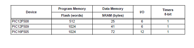

Yeah! scrambling to find where I read it... I definitely know the 8051 does, I thought I read somewhere that because of banking the bit access was restricted to lower bank... But that probably ony happened way back.. I did used to use the old 12f508..
The 12F508 isn't an old chip - it was the 'modern' replacement for the 12C508 :D
As far as I know there's no such restriction?, and nothing I could see in the datasheet on the 16F1827 on a quick look.
I used the 12F208 for a number of projects way back and can confirm there were no restrictions on using the 25 ( :eek:) bytes of memory - however, I was in assembly then.
