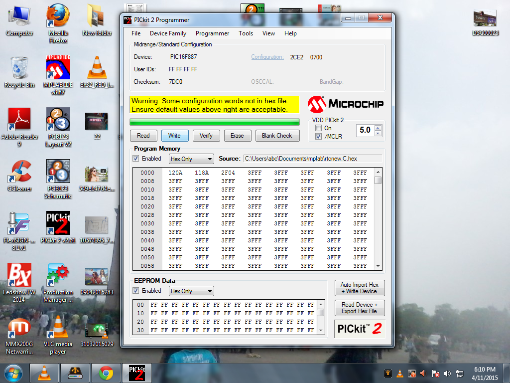

This works well!! Time and display....... your number 2 digit was wrong... I corrected it... Also there was some ReadModifyWrite crap going on so I changed the PORTD writes to suit!!!
The pic kit 2 showing error...
