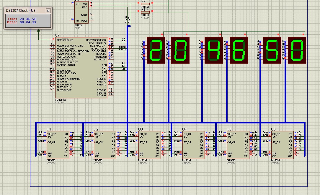

Hello,
Please tell how to make 7 segment clocks using DS1307!
By hardware I2C not by software.
I will be at home in about an hour... I'll put the basics in a file and let you finish it!!
I'll try and remark it as well as I can..
P.S.
How are you driving the seven seg display... Also how many digits???
Okay.... Simple RTC to Display.... I have only used time....

void main(void)
   int idx, SCL;           // loop variables
   unsigned char DIGIT;       // A temporary store for manipulation
   TRISC = 0;             // portc tris bits
   TRISD = 0;             // portd tris bits
   InitI2C();             // prepare the RTC bus
   RC0 = 1;             // MR high
   RC1 = 0;             // OE low
   while(1)
     ReadClock(&Time[0]);               // Get time ( BCD format as
     delayMs(250);                   // we are using  7 seg )
     DISP[5] = Time[2]>>4; DISP[4] = Time[2] & 0xf;   // fill display buffer
     DISP[3] = Time[1]>>4; DISP[2] = Time[1] & 0xf;   // backwards so it's
     DISP[1] = Time[0]>>4; DISP[0] = Time[0] & 0xf;   // readable...
     for(idx = 0;idx < 6;idx++)
       DIGIT = digits[DISP[idx]];         // retrive 7 seg code
       for(SCL = 0; SCL < 8; SCL++)         // 8 clocks
         RD2 = 1;                 // No data ( swap for CC )
         if(DIGIT & 0x80)RD2 = 0;         // Data to send?? ( swap for CC )
         DIGIT<<=1;
         RD0 = 1;                 // data clock
         NOP();
         RD0 = 0;
     RD1 = 1;                     // Latch clock..
     NOP();
     RD1 = 0;
I have used 74ls595 to give visual stability.... See if you can follow the code. NO INTERRUPTS so you should be okay!!!

Hello,
I am using PORTB directly with 120 ohm to 4 seven segment, and common anode to RD0-RD3 via BJT. the circuit is working fine.
I am using array stored and set to PORTB for Driving 7 segments.!
